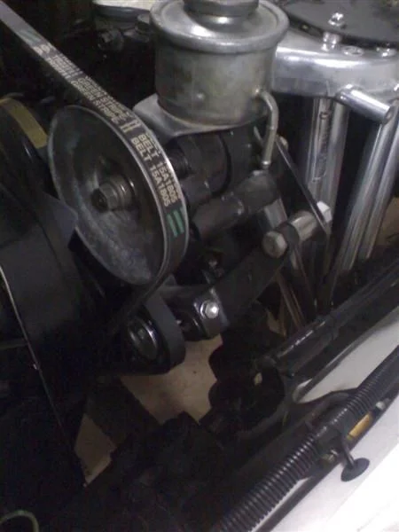

Before I put PS on my '74 F I had one belt that ran in the narrow groove and went around the waterpump and ran the alternator. I use the wide groove belt to power steering pump and it also runs the waterpump. Currently you could just get a new longer belt and run the waterpump and alternator with it. Just lose the airpimp.

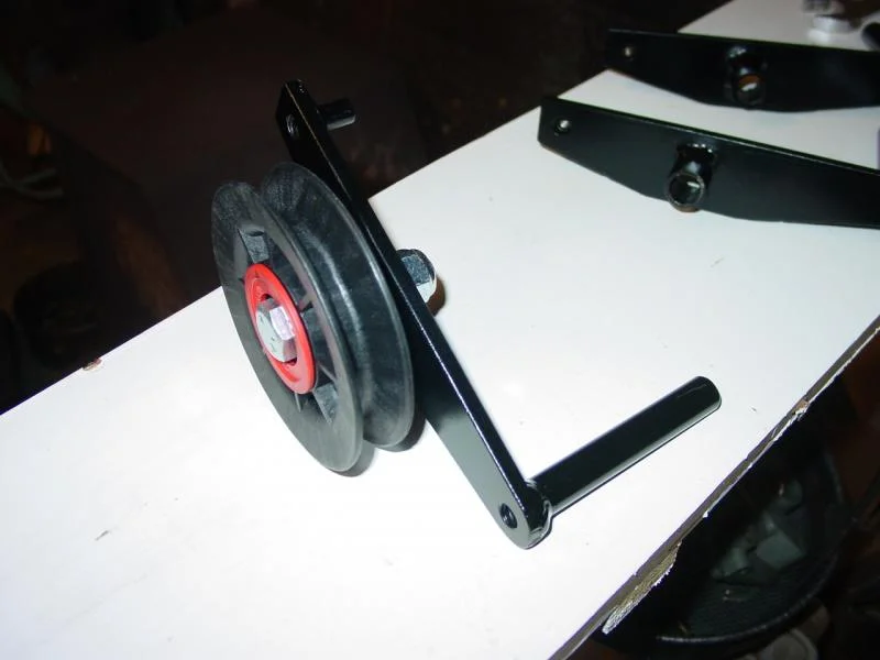

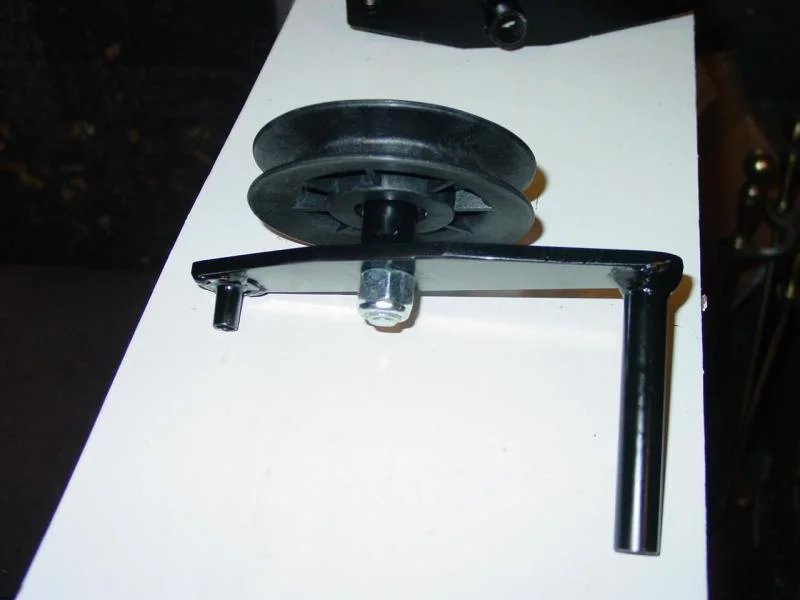

Very nice. Do you recall where you got the pulley?
Looks really nice. Is the pulley hook up just a pulley with a bolt welded on? I'd also like to know the specs on the pulley. Thanks! ty
The pulley was an idler from an FJ62 that I harvested when I grabbed the 3FE bits. Bolt was not welded. The 1/2" bar was drilled and tapped for the OEM pulley bolt. There is a 1/2" spacer behind the pulley.

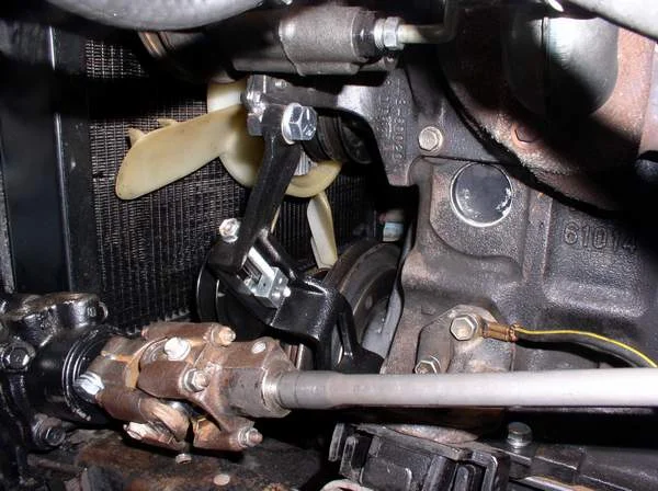

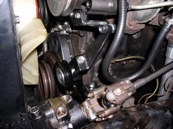

Idler Pulley Using the 3FE part on a 2F
I bought the 3FE part (Grant posted it up somewhere), Toyota P/N 16630-61020 ($61). It aligned with the pulley axis, one of the bolt holes is bolted to the front of the block. A buddy of mine and I fabbed up some brackets (top & bottom).
The brackets are pretty simple, mostly tabs with nuts attached. The bottom one goes in the holes for the standard air pump mount. In the bottom picture you can see one of the bolts holding the bracket to the bolck (below the steering shaft, by the motor mount).
I had to get a shorter belt, but it came out looking really nice. For your viewing pleasure...
I was running a gutted smog pump, but since I spent $61 on the bracket, I wanted to use it.....
