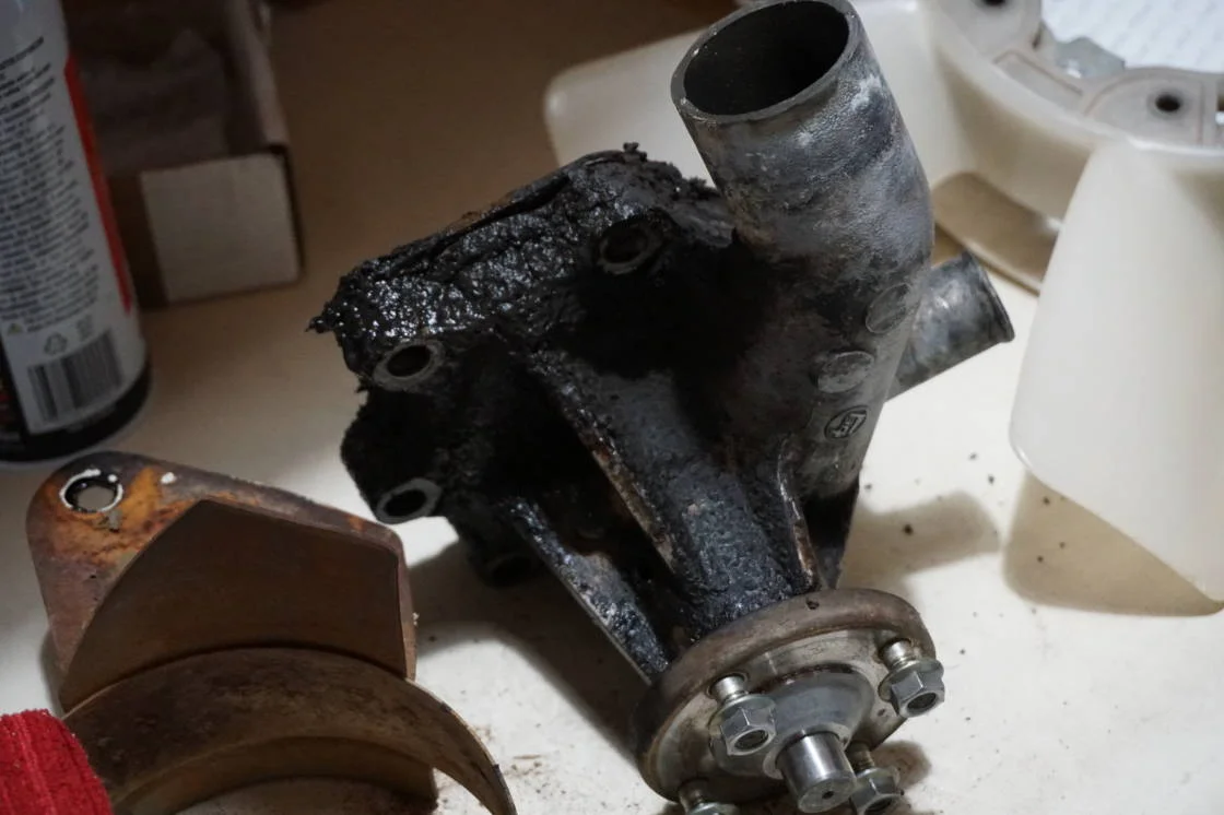

Second pic is the water pump, the original I think:
The shaft is no longer snug, and turns with difficulty - bearing gone bye bye. Third pic was taken after I cleaned out the inside of the pulley:

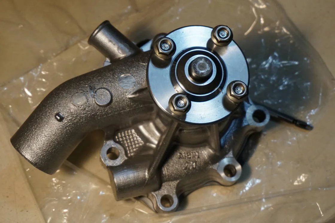

Got this yesterday:

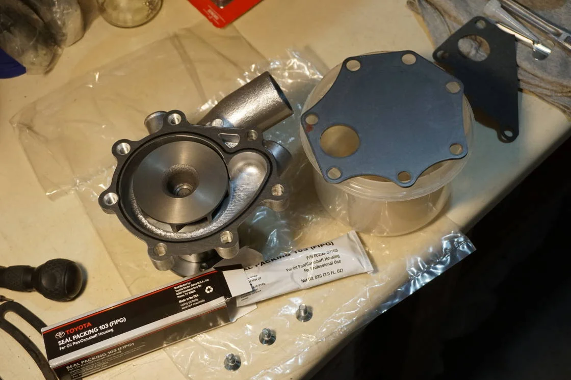

Looks like the right one. First thing imma gonna do is apply a light coat of FIPG to the backside:
So, use that black line as the guideline for the pump side (left) and the plate (right) and install the 3 phillips screws, right?

Is applying the FIPG to the water pump body, both sides of the gasket with the black line, and the backing plate overkill?
