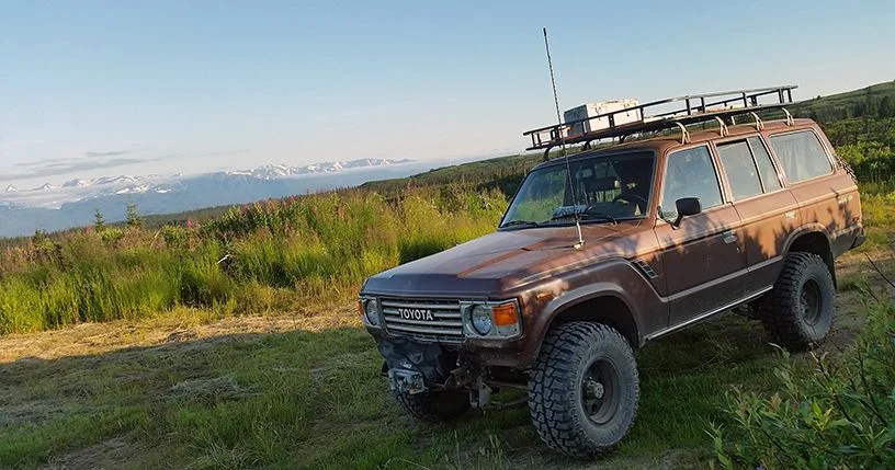

I've owned this truck for 23 years, it's ran me back and forth from Portland, Oregon to Homer, Alaska about 12 times, been my adventure rig on crawls all over Oregon and Alaska and even gone out to the bus (before it was moved) from "Into the Wild" long long ago. I've rescued countless people and vehicles from the caribou hills (I'm Fire/Rescue/EMS) outside of Homer where there are no roads and skidded logs for me every winter. Admittedly I've done less and less maintenance on it over the years as I've had to "pull out ye ol' cruiser" less and less. And it caught up to me on Sunday.
I had the cruiser up on a bit of a hill as I was down below, choking logs and then skidding them up with the winch. The cruiser was purrin' along as it always does and I was working on literally the last log... ...and all of a sudden the truck idles down and stops. Wtf, it never does that. It always runs perfectly. Did I run out of gas? I crawl up the hill, truck still has a little gas, I turn the key, hear the starter try but I get the "nothing budges" sound. Sinking feeling in my gut. I pop the hood, pull the dip stick, there is the slightest bulb of oil (read water tension like) on the end of the dipstick. Try again. Same. I know I killed my beloved my truck. I towed it out of the woods and have it sitting in front of my house now. I damn near cried, just had to walk away for a bit.
I haven't gone out yet and put a breaker bar on it to see if it'll turn. I suppose I will tonight.
Anyone know where to get a short block in Alaska? :frown: :frown: :frown:

By the picture alone, that's a Cruiser Livin' the Life!! Good luck, I'm sure you'll get it running soon.
