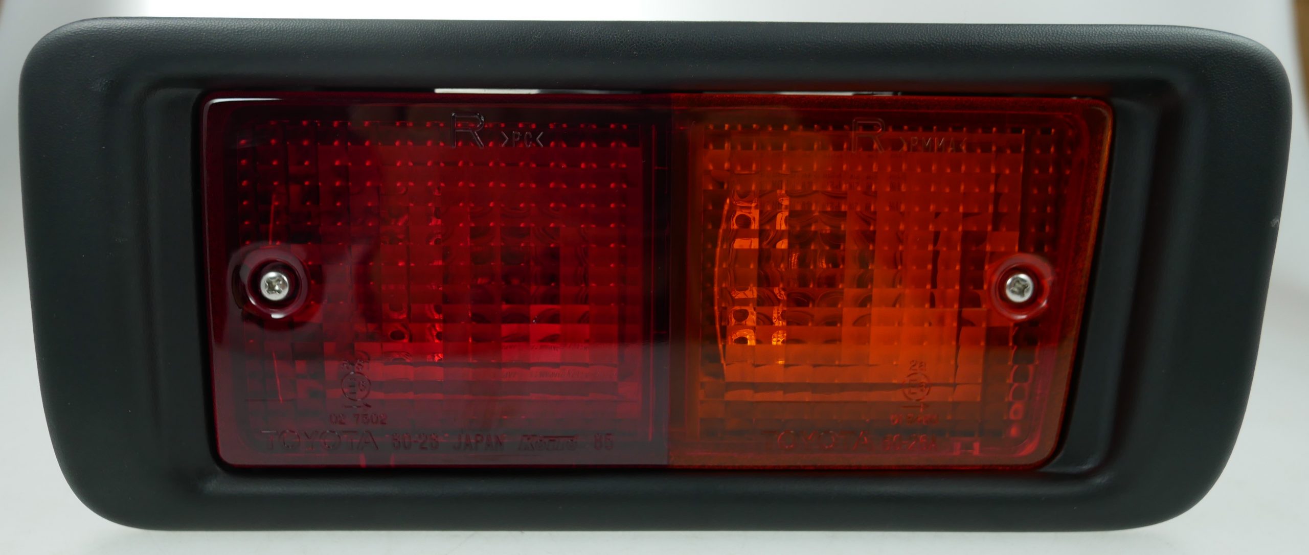

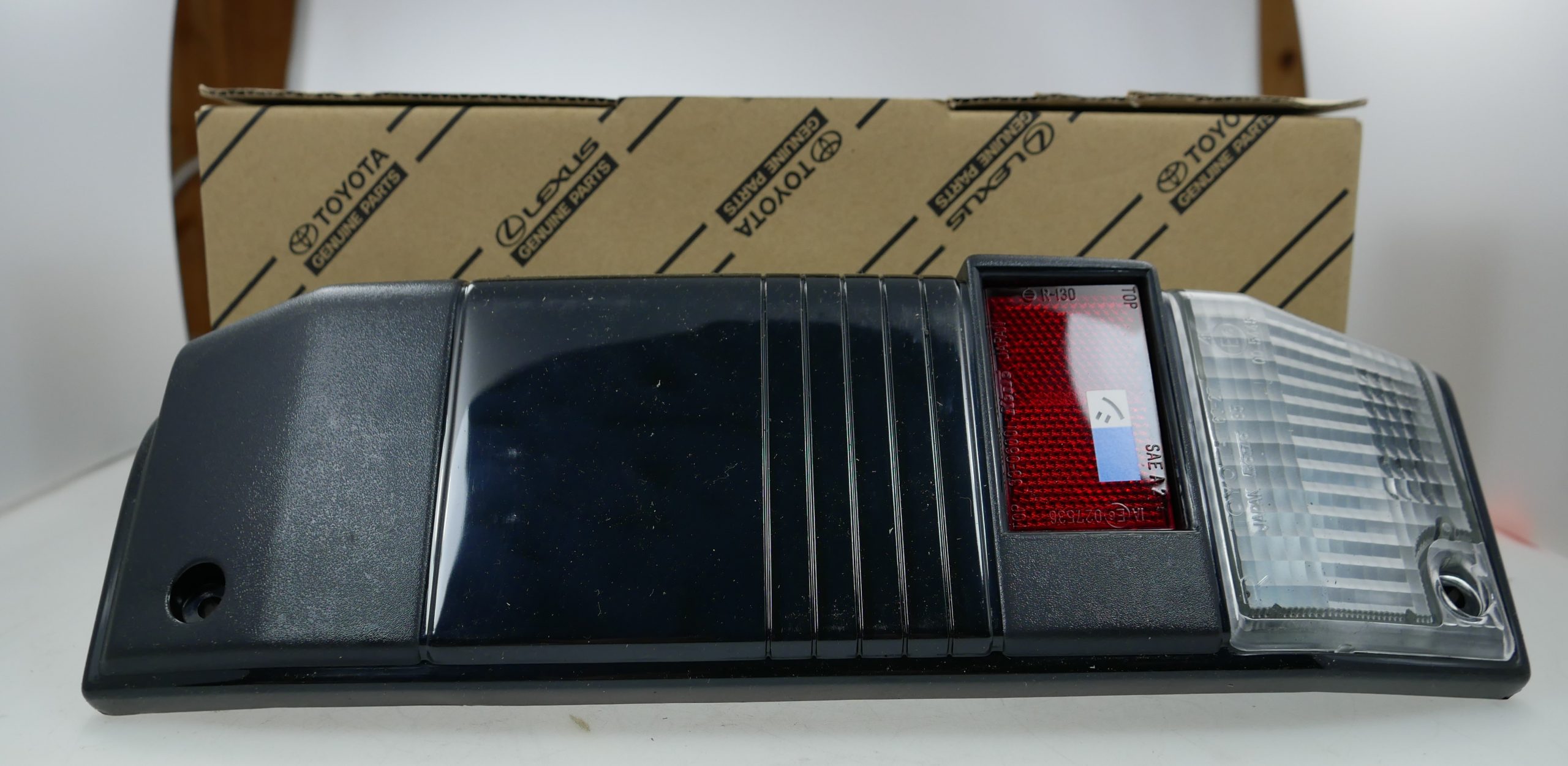

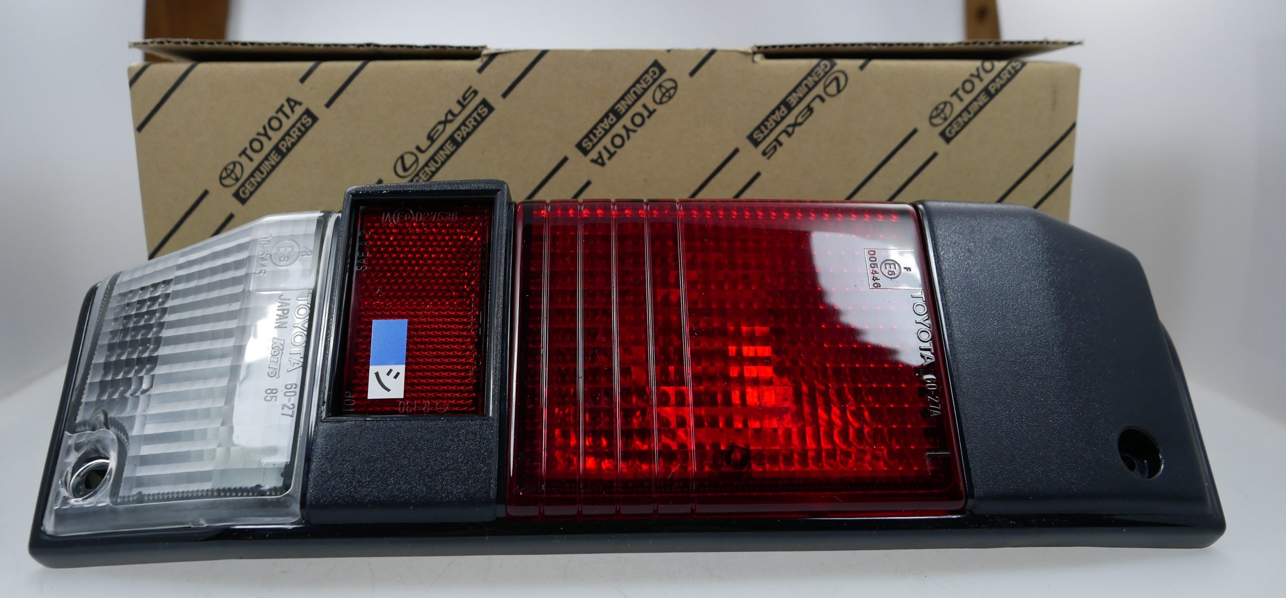

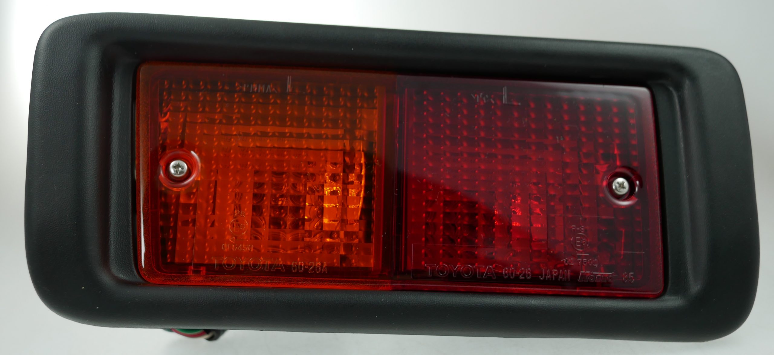

Those blacked out lights don't have any bulb sockets on the RH side except for the back up light at the bottom, the LH side is a fog light and back up light at bottom. They are designed for trucks that have the turn and brake lights in the bumper, so not sure that would help you get the turn signal up higher. I don't have the PN but they are available new from Toyota and still used on trucks with turn signals in the bumper. Here's a German site were you can get them, along with the "bumper" brake and flasher lights- the site also has some other cool widgets:
Oh, it just hit me, those are also available in Aus. so you could get a LH from a euro source and a RH from oz and then put your flasher in the fog light spot.. but you still don't have brake lights in that scenario.
So, maybe not much help, but at least now you know where you can get the blacked out style if that's what you want.
I may still have my old black out style and bumper lights; if you are interested I could dig around for them. No guarantees as I haven't seen them in a long time, but you can have them if I do.
