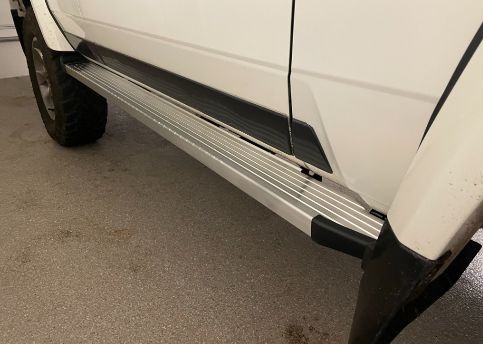

I took on a quick project the other night. Or rather, what I thought would be a quick project. New running boards on both sides.
The running boards are held on by 10 x 6mm bolts. The passenger side came off fantastic. Driver side, not so much. Super rusty. Used heat and penetrant, but half still broke off. Ended up drilling and tapping them. Some of them I needed to upsize and tap to 8mm, which held nicely.

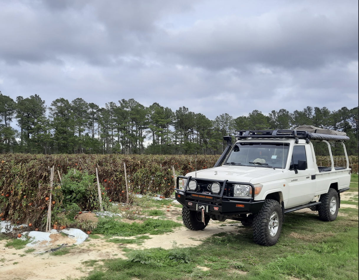

Installed a little something in my ARB. Comeup DV-9 24v. I had my heart set on an 8274, but came across a deal on the Comeup Reviews were great and talking to a few people I decided to go for it. It hides itself well down behind the lights too (no worries about airflow). I have some Customsplice 3/8 rope that will go on it this weekend.
