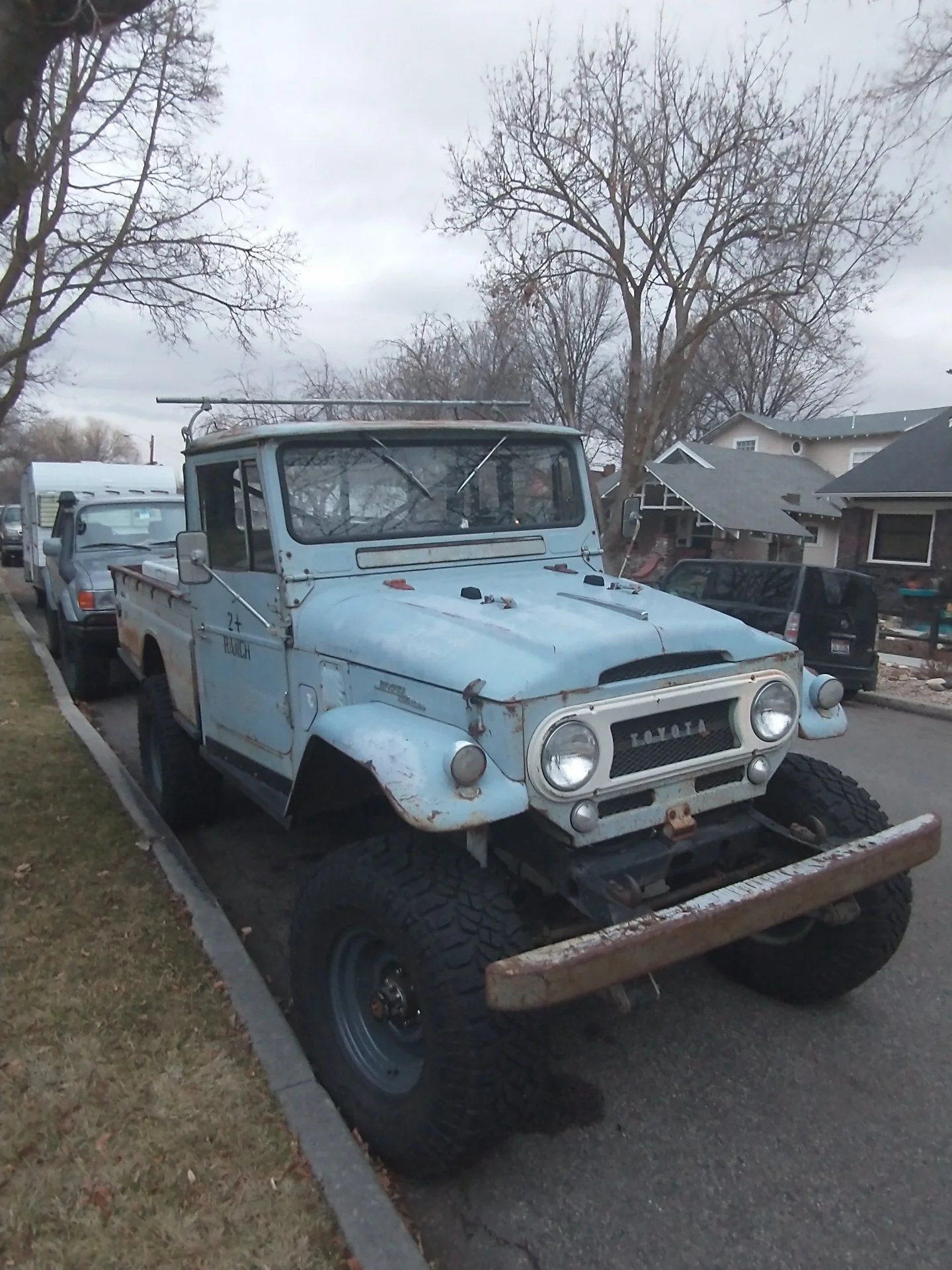

Here's how it looks currently on the 35's.

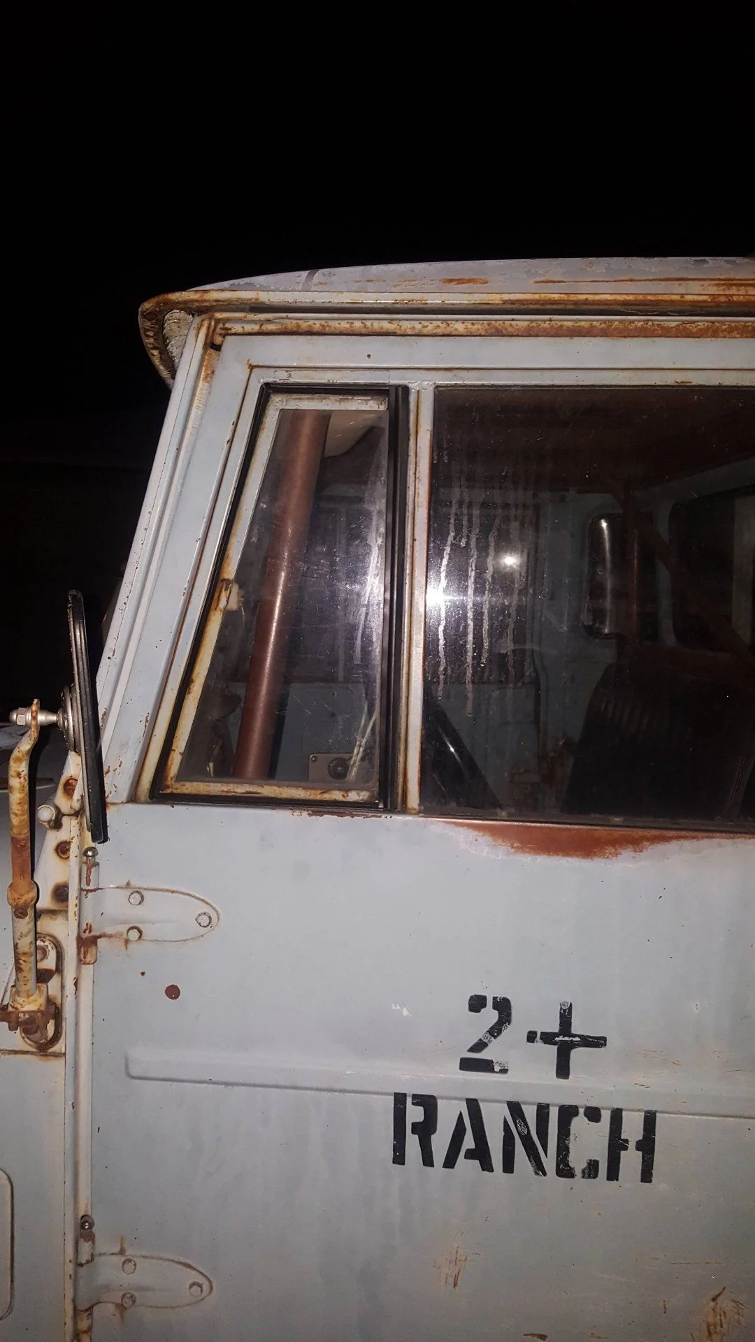

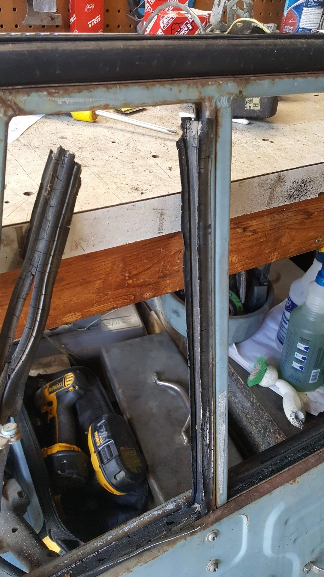

I've been worried the corner-glass was going to fall out and this summer one of them finally did, luckily the top was off and sitting on the ground...
So, I finally ordered some replacement seals from City Racer and got them installed this weekend, just in time for our first snow. I've never installed windows before, I'd recommend wearing gloves as I've got a nice blood blister from pulling on that rope. Definitely helps to have a friend help with this.
Also noticed the OEM (big window seal) rubber was way more pliable than the aftermarket/repro rubber seals.
I also replaced the wing-window rubber a few weeks ago. I remember giving a guy $100 for these way back when and he took so long to reproduce them, I gave up and asked for a refund...fast forward 15 years and my windows were being held in with gorilla tape, so I googled and found that Kurt has them in stock and about the same price I think. I didn't do a great job and mitering the corners, but it's better than gorilla tape.

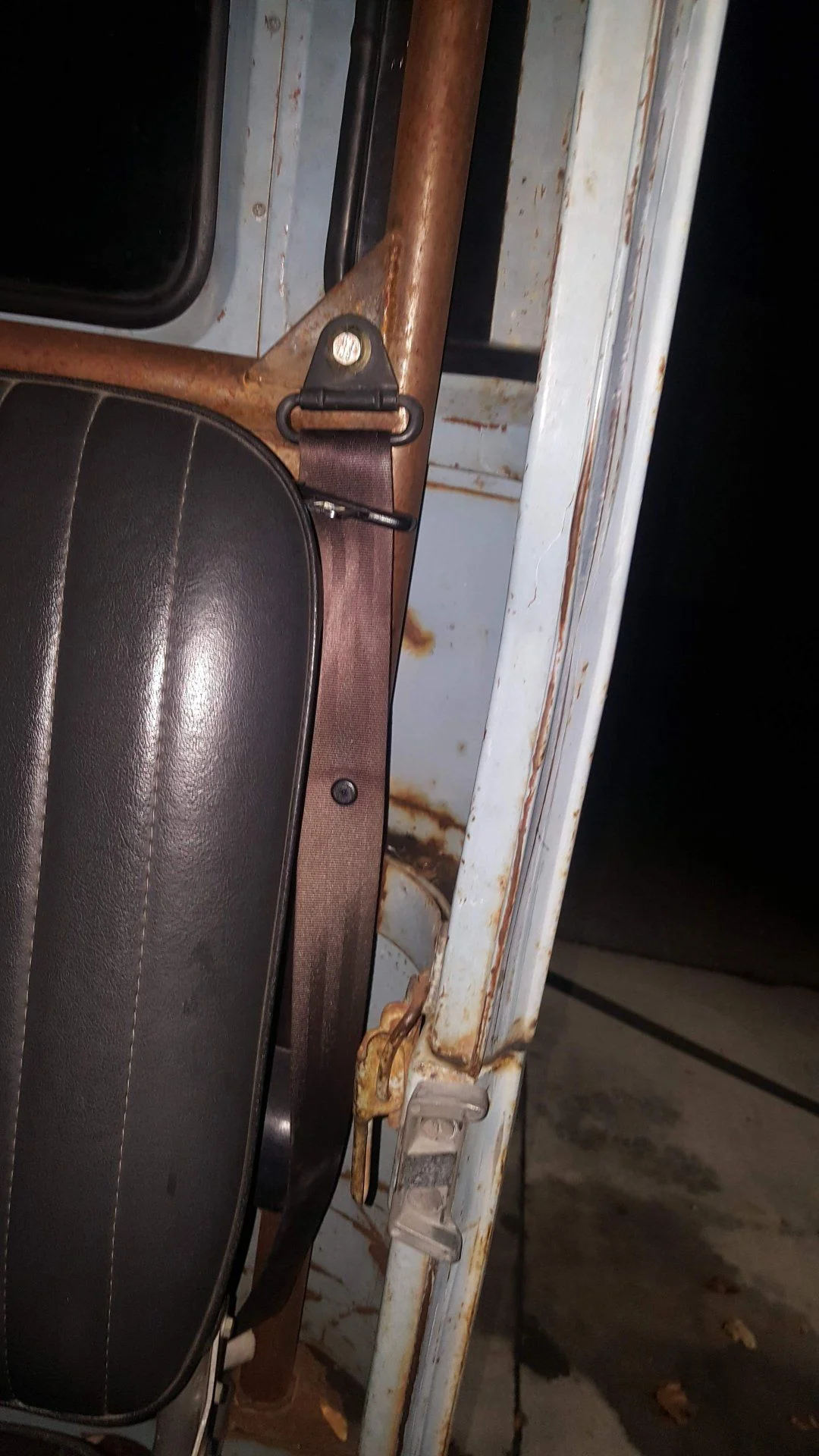

Here's a link to a thread with some pics of the roll-bar and shoulder belts I installed years ago. I've since relocated the shoulder belts a bit as I had mounted them too high and the belt rubbed my neck which was irritating.

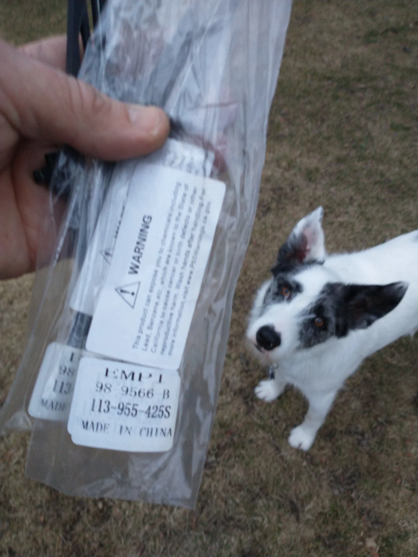

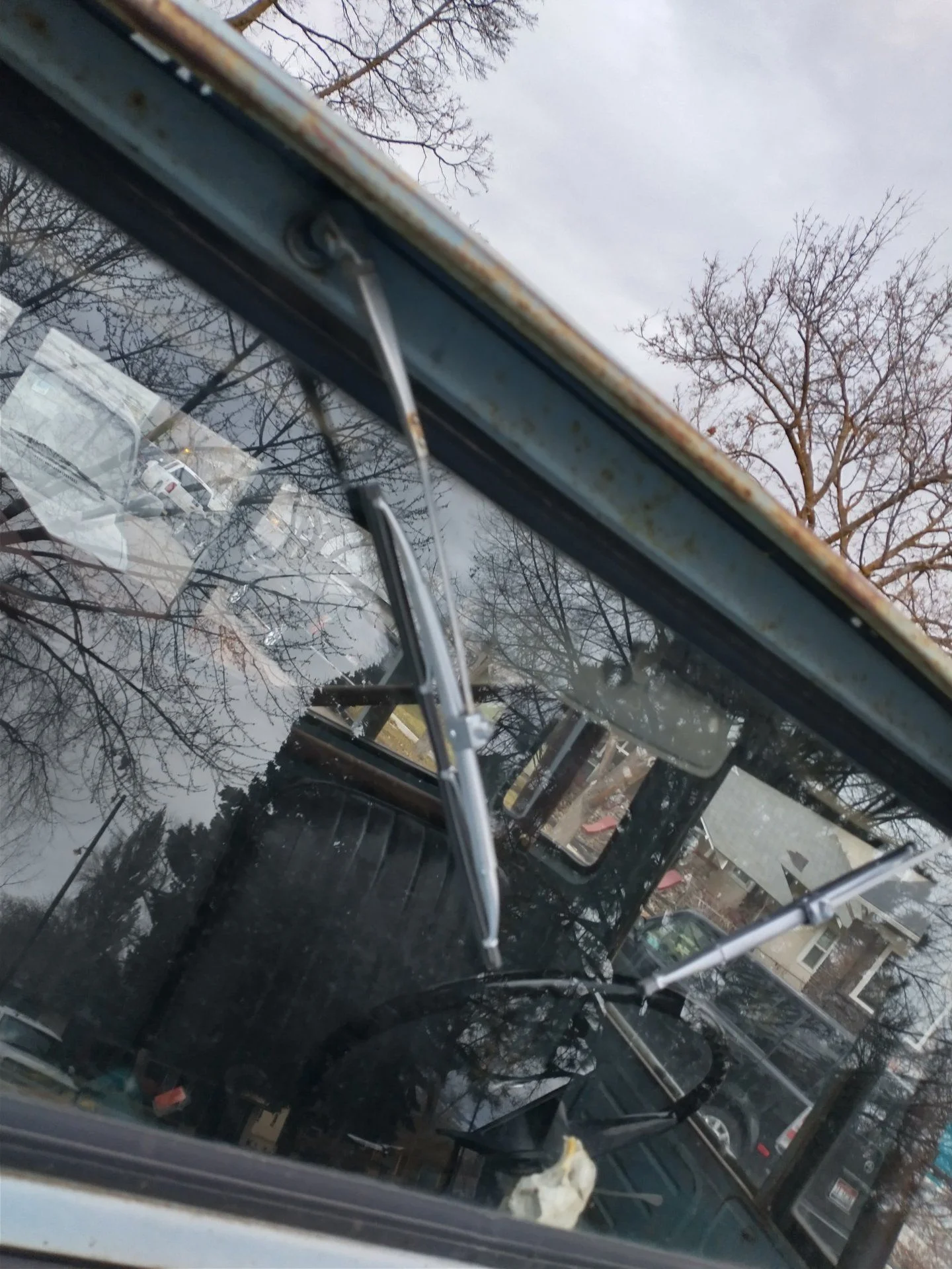

Last time I bought wiper blades for this thing I got them at a local vw shop that is now out of business...got these on Ebay. Empi 98-9566-B for a 58-64 vw.
Not sure my arms are stock, these are 10" long and screw onto the arm.

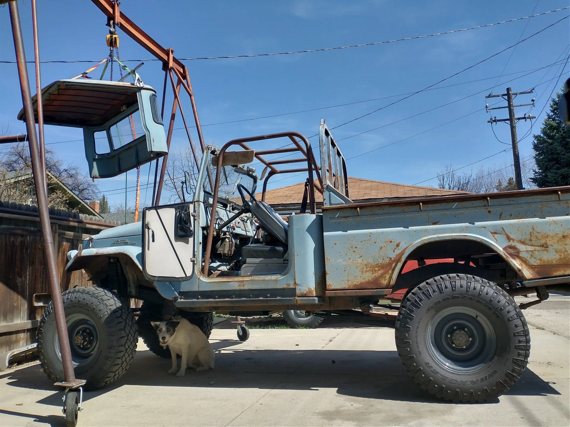

Pulled the top and doors off today and tried out my 'new-to-me' vinyl half doors. I usually just don't bother with doors in the summer, but the dog isn't a fan of the no-door thing and he's a bit unpredictable, I think I need to get him a harness and tether him to the roll cage.
Thanks. They're a little small for my gearing. I had 37's on it for the last 15 years, with 4.88s. I need to re-gear, go back to 37's or maybe find a 5-speed to stick in it. It's wrapped out at 60 mph now on the new 35's.
The rubber on my 'new' VW wiper blades lasted 8-months...bought a 10-inch Bosch rear wiper blade, pried it open, swapped the new Bosch blade into the VW arm. Hope this solution will last.

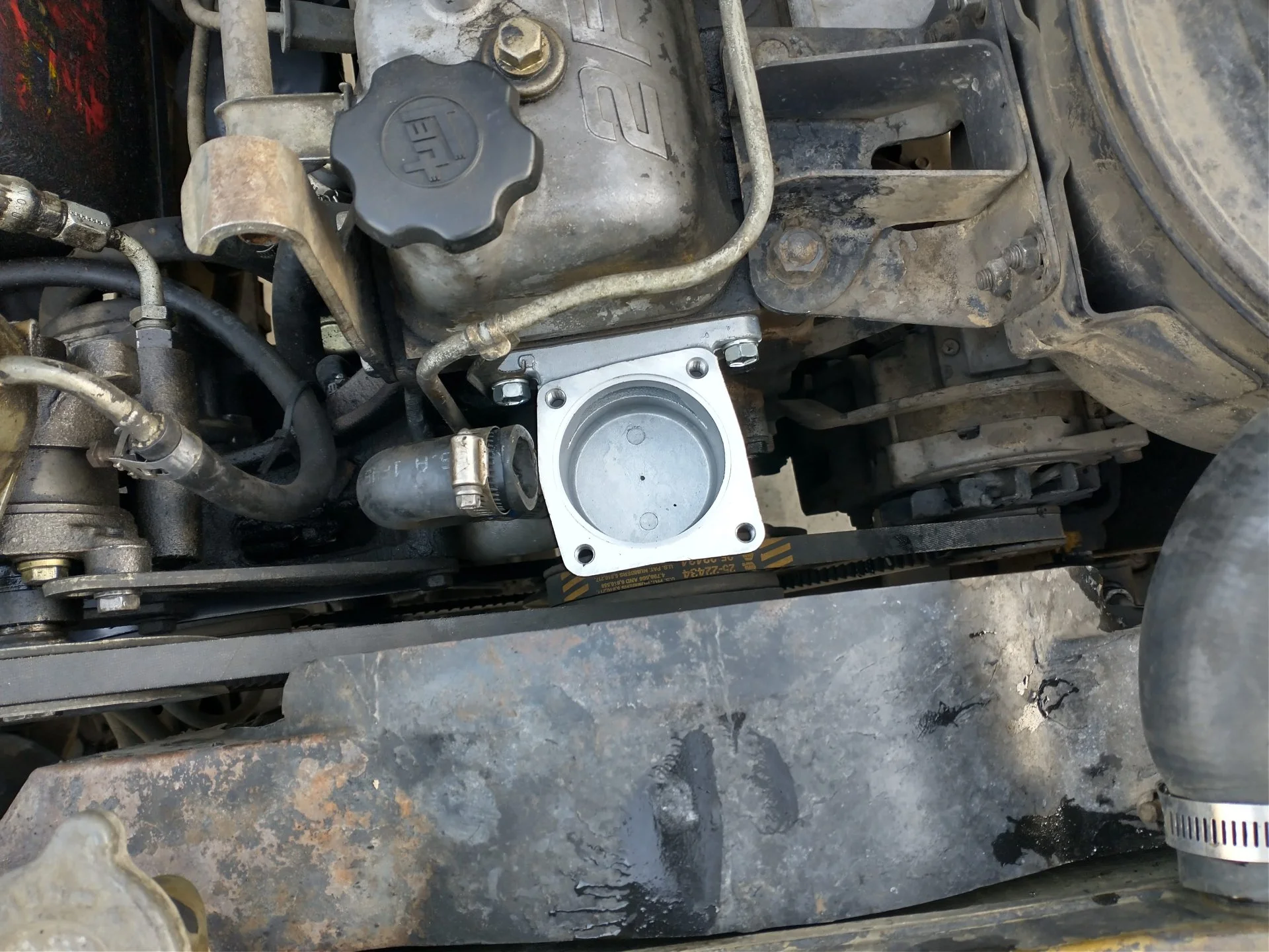

Also changed out my t-stat upper and lower housings, plus a new t-stat and new oil cooler circuit hoses. All except for a tiny two-inch section that looks like I'll have to pull the radiator to access. Might be able to get to it if I pull the power steering pump and ac compressor. Didn't feel like taking it that far apart yesterday, so I put that on the back-burner. Judging from the condition of the other hoses I removed/replaced, I should probably do that one sooner rather than later though.
Got a complete kit from city-racer with the housings and gaskets. Old one someone had somehow threaded in some coarse-threaded SAE 3/8-16 bolts, that were too long and had a stack of washers to make up the difference. New kit came with new hardware as well. Nice. Should have ordered the new hoses at the same time. Didn't notice how bad a shape they were in until I pulled the thermostat housings off.

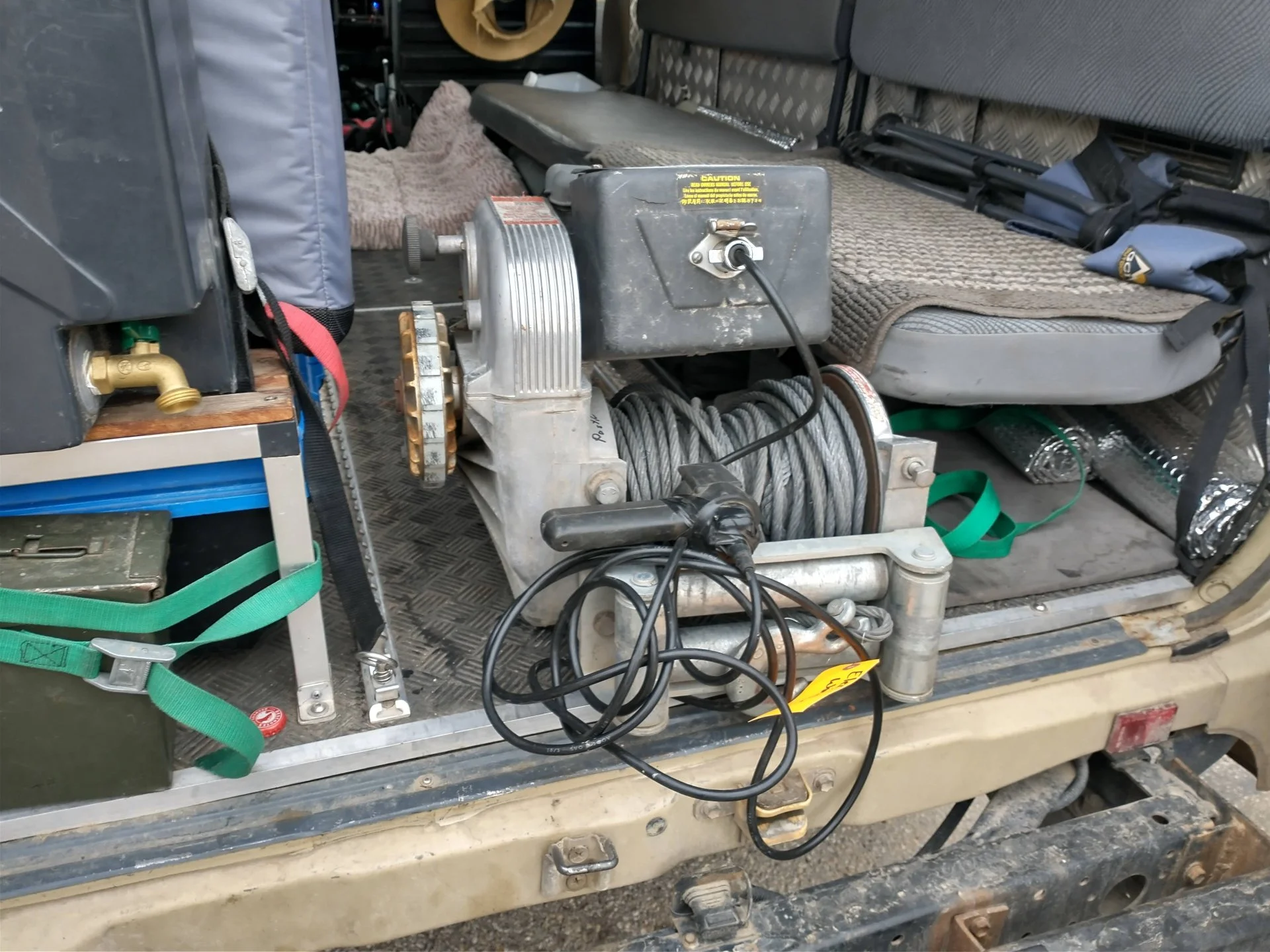

Just acquired this:
Plan to order a mounting plate and bumper re-enforcement and install on the front of the 45. I've been wanting to do this for years. Hope to get it done in the next few months.

Finally got the winch mounted up. Still need to wire it, but that shouldn't take long, I think I've got some left-over cable and lugs from other projects.

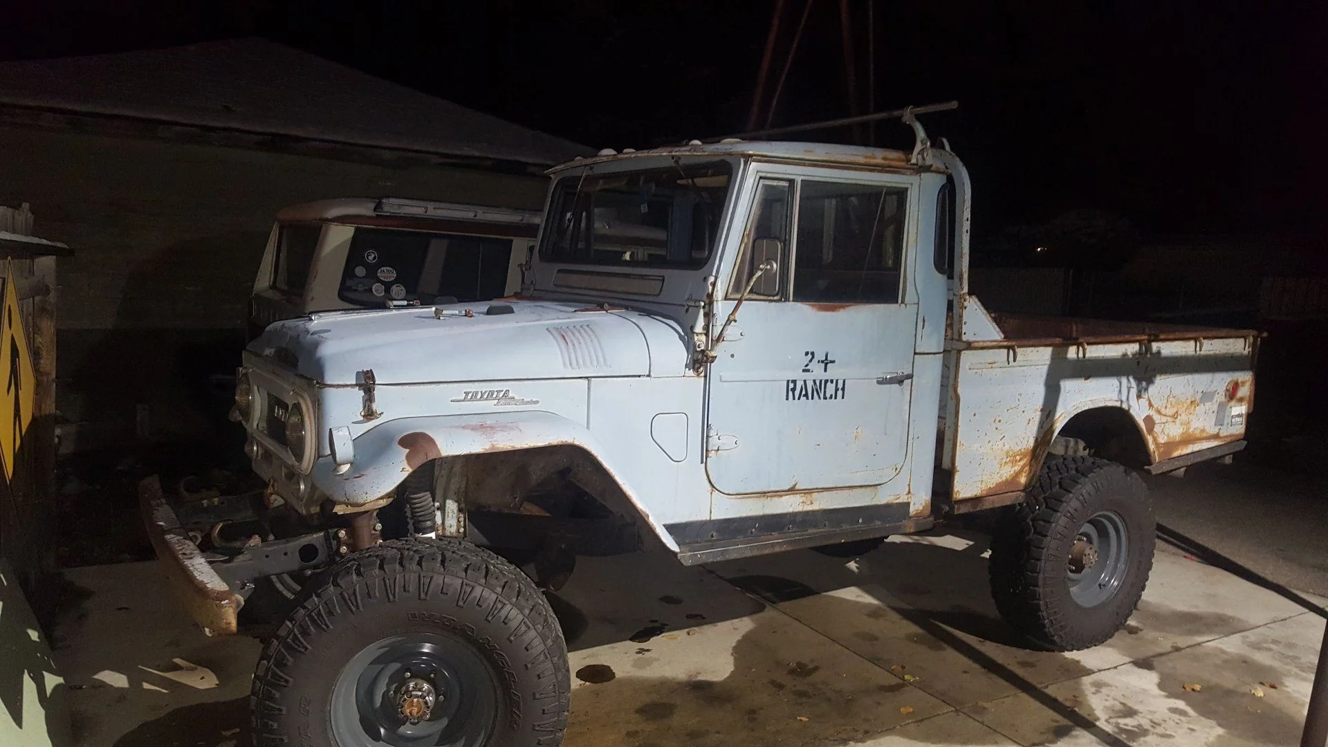

I'd forgotten that I had tossed the original front bumper as it was mangled so bad and replaced it with a 55 bumper from one of my parts-55s. I also must have tossed the triangle gusset plates that bolt to the top of the frame as well. I ordered a set from CCOT, which came with hardware, but not OEM hardware and only the bolts for the tow-hooks and two smaller bolts that I'm not sure where they go, so didn't end up using any of the hardware.
