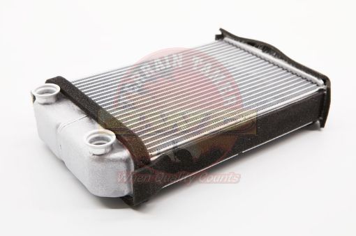

But my focus at the moment is my upcoming HVAC refresh. I have a new condensor, compressor, dryer, pressure switch, expansion valve and evaporator. My blower motor recently quit, and surprisingly crosses over to an '80s 4Runner, so I got that ordered from Toyota.
While I'm in there, I'd like to pre-emptively replace the heater core.
But 87107-90k00 seems to be no longer available from Toyota. I'm also striking out on ebay.au/megazip/partsouq/amayama.
What do folks in Australia/Japan do for heater cores in their older 70 series?

Requires more investigation to ensure fit, but Terrain Tamer look like they have a heater core:
That is for an hdj78. It is interesting that they don't list one for an hjz75. The dash is different but I wonder if the guts are the same. I will reach out and check. Thanks for the lead.
Dash is the same to 2007, but even after that the heater core is likely the same. Cross refrencing the PN 87107-60210 (TT shares the Toyota PN) it shows it working on Hzj78, Fzj78 and many others. But as you said, it's definitely worth getting some kind of confirmation that it will fit.
But they are ozzie dollars, so cheap as chips... well not really, but at least you have an option if Japan4x4 can't find you an OEM one
