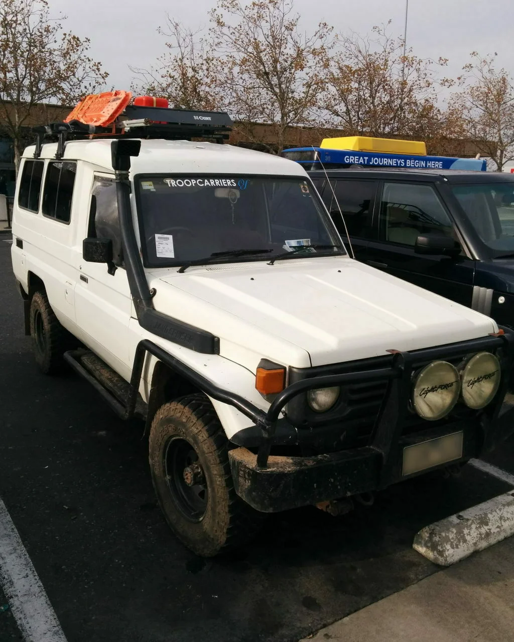

I'd been following the classifieds for a while. The first time I saw this thing, I thanked the seller but decided to walk away. It needed a lot of work. There was more fuel coming out the back of the injection pump than going into the engine. The seller was motivated though and a week later we worked out a deal. I dropped them off at the airport so they could fly home to Australia and I took the troopy home to figure out how to get US plates on it.
It also came with some max tracks, some lengths of pipe, an empty gas can, and some sturdy furniture built into the back.

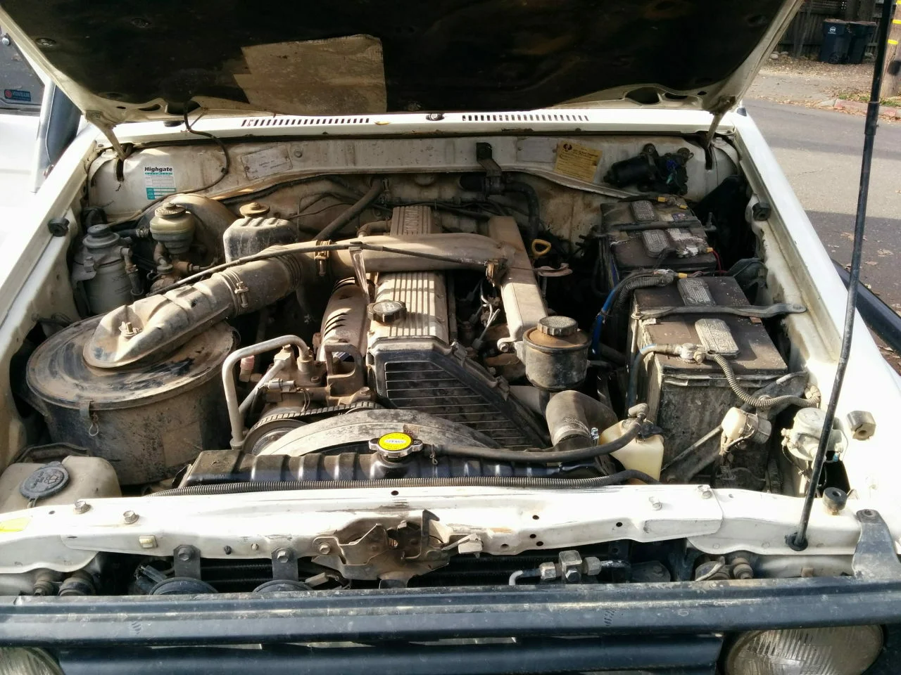

Dirty. Well used. I love it. But some of those electrical connections are pretty sketchy.

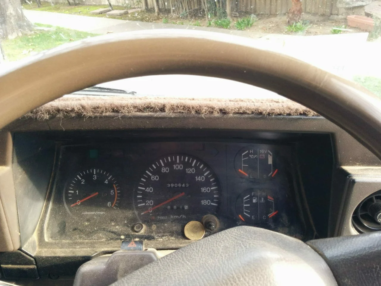

Only 390k kilometers on the clock.

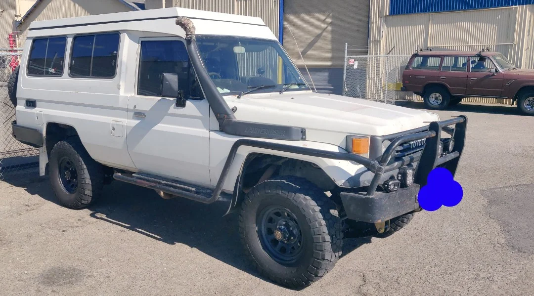

In the meantime, here's a quick shot of how she sits today.
With a 60 for company. And yes, I lost my snorkel cap near Laguna Hanson. This one is made from a 3" elbow and duct tape from Home Depot.

While waiting for my appointment at VH, I swapped over an X2Power AGM battery to replace one of the NAPA batteries that was completely shot, as well as the almost new tires from my previous rig. They had only a few thousand miles on them. I took the rims as well that the tires were mounted on.
The American Racing 16x7 rims have the same bolt pattern but as I went to drive it I quickly found I needed spacers up front to clear the brake calipers. I also added a small ARB Fridge. I had a Norcold fridge before that was cheaper, but the handles broke and it developed other issues after just a few years. Hopefully the ARB will be more rugged.
At VH we tackled a long list of deferred maintenance and upgraded the alternator.
  • Terrain Tamer 110a alternator
  • Rear brake shoes, cylinders, and drum resurfacing
  • Injectors and injection pump rebuild
  • Shifter rebuild
  • Transmission and transfer case rebuild
  • headlight harness repairs

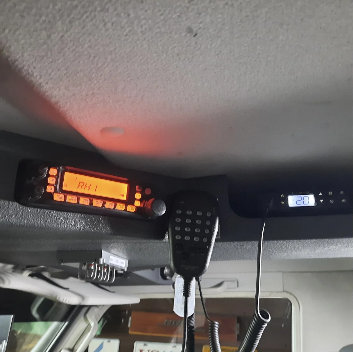

On the radio, it depends on your club/friends and what they use.
US-specific advise:
The nearest club to me uses 2m ham (vhf, license and not-too-hard test required). Some of my baja friends use gmrs (uhf, license required). Some of my baja friends have no radios. I hand them an frs radio (uhf, no licemse required). Logging trucks on national forest roads use cb (hf, no license).
I have a 2m ham radio in my troopy for club runs and gmrs/frs handhelds for that crowd. I plan to add an hf radio that can receive cb.
With shenanigans you can use multiple services on one rig but the FCC regulations don't allow it (ex: using a ham radio to talk to a gmrs user). Only exception is gmrs radios can talk to frs radios.

Get a $35 fcc gmrs license and a decent radio to put in your cruiser. Get a good antenna and mount it well (nmo mount if willing to drill a hole in your roof, a fender clip mount if not). Then get a couple cheap frs bubblepack handhelds for unlicensed friends.
You can always go ham later if you want.

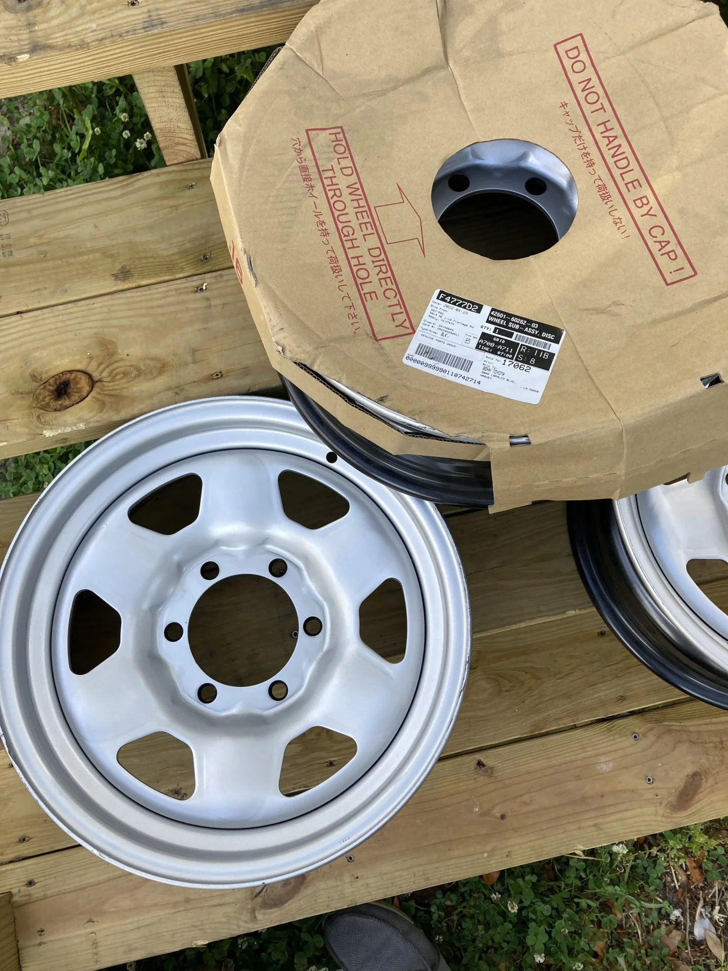

  1. Does anyone know the width / backspacing of OEM rims on an hzj75 australian troopy? PartsOUQ shows it would have had split rims (426106011103).
  2. What size tires do y'all like to run on your Troopies? Mine is a heavily laden 1hz that sees a wide variety of conditions. Stock gears with the exception of a sumo 3:1 crawl gear for low range.
If I don't find something good in the next couple of days, I will order a new set of BFG KM2s or KM3s in 285/75/R16 on my current rims and just stay with what I know.

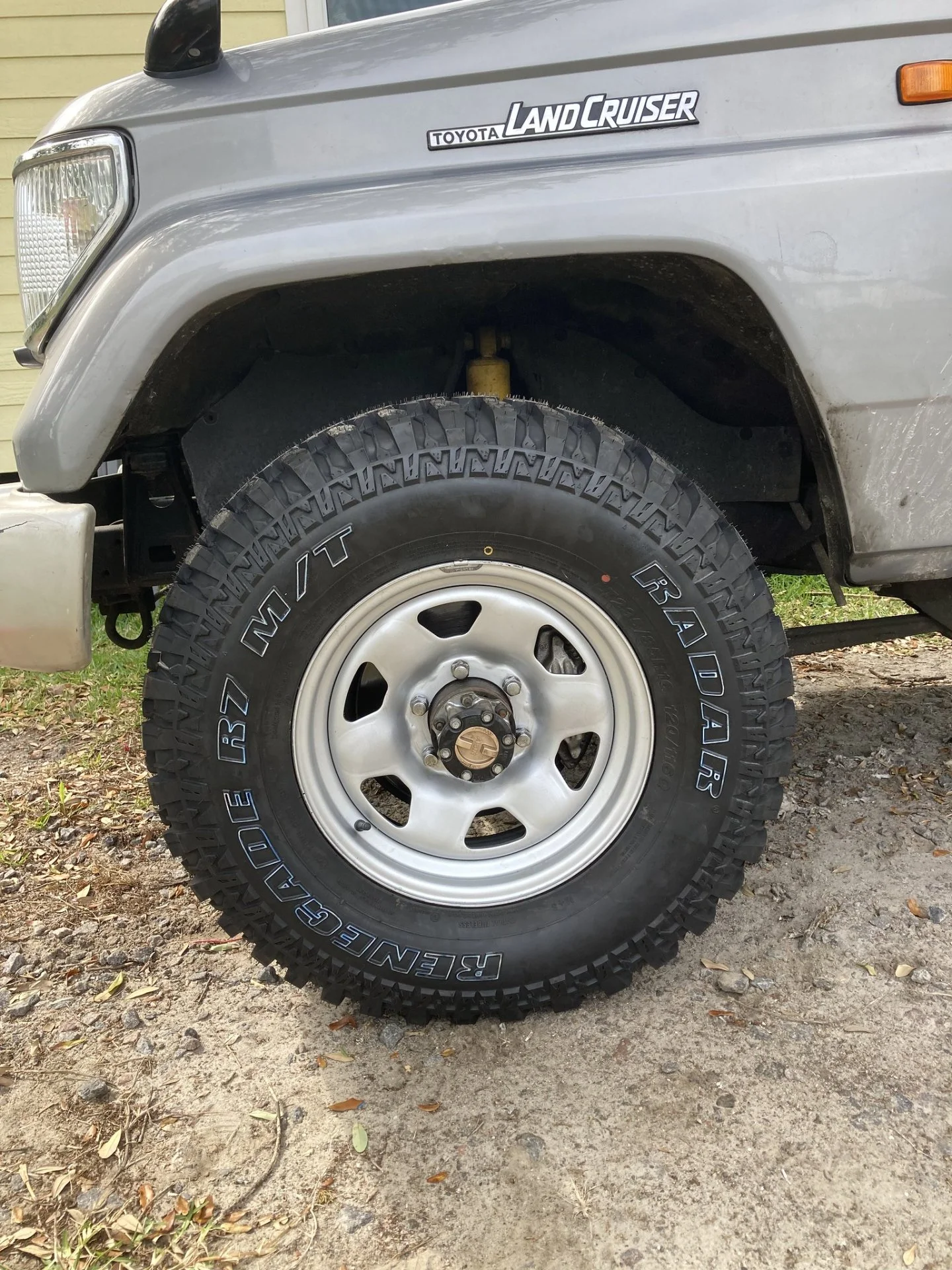

42601-60262-03 16X6 OEM Toyota Steel Wheels for 70 series (same specs you listed above), go well with 255/85 R 16, and available from your local toyota dealer. Lots of folks using this combo and tire size.
Here's a couple of photos stolen from @Roastchestnuts kzj78 build thread showing the rims. I think he's running a smaller tire though 235/85R16
And on a Troopy
