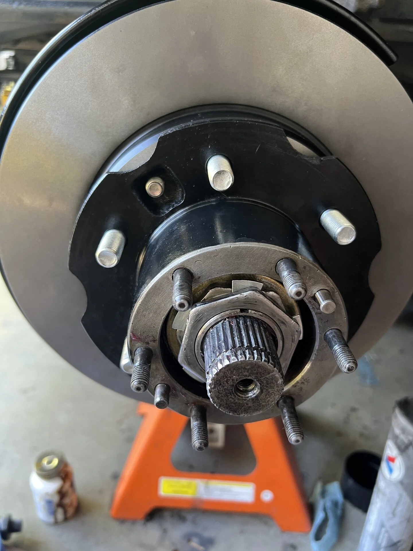

I’m having a heck of a time getting the preload dialed in. Long story short…. Completely rebuilt the knuckles… set the preload like the manual says, works smooth with 3lbs.
When I put the locking nut on and set to 58ft lbs, now the preload is around 9-10 ft
Lbs and out of spec.

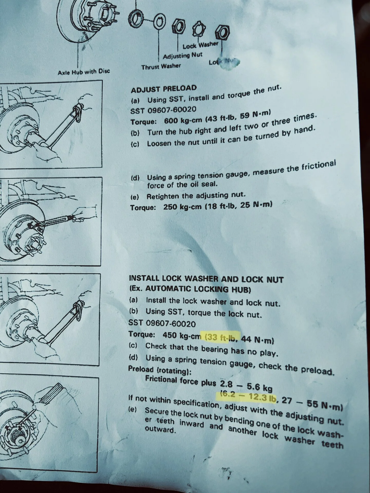

One printout I have says set the locking nut to 33ftlbs.
Am I missing something? I followed the directions exactly but that darn lock but throws the preload out of whack.

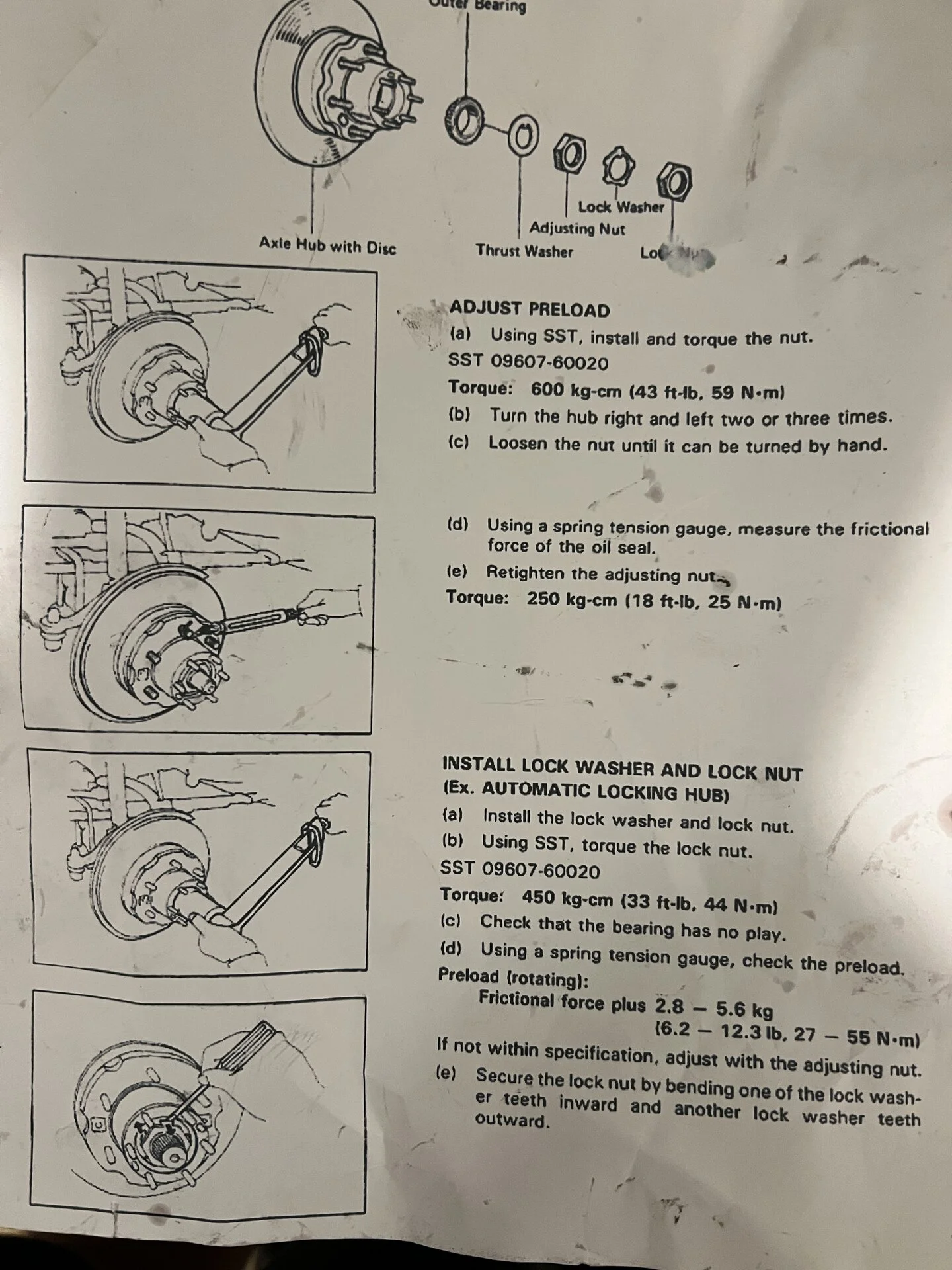

It says torque to 43ftlbs then back off, then torque to 35-60 inch pounds. Then if the preload is not within spec tighten the adjusting nut to proper preload.

Where are you getting 58ft lbs from those directions? I see 59 Newton meters. Or 43 ft lbs.
Does the lock washer have a tab in the ID that indexes with the slot on the spindle to prevent it from spinning?
The 2nd set of instructions says to torque 2nd nut to 33ft lbs. It sounds like the inner nut and washer is spinning/tightening when your tightening the outer to 58. It's just a lock nut which is locked by the washers folding tabs too.
Both the 54's had some ding marks in them from the PO using a cold punch to get them free. I ended up bringing a file and some sandpaper to them to make them newish again. It worked because the final preload was 9-10 ft lbs instead of 15+. I am going to roll with it.
