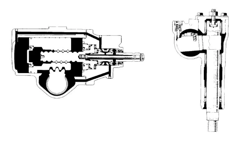

As the wheel turns a large piston in the steering box will draw fluid from the reservoir through the pump, into the box, out to the cooler and out the return line to your drain pan, valves in the box keeps the fluid going in the same direction no matter witch way the piston is moving.
