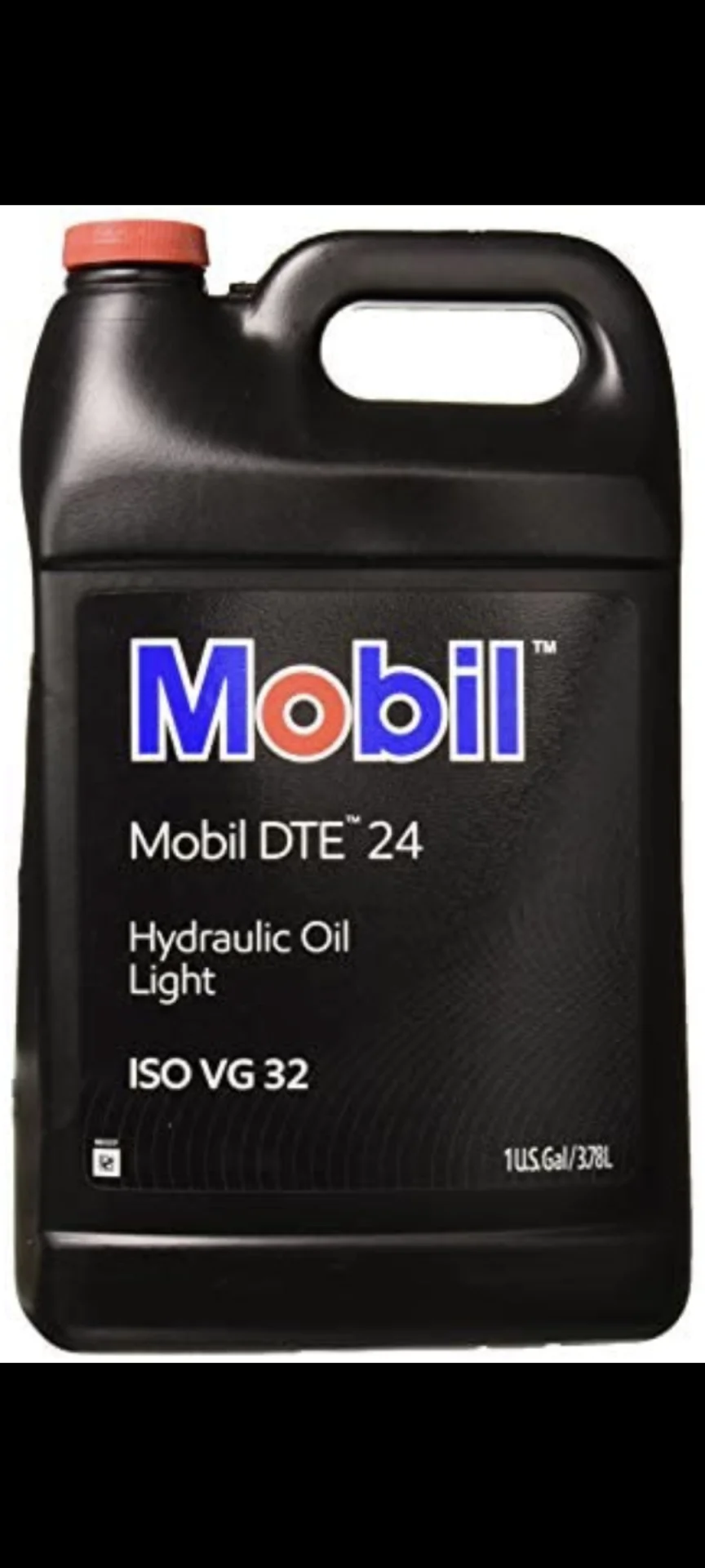

On the baselining page, it says to use Mobil DTE 24 - "Highly recommended". I looked for it on Amazon and all I found was Mobil DTE 24 hydraulic fluid. Is this correct? Just want to make sure I am putting the right stuff in my rig. I am somewhat new to mechanics so please forgive me if I sound ignorant
A couple people here said to add some downey...as in fabric softener? Do you just add a cap full in the reservoir?...
I wouldn't, not a fan or water in the system.
... I looked for it on Amazon and all I found was Mobil DTE 24 hydraulic fluid. Is this correct? ...
Correct.

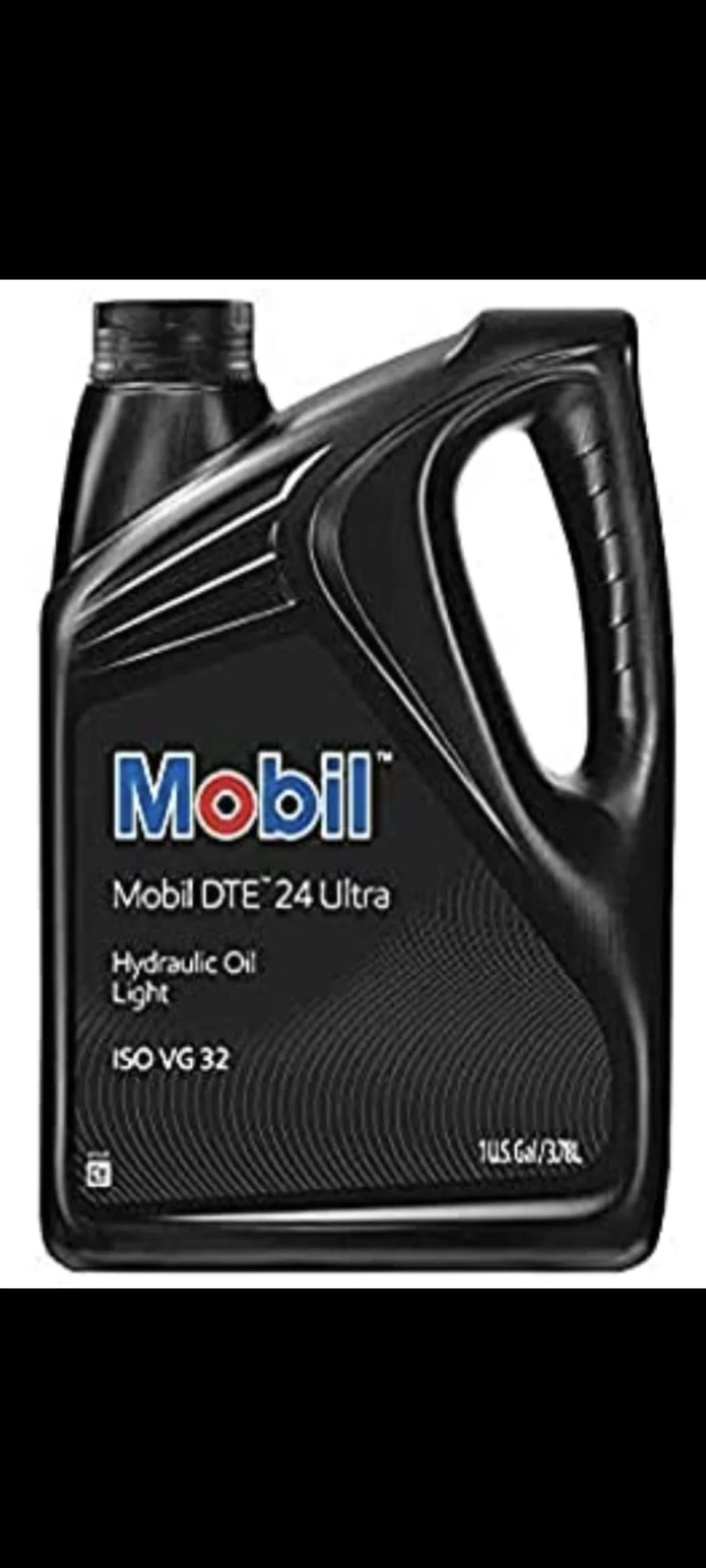

As I read more mud and decided, does anyone know if there is a preference on the Mobil DTE 24 "Ultra" and regular DTE 24?
