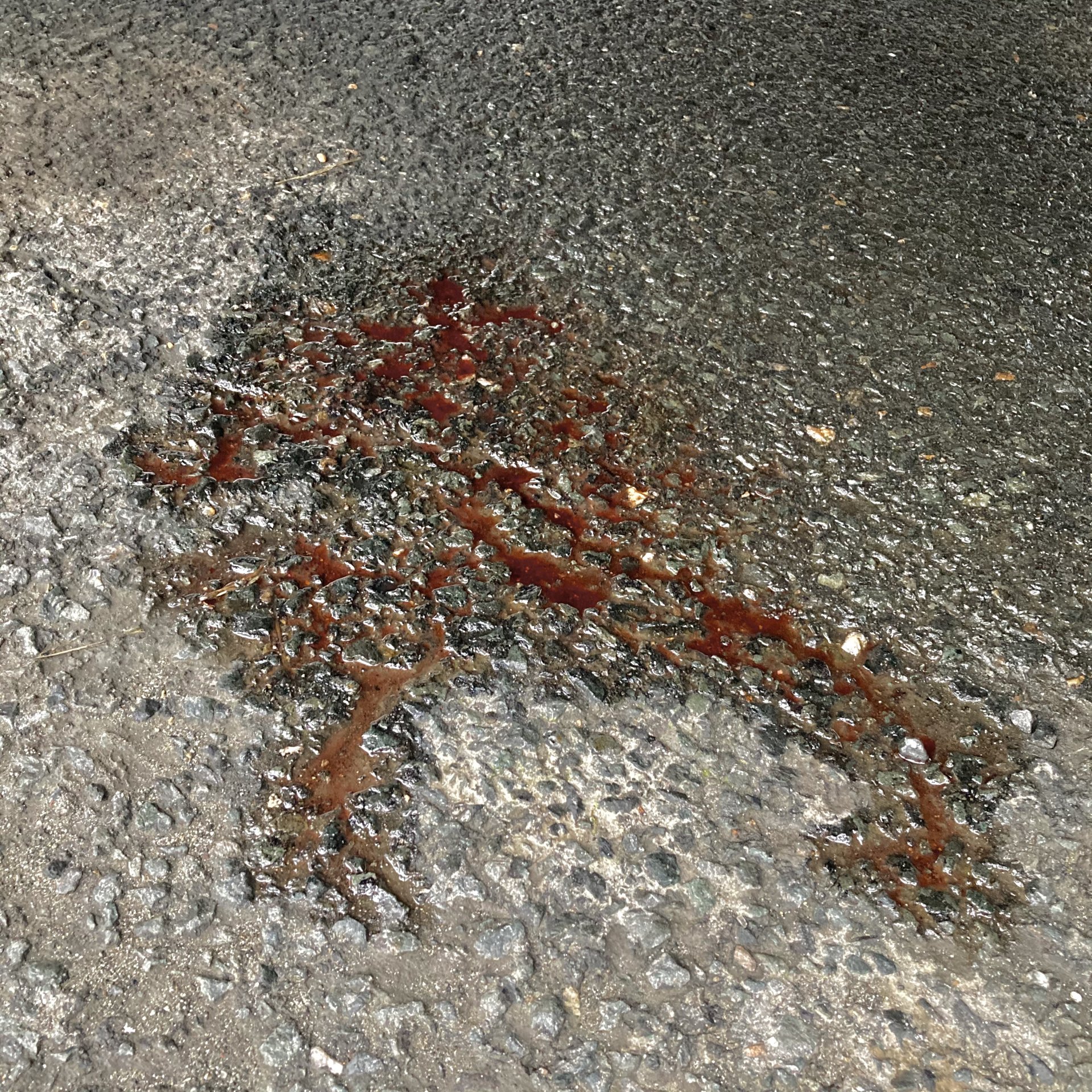

Being lazy. Recently did a standard fluid exchange as PM, and replaced the hardened return line. Old fluid was not bad & no issues to report at the time. However, now I have a slow leak that I’ve had to top off daily or every other - pretty small amount, from barely touching tip of dipstick back to top end of cold line. Can’t find the leak yet (should be noted I have typical slow oil leaks in front that make it harder to spot), but wondering if this is something that happens? Replaced with maxlife. My guess is it’s at the pump, but need to clean it up better and take a closer look when I have time. NBD, just haven’t had this happen with another vehicle.
Pump sometimes groans a little on a cold start IF I don’t top it off, but goes away within a minute. No groan or other iffy operation when fluid is topped off, and there were no prior issues. No noise, no fluid loss, smooth operator.
Can rebuild pump if necessary, and I’m sure it’s original, just found it strange as I did this engine-off fluid exchange with the same stuff. Maybe old seals already weak, pushed something out of the way and fresh fluid is finding its way out? Can’t imagine it has anything to do with the new hose, and I’ve double checked connections. Is there a possibility the non-running lock-to-lock flush can do something to the system/pump that wouldn’t happen under normal operation?
Yep, I’m gonna need to tend to that. This is the worst I’ve seen it - not a ton of fluid, but only 7 hours parked at work. Appears to be dripping from the back of the pump. I assume the fluid exchange did push something out, and fresh (thinner?) fluid found the weak spot.

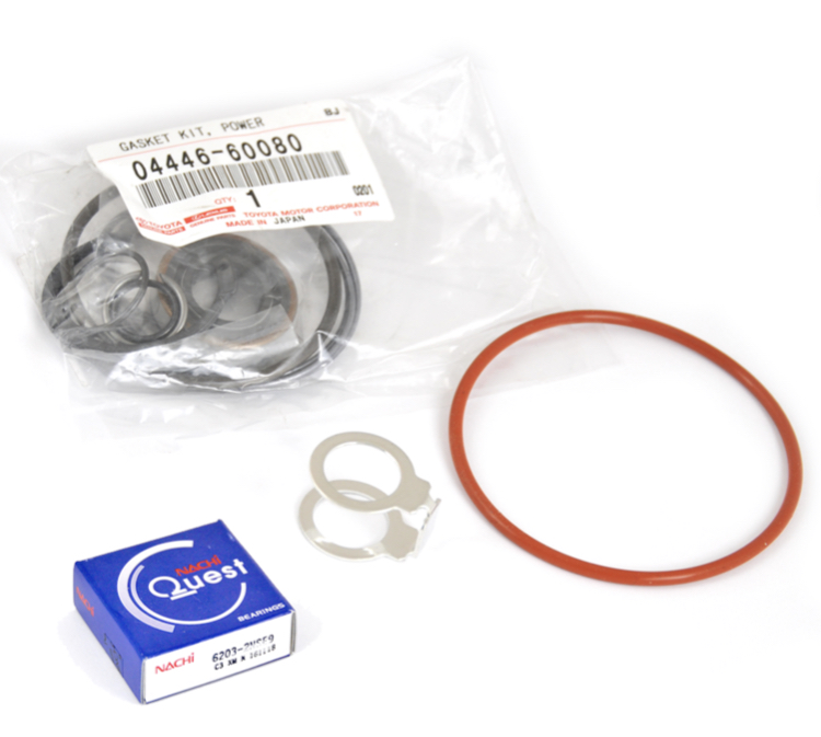

Likely the rear O-ring. Ovehauling the pump is a :banana: job, providing you have an air wrench to remove the gear nut. Take very good care of the gear; it doesn't seem to be hardened and any damage, no matter how slight, to the teeth seems to result in annoying whine. Also, if you haven't already done it, now is the time to replace the HP hose. The Rein part from RockAuto ($40) is the OEM part, for waaaay less that the OEM price. You also need the crush washers for the hose to pump connection; they're not in the overhaul kit.
Thanks. Yeah, looks straight forward, will borrow an impact from a friend. Mine is a weak POS... probably time to get a good one.
This is the banjo double washer in Joey’s kit?
Yes. Vast improvement over trying to secure two of those while trying to line up a hardline. You can get them for the brake calipers, too.

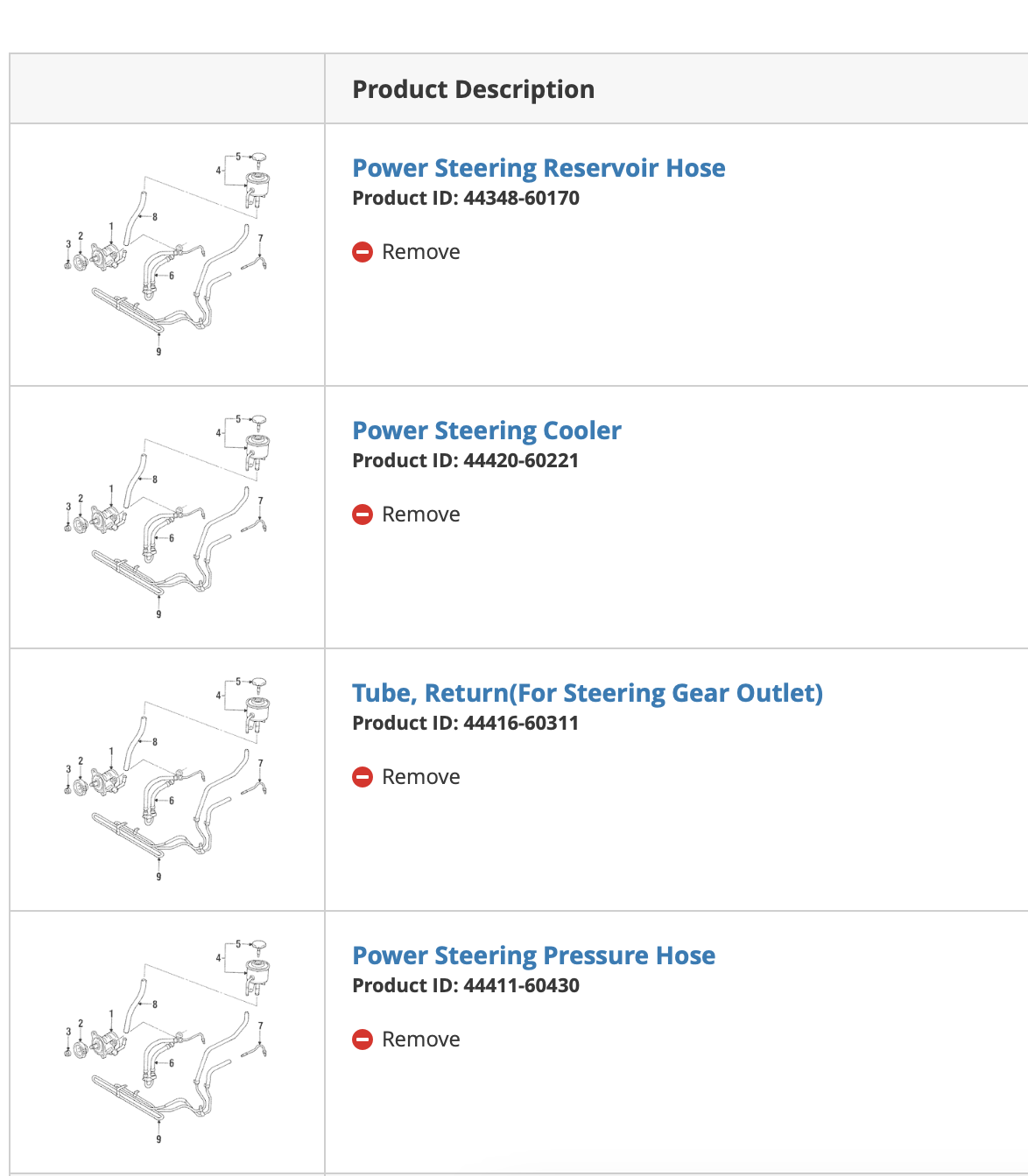

While refreshing all power steering hoses with new, I'm going to be replacing Mobil DTE with Valvoline Max Life synthetic ATF simply because I'm tired of buying a huge gallon and storing it for a long time. It's also more than double the price now.
Just in case anyone else comes across this thread looking to do the same thing, here's the OEM parts list. Don't forget the one-piece copper gasket for the high pressure hose (44327-30030).
