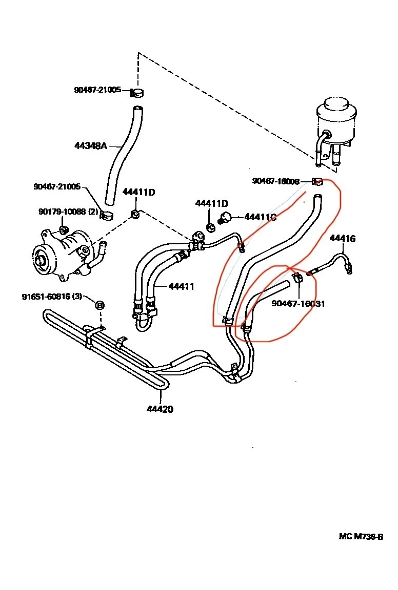

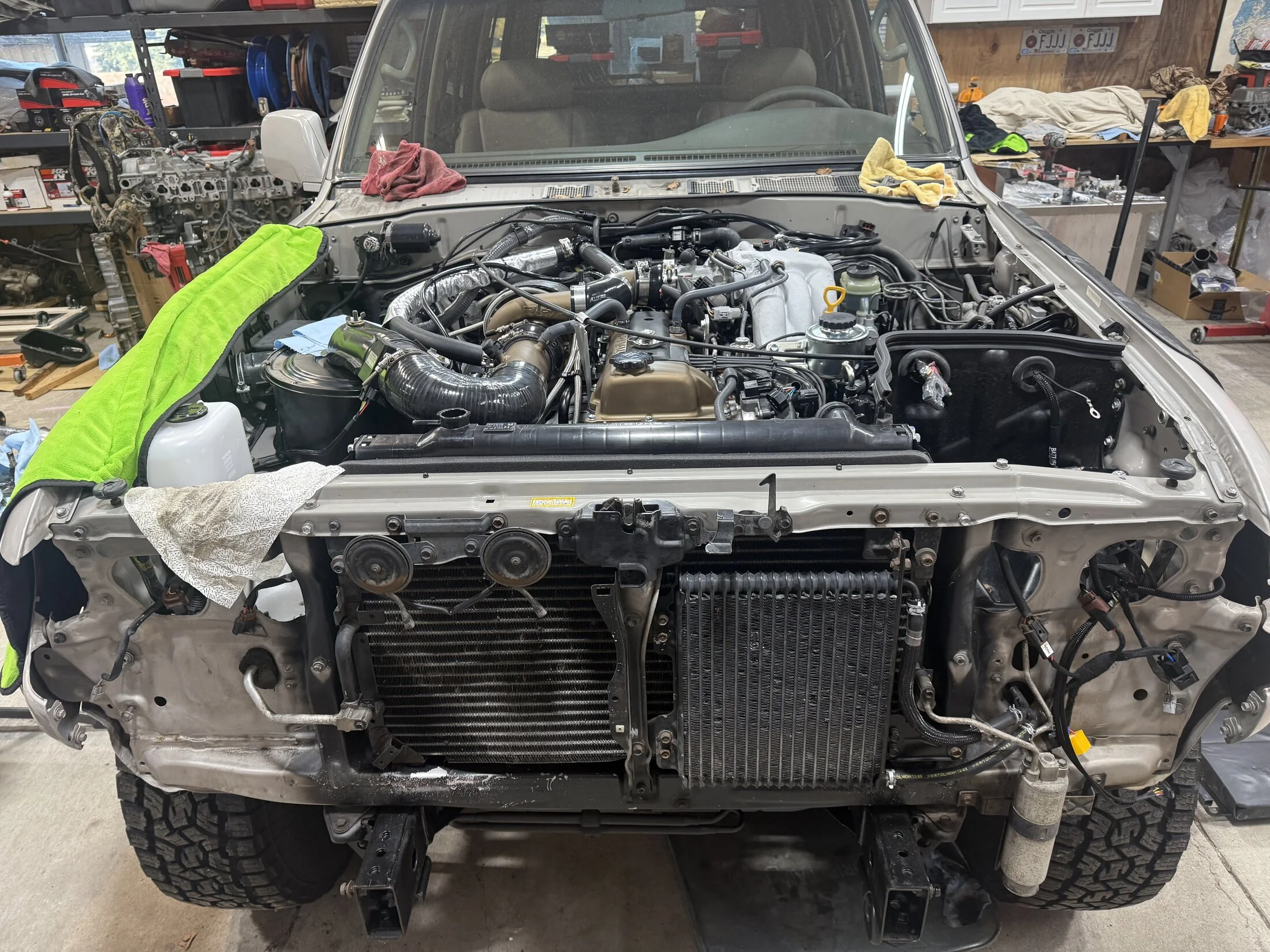

After I got my ps box out, realized that I am short a couple of hoses to complete my project. Specifically two low pressure lines, one from the ps box to the oil cooler and one from the reservoir to the oil cooler.
Searching around on mud gave me:
44412-04010 Tacoma (to reservoir)
44412-28160 Previa (to pump)
But the Previa hose looks like it is NLA.
What is the best alternative?

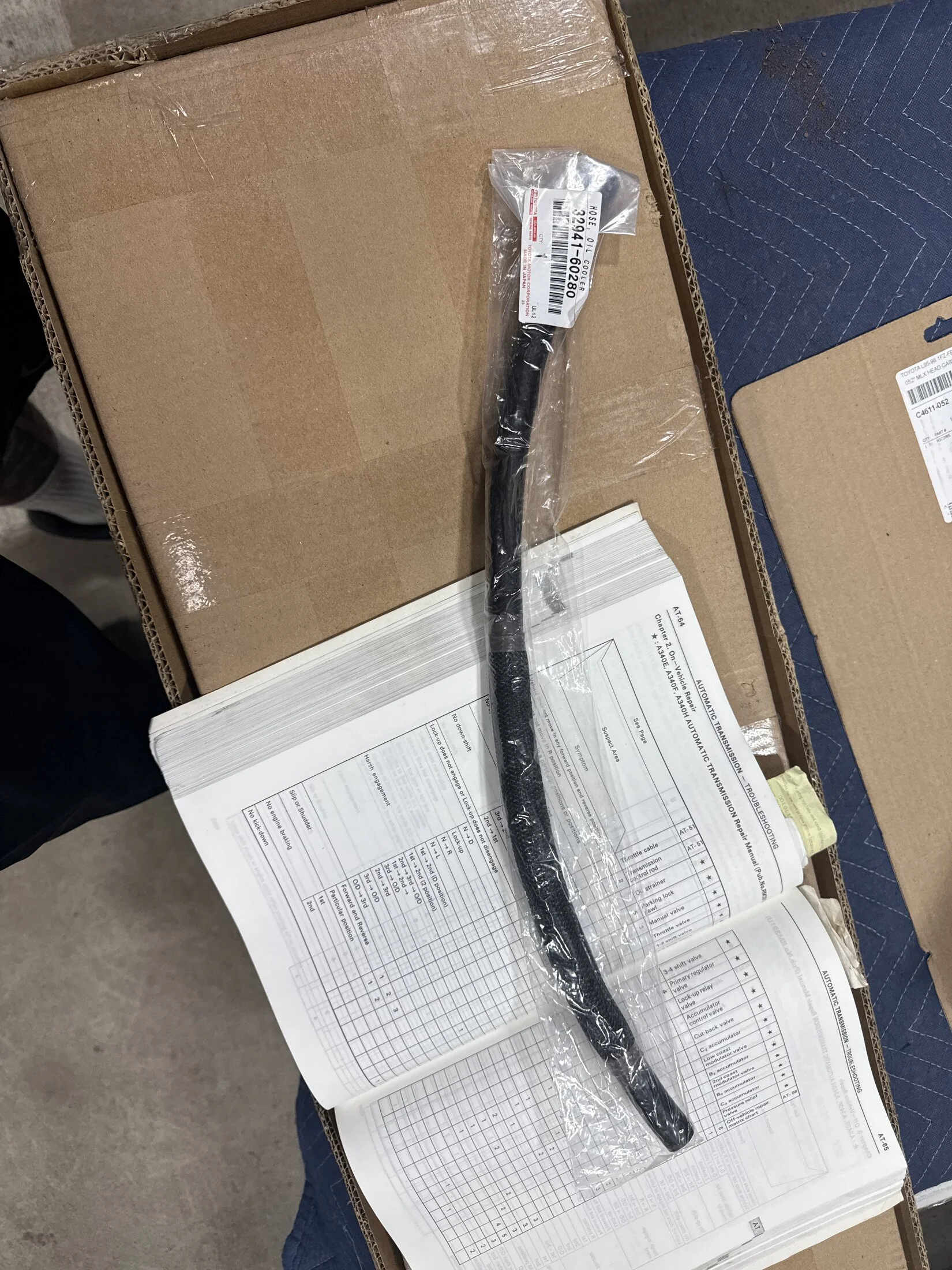

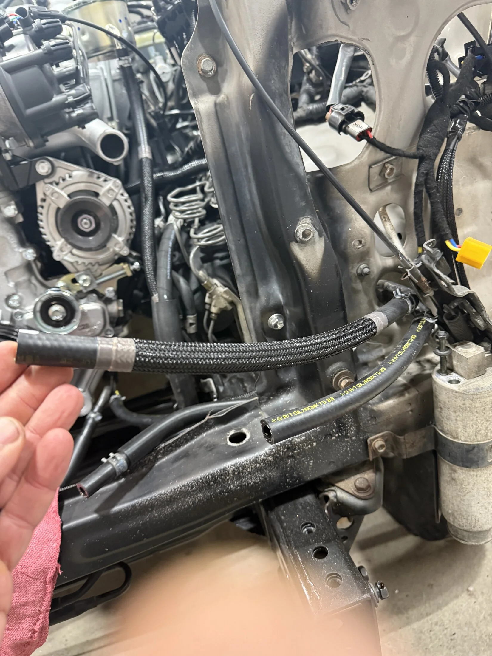

I’ll give up my secret hose
Toyota part # 32941-60280 I believe it’s from a 4 runner it has a nice braided reinforcement on it and is the correct 10mm size. Amayama or partsouq is the best price. It’s expensive compared to the gates but the factory clamps will work and no fighting to get it on. I also use the gates hose sometimes it’s cheeper to buy in bulk use a little ATF to install.
