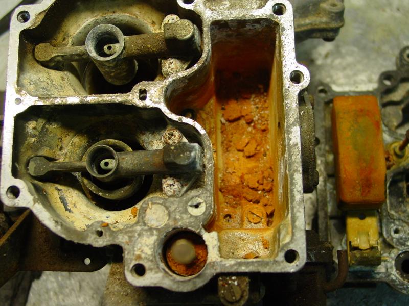

When storing an engine outside, don't worry about covering it. The air cleaner will do a good job of collecting rainwater and trickling it down the air cleaner stud. The water will coat the carburetor and cylinders w/ open intake valves w/ a coat of protective rust.
I think that this was what happened to my '75 with a leaky windshield washer nozzle and the hood down.
