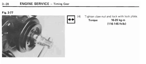

Jim mentions 200+ ft-lbs for the nut. The FSM for '75 (below) indicates 116-145 ft-lb, but includes a lock plate.
I've looked at the '66 and '72 engine FSM's, and they don't mention a torque.
Is the 116 - 145 ft-lb okay, or is there a 'Mud "service bulletin" that suggests the higher torque?

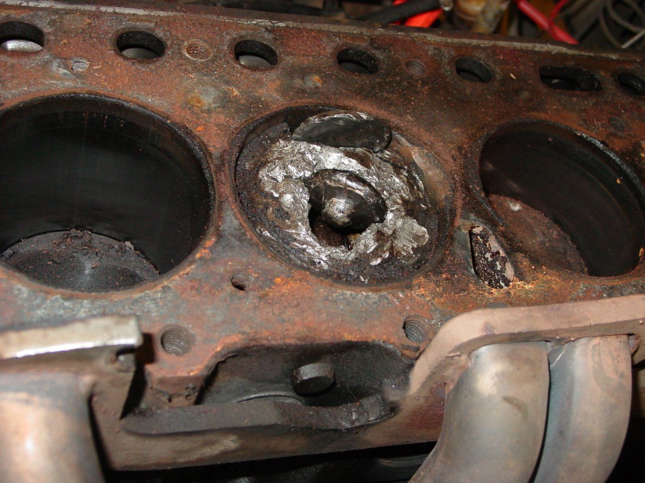

I had a valve disc break off in my original 2F. Just a freak thing I think. It was years ago, it didn't keep running and never started again. I can't imagine this guy actually having this motor run with 2 valves busted off. That's pretty crazy.
This is what I found when I opened up the original engine from my project. No piston or other head damage except rust. I'm guessing this truck sat with the hood open and that nice little funnel built in to the air filter housing let rain in through the carb and filled the ports that had the valves closed with water which later froze and broke the valves.
This failure was initially an exhaust valve that decided to part company from the stem. The engine was wound out on the highway when it let go, so it turned a few thousand more revolutions before it got pulled off to the shoulder. The bouncing exh valve broke the intake off while it was open. The 2 valves then pummeled the spark plug & piston. The engine also has coolant in the oil filter, indicating the possibility of an initial HG failure precipitating the overheated exh valve failure.
Bottom line: this 2F is now a paperweight.
what would you say caused that?
Trying to keep up with interstate traffic, w/ 4.11 gears and tiny tires. Exh valve was approaching redline temp and one just gave up after being hammered on its seat at 1600 beats per minute.
