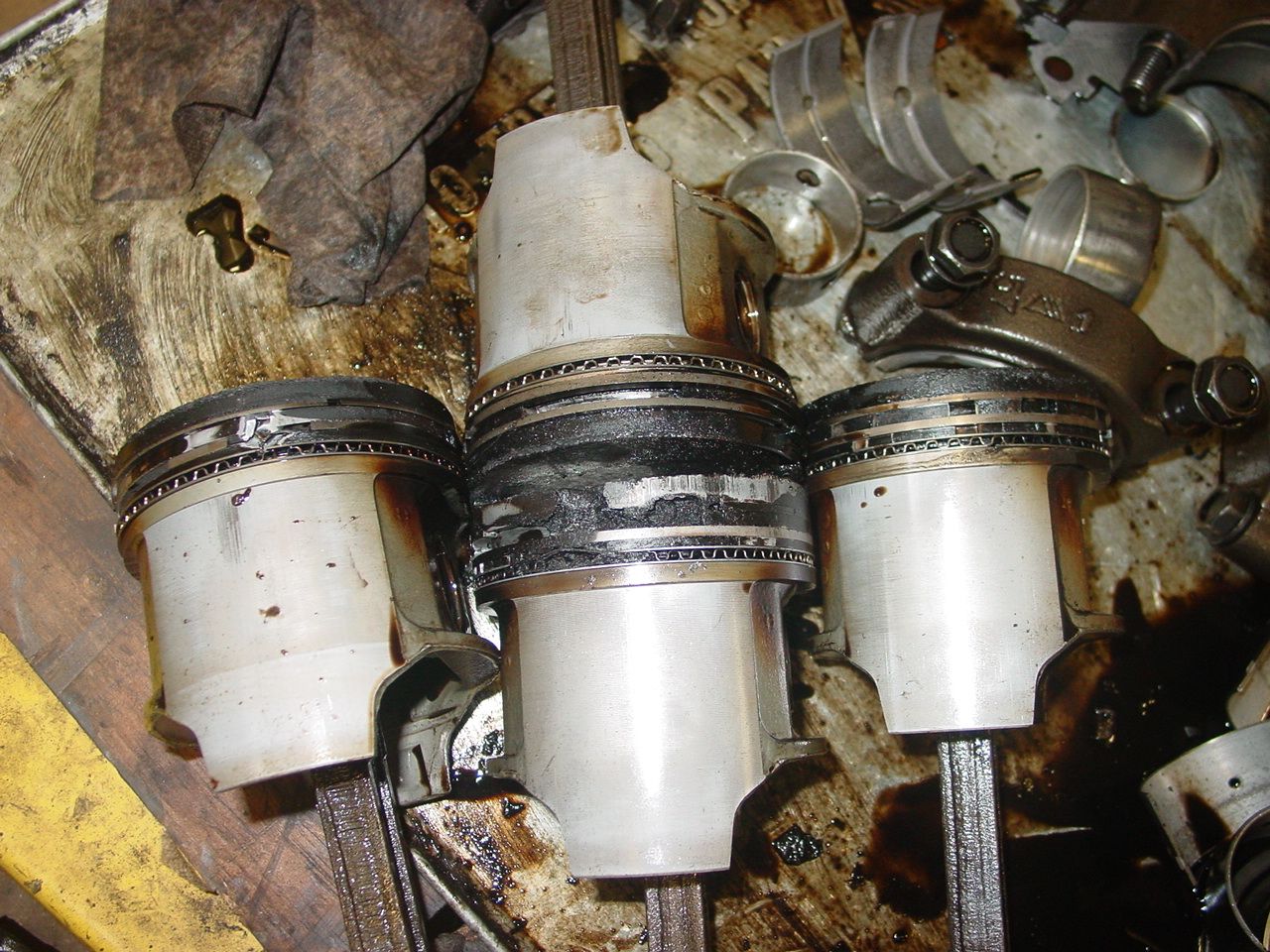

Advancing the timing as far as the dissy can twist, on a 2F that I rebuilt 5 years ago at 4.4L and 8.8:1 CR, will rattle the engine until it won't rattle no more. The rattling stops when the ring lands all shatter, relieving the compression. Amazingly, the bores were OK and a new set of Toyota pistons & rings got the engine back in service. Followed by a stern lecture about not fwcking with things that I have laid hands on.

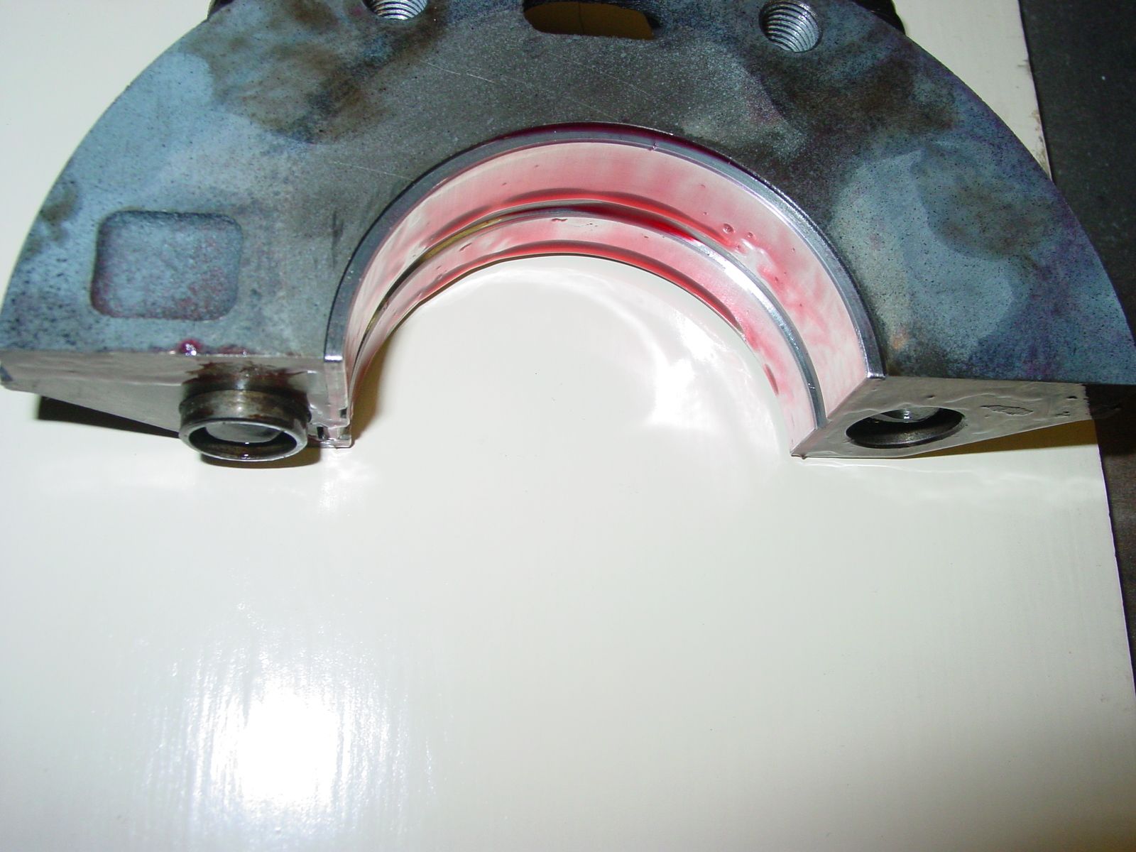

To simplify engine assembly, leave out these alignment dowel sleeves around every main cap bolt. Maybe a dowel around every other bolt is good enough? It is so much easier to get the bolts started if the part doesn't have to be perfectly lined up first.

FJ40Jim, do you ever see pre-ignition damage from glowing carbon deposits similar to excessively advanced spark timing? How were the exhaust valves on the one with the shatterd ring lands?
Why would you need dowels? After all there is a big ol' crank journal in there to help keep the bearings in line with each other and having a little float will just make it better... :hillbilly:
(for those not familiar with engines the above is sarcasm…:cheers:)
No, generally speaking these engines don't have enough compression/heat to get hurt by carbon deposits. Even on engines with hosed valve guides & seals, the carbon buildup seems to have no effect other than hurting performance by reducing flow past the sludged valves.
The last 2 engines that passed through the shop with this damage were both late engines w/ closed chamber heads. Both had the dissy twisted in the full advance direction. Both had the telltale pecker marks on piston crowns and chipped off edges. One was stopped by piston failure, the other pecked through the headgasket before completely breaching a piston.
