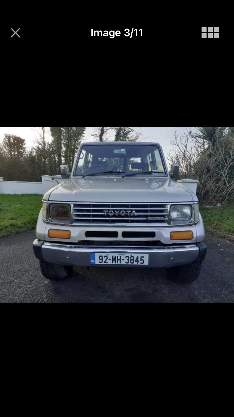

Hi, I’m completely new to Land Cruisers and have put a deposit down on a short wheel base 1992 Landcruiser Prado LX70. She’s gorgeous but needs a new exhaust, and a good bit of TLC in the inside. It’s up for €6,400 and wondering if that’s too much to pay for one? I’m told the price will go up and either way I will get my money back but Ive no idea if it’s a bargain or if I’m paying too much. I’ll have to oil up or change callipers and possibly get a new battery for it. There’s abit of rust but not severe, head light needs changing and the two seats have been taken out of the back. I think she’s pretty unique and a good project but I’m being told left right and centre to settle with a safe car
Hello,
The truck looks good but more pictures are necessary.
Check the frame, underside and drive train for rust. The picture shows what appear to be rust speckles below the grill. Make sure it is superficial.
Check for rust bubbling in the windscreen base and the door sills.
Remember: do not spend money you cannot afford to lose.
If there is no rust, the price looks good enough.

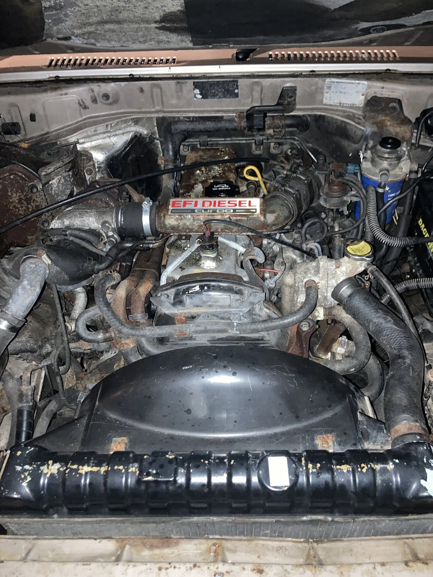

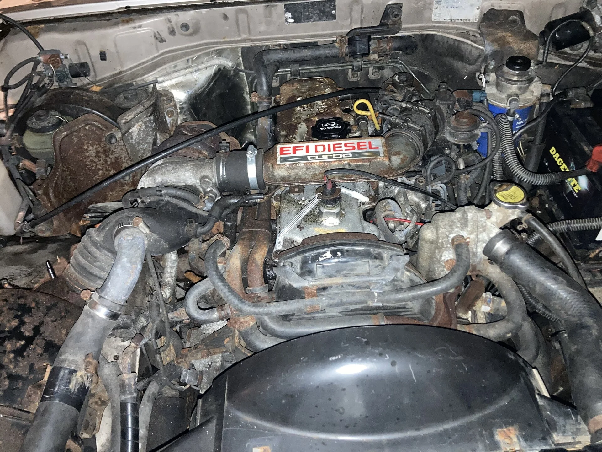

@Triona Congratulations! Likely your version of the Prado has a mechanical injection version engine called the 2LT-II. It has no EGR emissions equipment. The mechanical injection and lack of emissions makes it much more reliable and easier to work on. The more problematic engine everyone refers to is the 2LTE. If you post a picture of the engine I could confirm which you have.

Ok great, once I get the landcruiser I’ll take more photos ☺️ she’s a turbo engine but hopefully she is the one without the faults 🤞

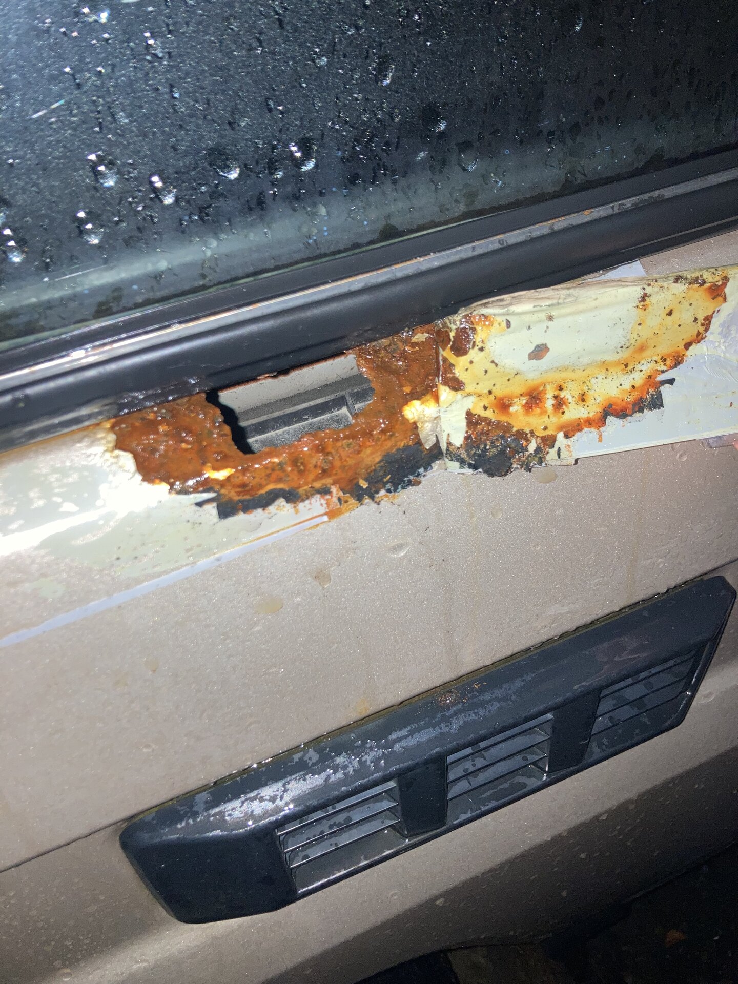

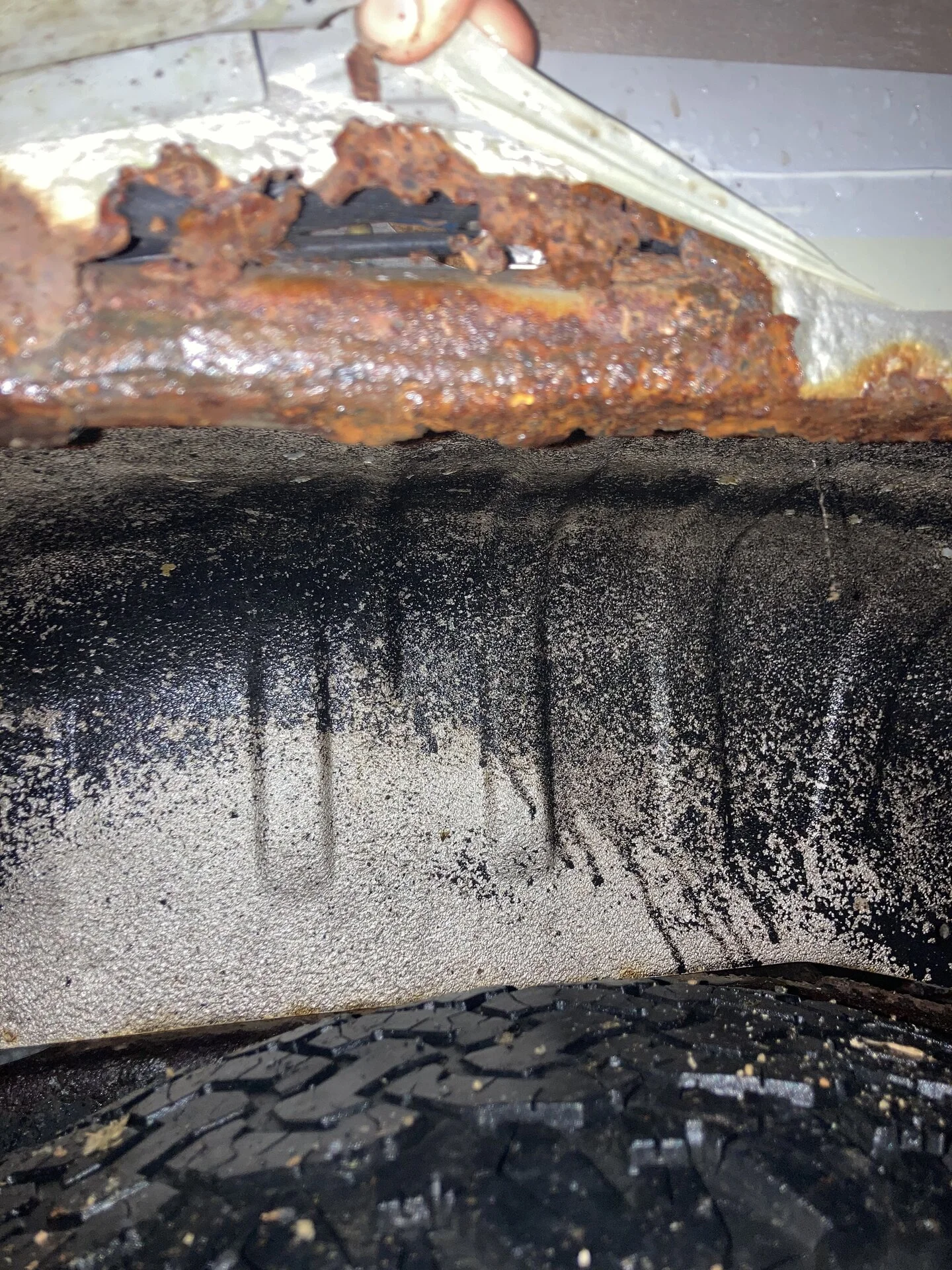

Update
There is abit of rust that is more severe than I thought…would welding sort this out? Thanks! Also @GTSSportCoupe here is the pic of the engine
