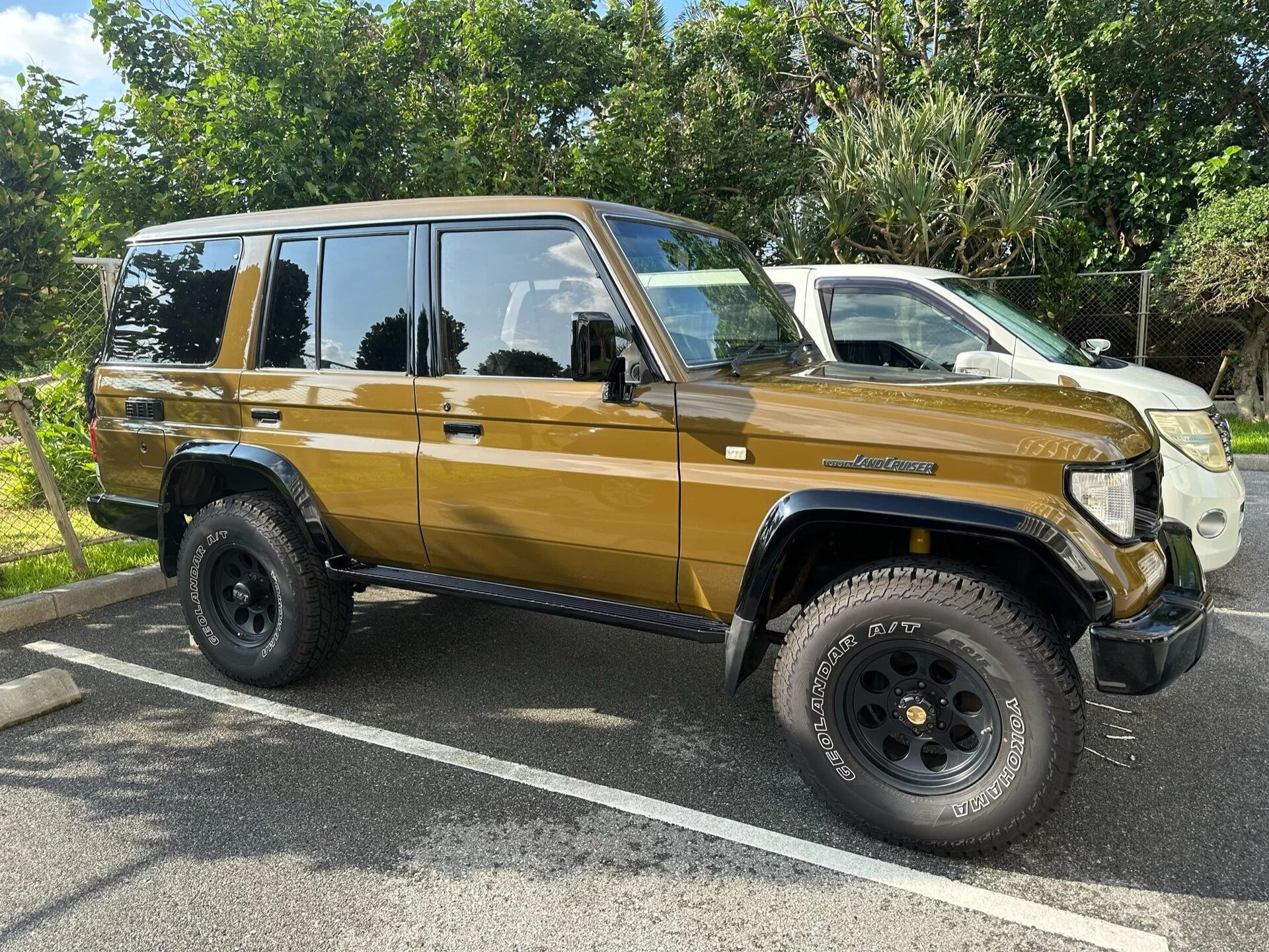

Hello Everyone,
Picked up this cruiser last week in Okinawa, I'll be here for another 2 and a half years so may as well ride in style. She's got north of 300k on her but runs like a top. Fresh paint and a new set of 31"s and M/T rims to top it off. Not gonna build it too much until I get back to the states. I've had Toyota's before in the states, but this one is my new pride and joy. Any feedback or ideas are welcome. If you're in Oki too lets get together sometime!
To do in Japan-
-Apple Carplay touchscreen head unit
-Eng-Tek diesel tuner - Does anyone know what the LED's mean? Left-most one just blinks green.
-3-way front speakers 4"
-Driver underseat sub
-Black steering wheel
-EGR delete kit [Vanlife] w/ pyrometer + clean intake manifold.
-Butterfly delete? Does anyone notice anything? I'm not sure if these have a dumb or smart EGR system.
-High flow thermostat + drill 3 small holes on outer edge.
-3" downpipe + exhaust, hard to find an exhaust shop to do this here.
-Boost gauge
-Vintage KC lights w/ Toyota covers
-Factory Brushguard - Does anyone have one for sale here?
-Figure out lighting for the dash - Dash lights work perfect, some of the switch lights are just burnt out I presume.
To do in US-
-120 series 1KZ-TE head
-Larger turbo
-35"s, regear?
-Rear e-locker
-Front axle refresh
-Tow hitch
Some pictures for your enjoyment!

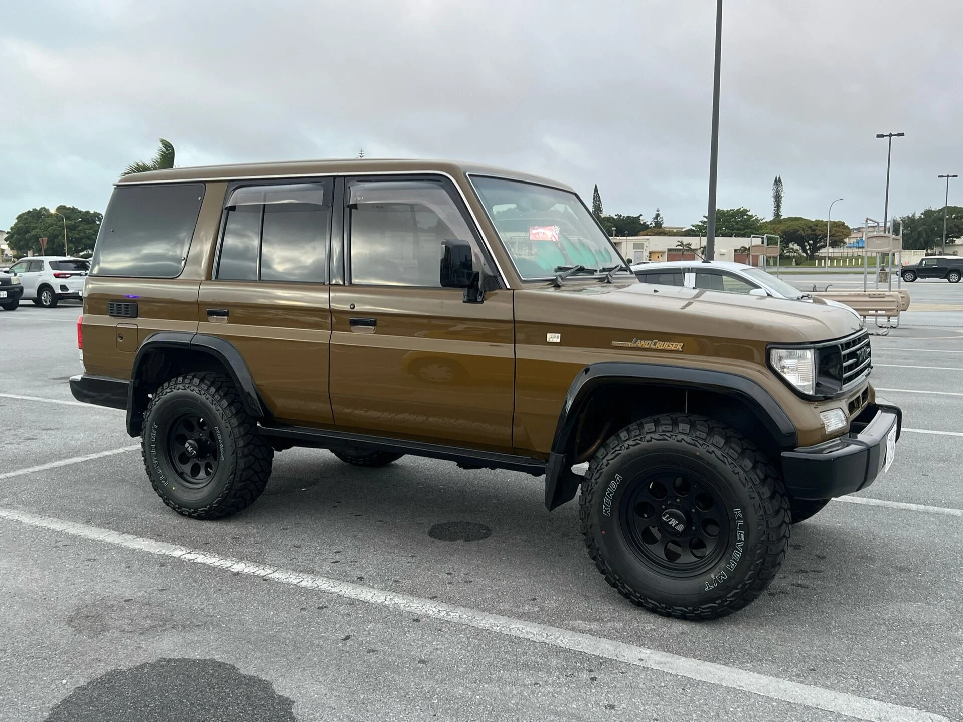

I know Kadena when I see it! And yes Dream Run was my go to as well! I feel like I stole mine since the frame was brand new! Do you have any idea what the color code is? How do you like the lift kit and what size are those tires! Looks beautiful! I think a gentleman by the name of Will Meredith can get you alot of parts like the center console and a bunch of other things from New Zealand if you need em'. I might go with stock height for now as I need to pass JCI in another 2 years. After that I'll be throwing a couple grand into it before I leave. Would you recommend Outcast? Sorry for all the questions lol!
Here's more recent pic with the Yokohama ATs I have on it now. I like them much better than the Kenda MTs that were on it. They are 285/70/16s I think. The guys at dream run called the color Mustard. I think the guy at Outcast Garage knows what code it is. He told me but I forgot to write it down. So far I like my experience with Outcast. It's owned by an American so no language barriers are a plus and as far as I know he's the only shop on island that specializes in Land Cruisers and if there's anything he can't do he knows who to go to.
