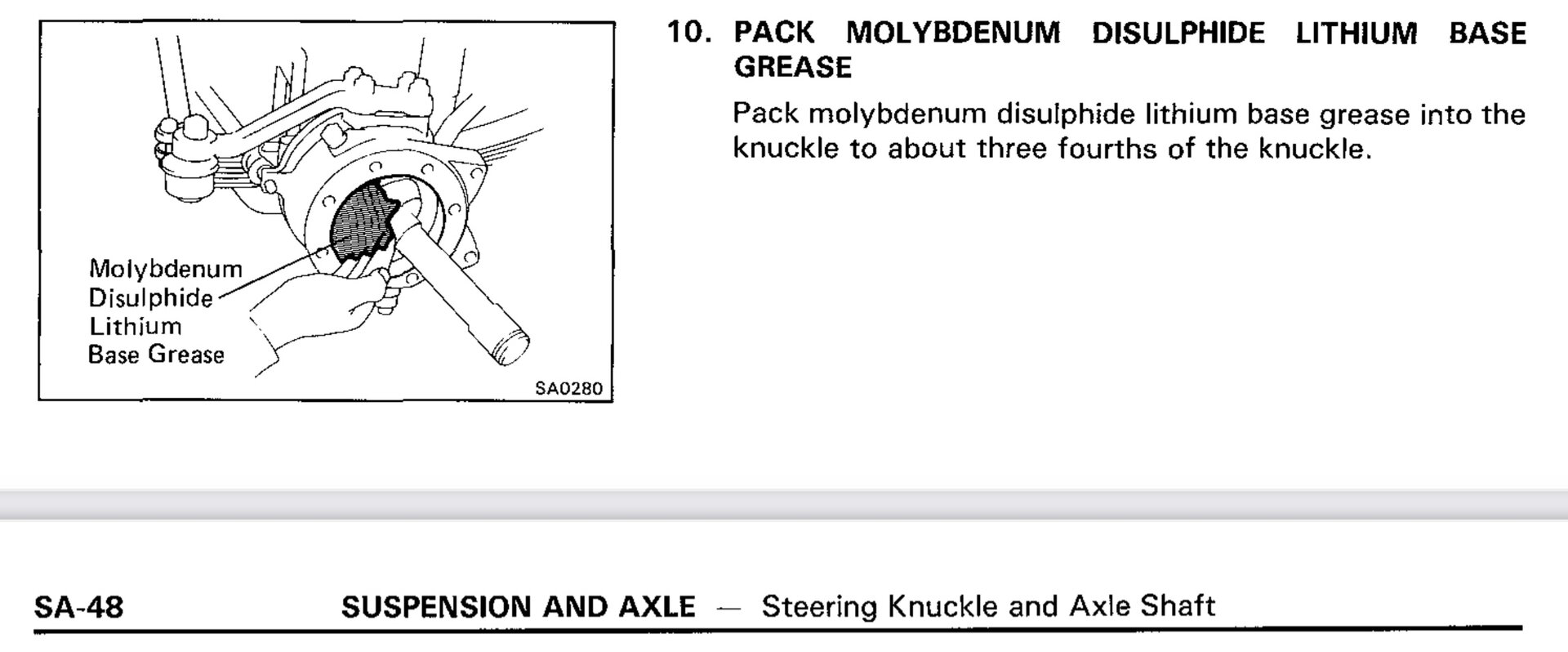

Last weekend I got this far using about 2/3 of a tube of grease;
  • CV/Birfield packing
  • Upper and lower knuckle bearing packing
The rest of the tube will go in the knuckle, and according to the Factory Service Manual it needs to be 3/4 full. It would have been nice if they said, “pump an additional 300g of grease into the knuckle.”, but 3/4 full it is 🤷‍♂️
I’m using Shell Rotella for my grease. It comes in 400g tubes. 1 lb = 454g for our non-Metric friends!
The CV takes up a lot of space in the knuckle, but I think I’ll need more grease than what’s left in the one tube. So, three tubes is my estimate … for both sides … for the CVs, knuckle bearings and knuckles.
I’ll tell you for sure by the end of next weekend :D

I used the rest of the tube of grease. It looks like I packed the knuckle full enough.
So, for one side, I used one 400g/14oz tube of lithium based moly grease (Shell Rotella SD) for the CV/birfield, knuckle bearings, and knuckle.
For the wheel bearings and hub, I used about 40% of a tube of red lithium based wheel bearing grease (Shell Rotella HD) for the one side.
