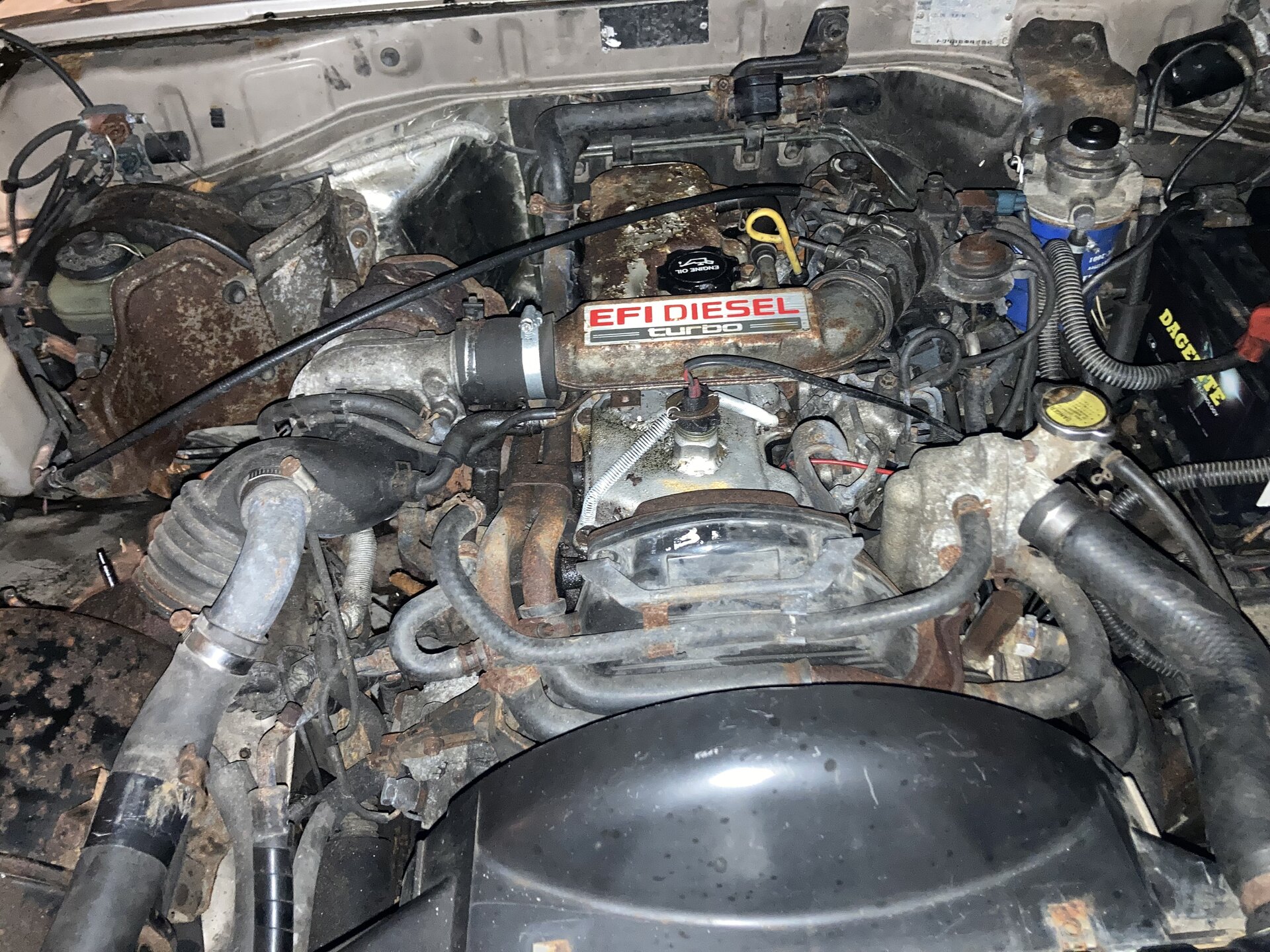

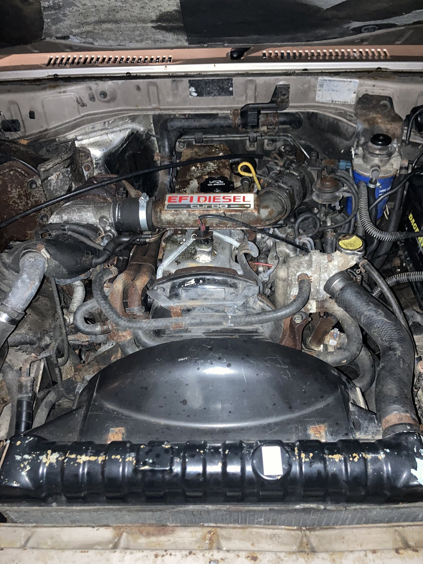

Hi, can you tell by looking at my engine whether it is a 2LT or a 2LTE ? Thanks

That’s a 2L-TE, the “EFI Diesel” sticker on the crossover pipe gives it away. Someone has made an odd modification on the valve cover too, I wonder what kind of sensor that is?
Yes, as mentioned above, that is a 2LTE. So this must be an imported from Japan model rather than Euro model.
Although your truck must have seen quite a bit of salt (road salt? ocean?) to be looking this way, it doesn't mean anything about the actual functionality of the motor. Maybe it's in good condition internally. How it starts is the biggest indicator of condition. Turn key to on, wait 8 seconds, then start. If it fires up easy and with little smoke first try, then compression is good, glow system good, and injection system in good shape with no leaks. If it takes lots of cranking, missfires for a bit with a ton of smoke, then there will be work to do.
The sensor noted on the valve cover is truly odd; not really sure about that. Take some close pictures and maybe someone can figure it out.
The radiator looks like it's been re-cored with the largest core I've ever seen. That is a really good thing!
A couple of the first changes I always recommend for these motors is remove EGR system and throttle plate, and install an 82C thermostat (found on all the later 2LTE models; is cooler than original 88C one). But also change oil, check glow system, air filter, fuel filter, rad hoses, etc.
