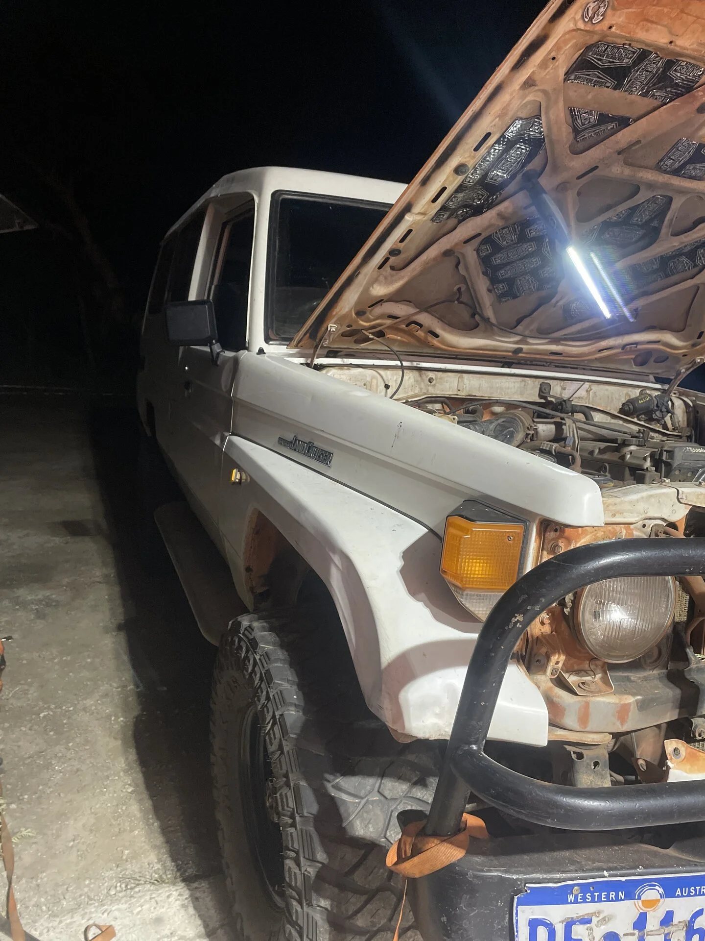

I just bought a panel beating kit and want to get familiar with how to use it, so I’m trying to test it on my banged up drivers guard. I just can’t figure out where these bolts are to remove the gaurd. It looks like there might be little tac welds holding it on, but not sure if I should drill them or not. Any help/tips/ideas on how to remove this stupid gaurd
there are a couple ways to remove it, lots of bolts, no spot welds.
one way is to remove the whole upper/lower/inner as one unit. there are bolts in the radiator support, the upper firewall and lower firewall.
the other way is to remove just the lower fender itself, there are a bunch of bolts that run around the entire inner fender.
Do I need to remove the liner in order to remove the gaurd?
You can remove all 3 pieces together, or two pieces or one piece. Depends on what you need to get to. There’s two bolts at the bottom of the A pillar, one bolt mid height on the A pillar that you get to by opening the front door, the rest are easily identified. Small hands work best.
