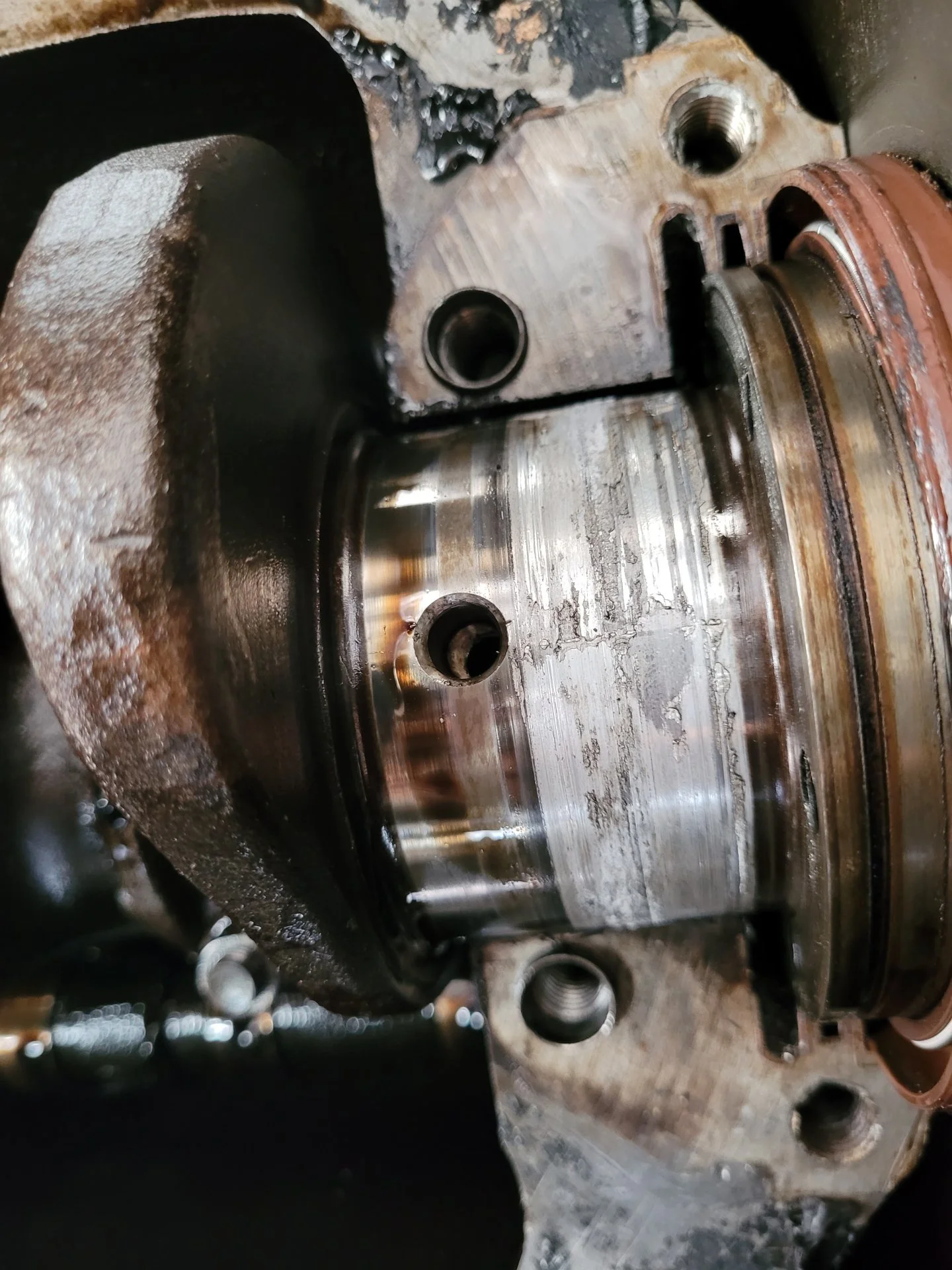

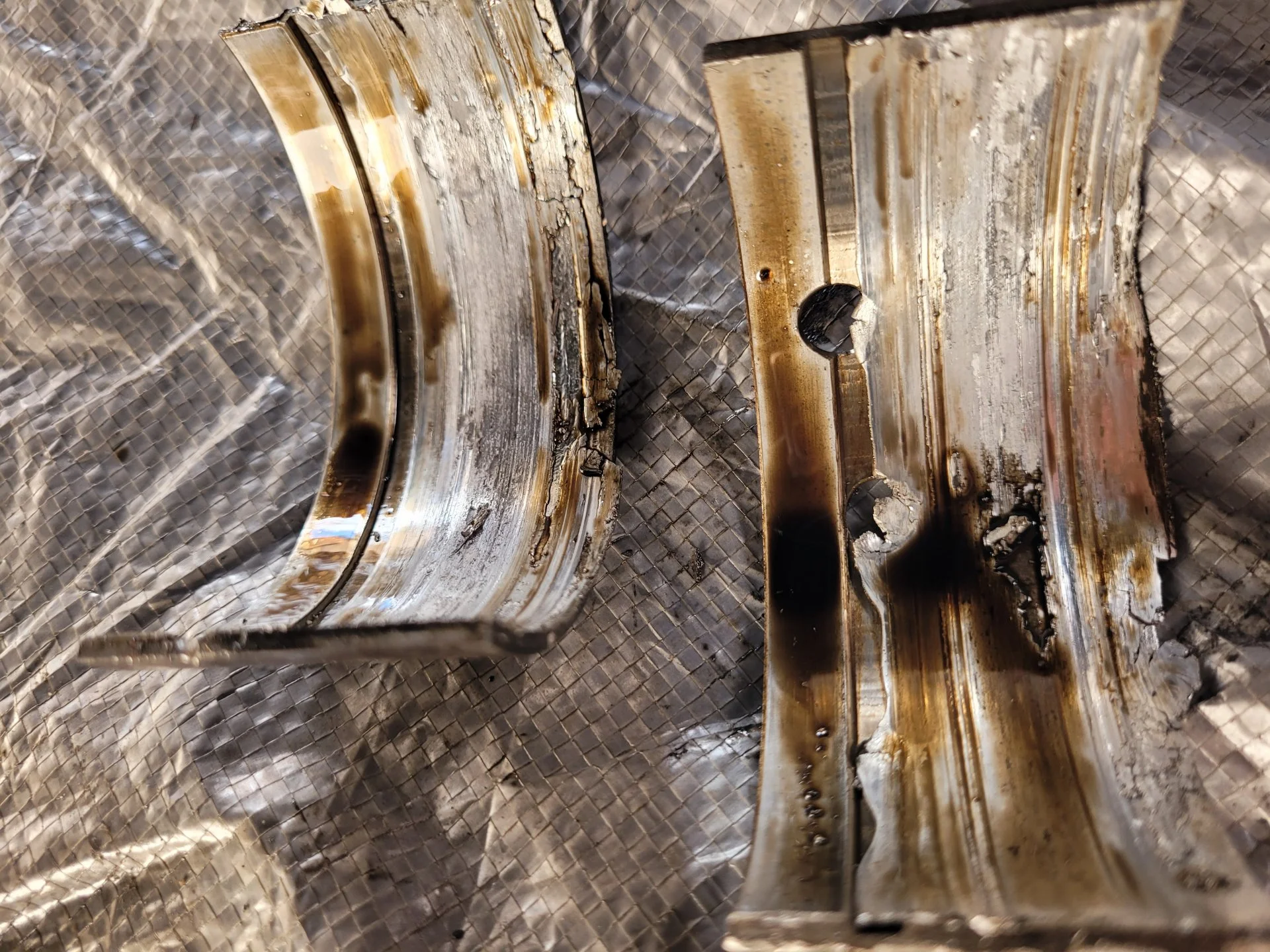

Well, back to the problem at hand for a second. Here are the bearings and crank. Bearing metal is fused to the crank and I can feel scratches with my fingernail. On the good side, the part where the oil is delivered is still smooth mirror.
You tell me but I'm guessing the temp "bandaid" smooth by hand, and and slap new bearings in makes less sense? Or is this typical and still an option?

  • Turn the crank, maybe only the main journals
  • Replace the rod and main bearings (oversized at least on the mains)
  • Consider rings (if ridge isn’t too bad)
  • Do a valve job
  • New gaskets/seals
  • Reassemble
  • Reinstall (you just did the pilot bearing, right?)
Run it for the next decade in peace knowing it’s done.
