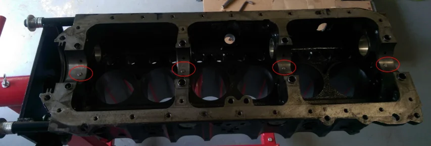

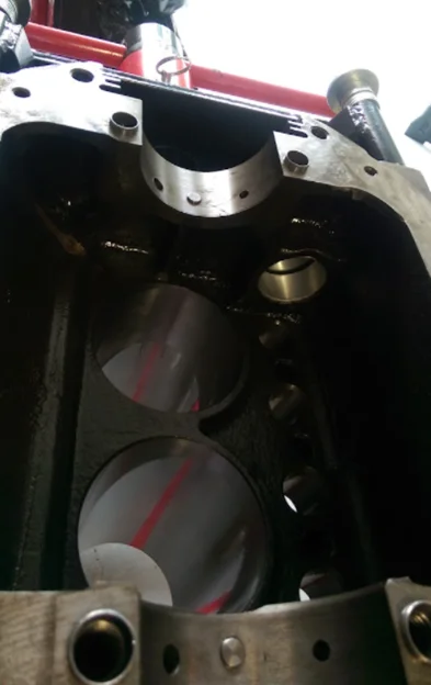

Per Gonzo, figured pics might help, from my 1970 FJ40 1F engine
Those definitely look like dowels!
Question, you were able to get the old, upper half of the main bearing out? I do not understand how - unless it was just completely mangled from having spun...
Thanks for the pics MudDauber. That's 100% what it is. I was able to get the top one out. It scraped as it came around and is dented from the dowel a bit, but It's out. What I don't understand is how anyone is able to slide bearings in around the crank with those dowels on all four crank bearing locations. Seems like the only way to get those in is with the crank out.
