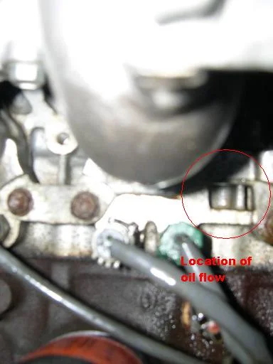

I look under in the hood in the area of the oil filter and see oil streaming out of the engine. It seems to be coming from the engine, between cyl. 3 and 4, near the bottom of the air intake manifold. I've got pics of the location (circled in red) and an action shot.

The oil filter is OK and not leaking. The gushing oil is coming from above the filter, slightly to the right. This picture better illustrates the location of the filter to the leak (flow).

First I would get rid of the Fram oil filter. There is no High pressure oil galleys where you indicate. There is a drain galley in that area for the oil to return from the head. But the oil would seep out the head gasket area(Unless there was a hole in the head). The next above is the valve cover, oil could go out if the seal is bad or cut, it would not have high pressure but could have more than flow with Crankcase pressure behind it. Your screw could be bouncing around, you will have to look under the VC. Maybe why you think it is comeing form this area is the filter is spraying the oil into this area( sligth cut on seal or some thing)Try another filter. good luck robbie
Holy oil gusher man! There is no cover on that spot on my truck, so there has to be an oil galley plug or crack into an oil pressure galley in that cavity to pump that much oil? Tuff spot to see, IdahoDoug is pulling his head, maybe he can have a look? Hope you didn't hurt the motor running it with no oil pressure.
Maybe the bolt got pinched between a cam lobe and the head poking a hole that is draining the cam area? That's a big gusher for a nonpressure leak.

you sure it's coming out of that rectangular hole? one photo makes it look like it's coming from higher than that I think.
Agreed.
-B-
I just went and looked at a loose head, there is nothing under that rectangular hole in the intake, just cast aluminum of the head, no ports plugs or sensors.
If it is coming from the head you have a broken head.
Could possibly be coming from above and that is the path out it.
First thing I would do is pull the valve cover and take a look at the head in that area.

maybe it's spirting up out of the top of that filter.
That's my thought but I believe that would be pretty easy to spot when he was taking the picture. Also, if you look at the location of the filter, the sensor with the green connector, and the location of the leak; it would appear that sensor would be covered in oil if it was coming up from the filter, toward the rectangular indentation on the head.
