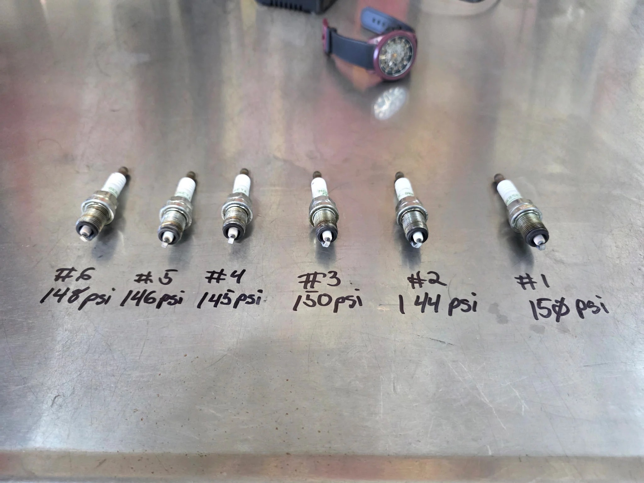

The shop linked to my daughter's business looked at it today and got these cold engine pressure readings which they thought were completely consistent with my prior reading. Importantly they saw no signs of excess oil on the plugs or other sources of concern with a borescope.
He also noted that the oil level in the engine was completely full and thought the change to Delo XSP 15w-40 was a good idea. (Kernal's suggestion).
So, he will have her drive the car and check the oil levels over the next 250-1000 miles and see what happens.
