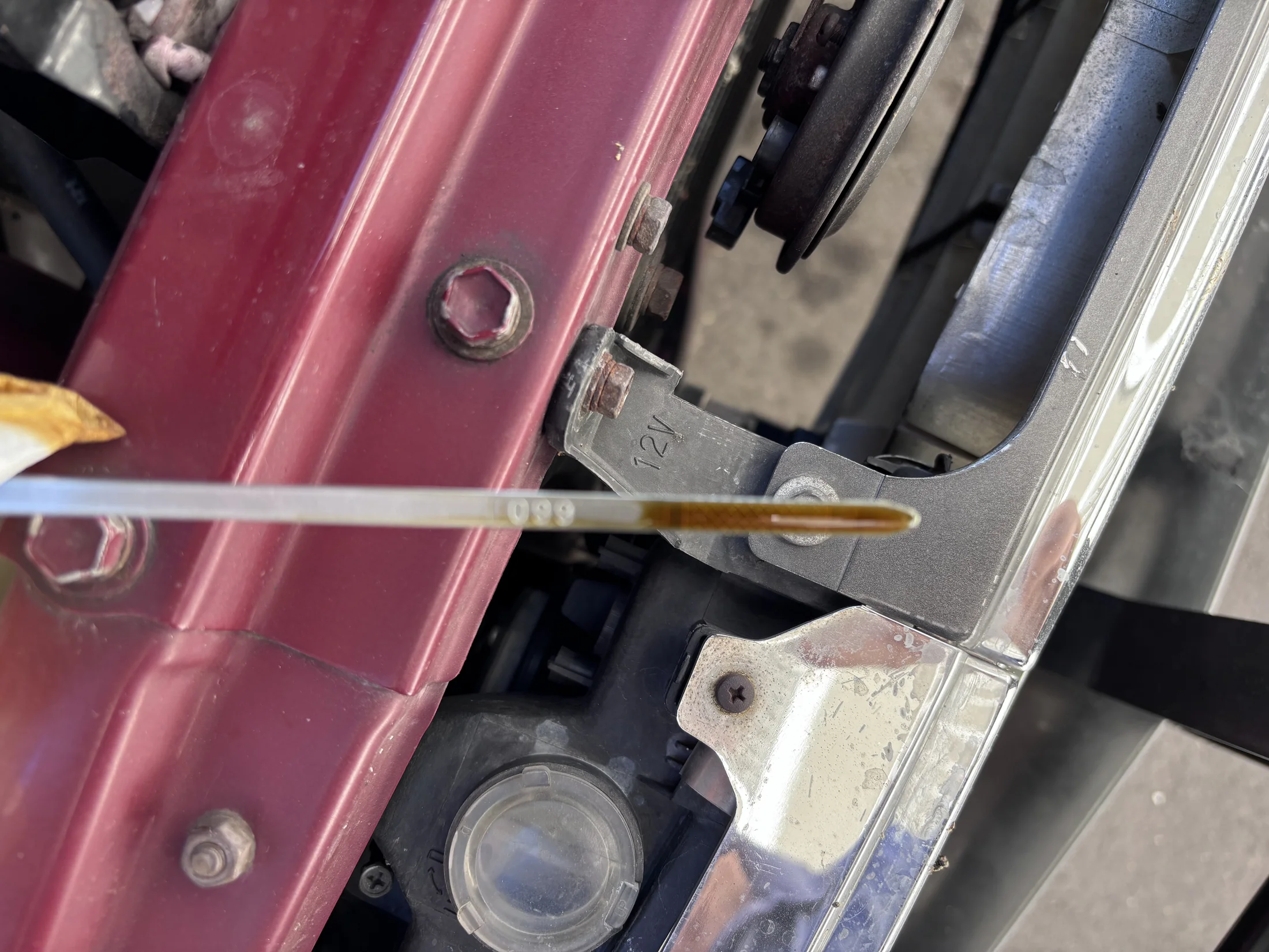

Each fill was too the full mark, but I would not call conditions ideal an I clearly missed @511 miles
@551 miles and on a level spot and fully cooled it is clear I over shot adding a quart. The oil looks free of coolant. Looking at the coolant the level is what I expect but I perceive a slightly cloudy red versus the fresh jug of diluted coolant I carried as spare. Not certain.

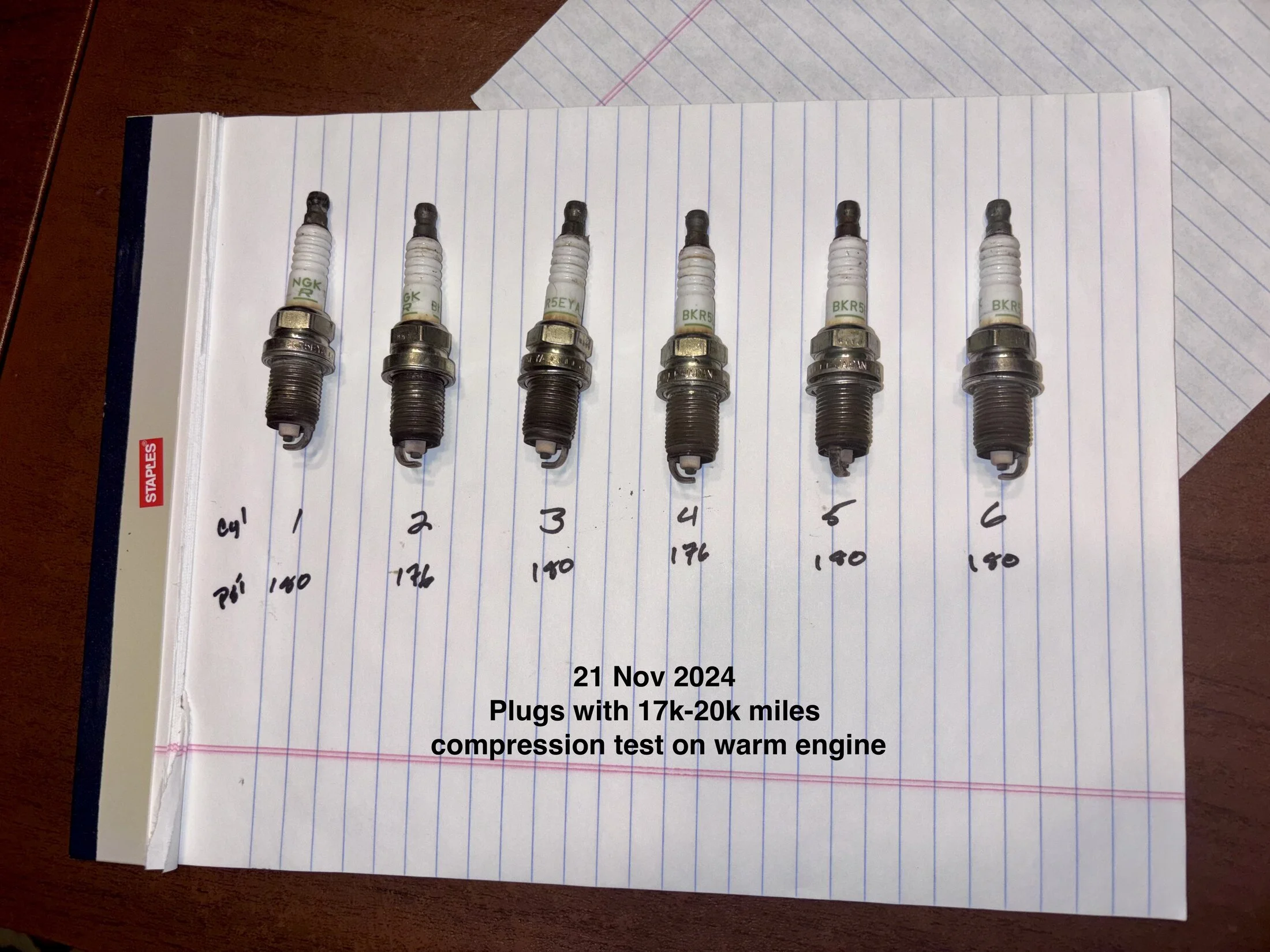

Spark plug and compression readings in Nov. 24 – 20k miles on the plugs. Engine was warm an hour or so after a trip.
