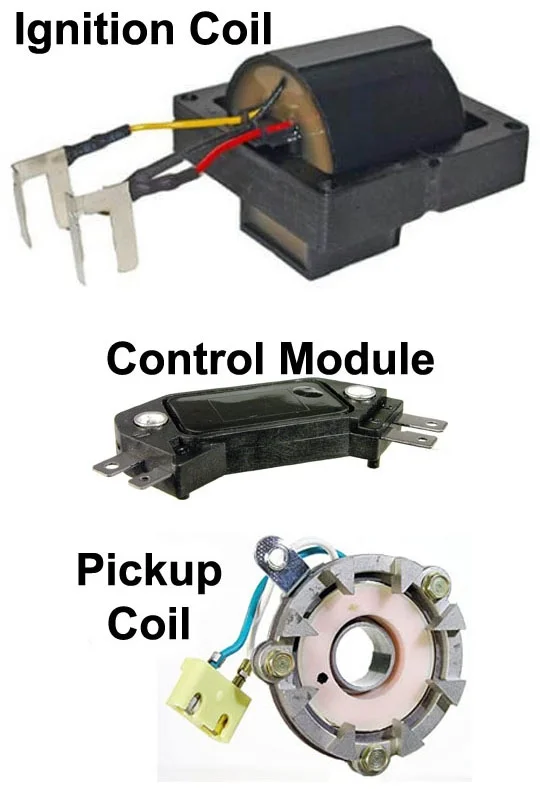

The three major electrical parts to the HEI or DUI are easy to find at local parts store & online. There are plenty of YouTube vids on diagnosing and parts replacement.
“Performance Distributors” may be a place to check out for testing tips or a replacement if you choose to stay with that type.
"TIPS" - "REPLACEMENT"
