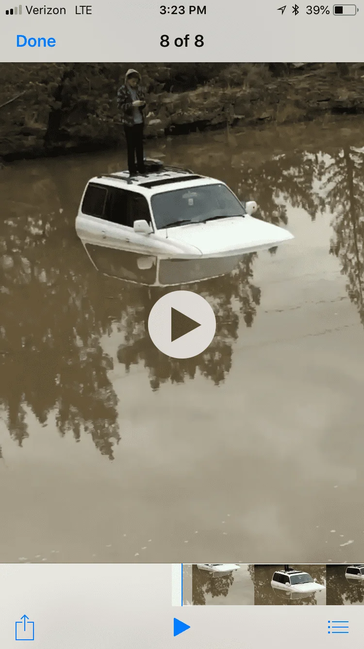

So last week my twin 16 year old boys decided to take my 1992 fj80(259k miles) for a swim through a huge pond/small lake and got her stuck in the middle. She sat there for a couple hours before we could get her out. Water was up to about the door handles.
