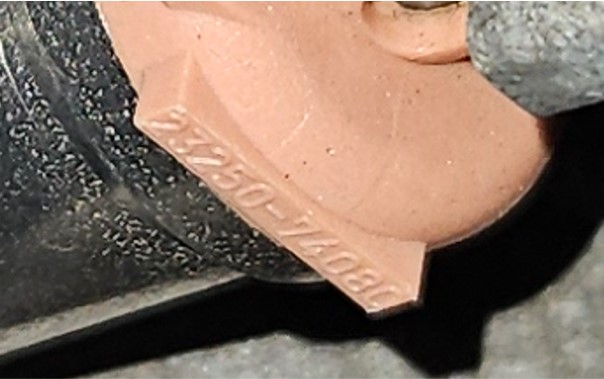

Confirmed my injectors are p/n 23250-74080, which appears to be a stock 1FZ injector, but the p/n on Amayama is 23209-74080. Are they the same injector, but what I have are aftermarket Densos?

Ok, but that's the number on the injector. I'll upload a picture I took yesterday whenever the site allows picture uploads again.

Here's the pic (finally). It appears it's actually a Chinese knockoff. 👎
23250 is the injector which that picture delineates.
23209 is the kit that comes with the injector, grommet and o-ring.
There is no way you can know that injector is Chinese without removing it and inspecting other things.
