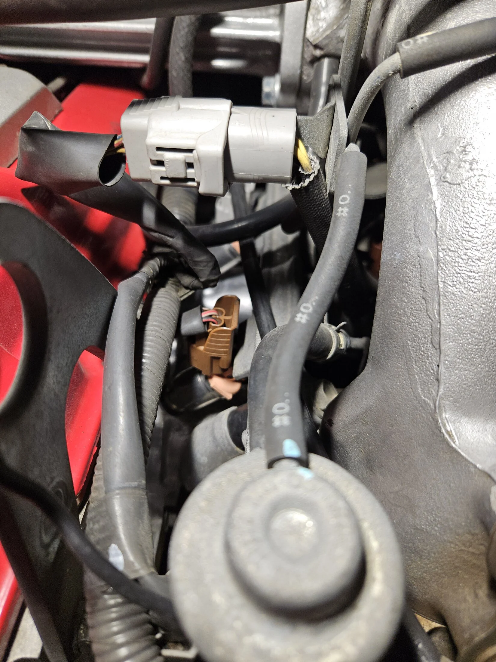

I’ve had pressure for years with my TRD SC. When I’d get out of the truck in the summer you could smell something like kerosene from under the hood. Stumbled onto the problem a year or so ago and haven’t smelled it since.
There’s a vacuum hose that connects to the EVAP system that runs from the front of the engine to the back along the fuel rail. Just before the intake opening there is a small T hose that plugs into an orange plastic valve and then there is a second small T after the intake opening and it plugs into the intake.
Both small T hoses looked to be a formed elbow and when checked the elbows had kinked and collapsed. This basically disables the EVAP system.
Once I replaced the hose thins have been fine.
This is likely the issue with all the charcoal canister problems as well. Not just SC trucks.

I had the orange and black valve mentioned up in the other post damaged replaced it and tank pressure went away.
