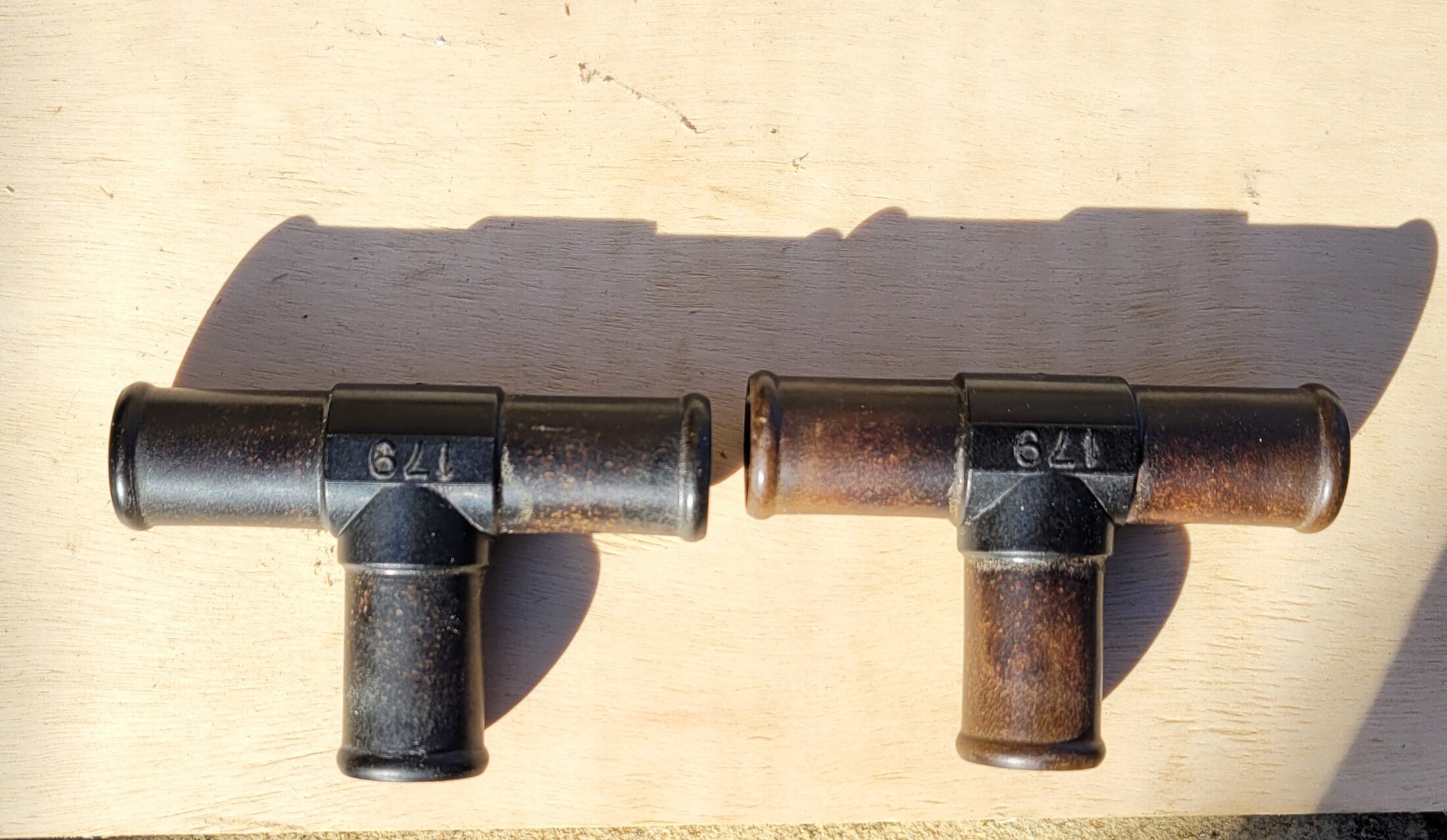

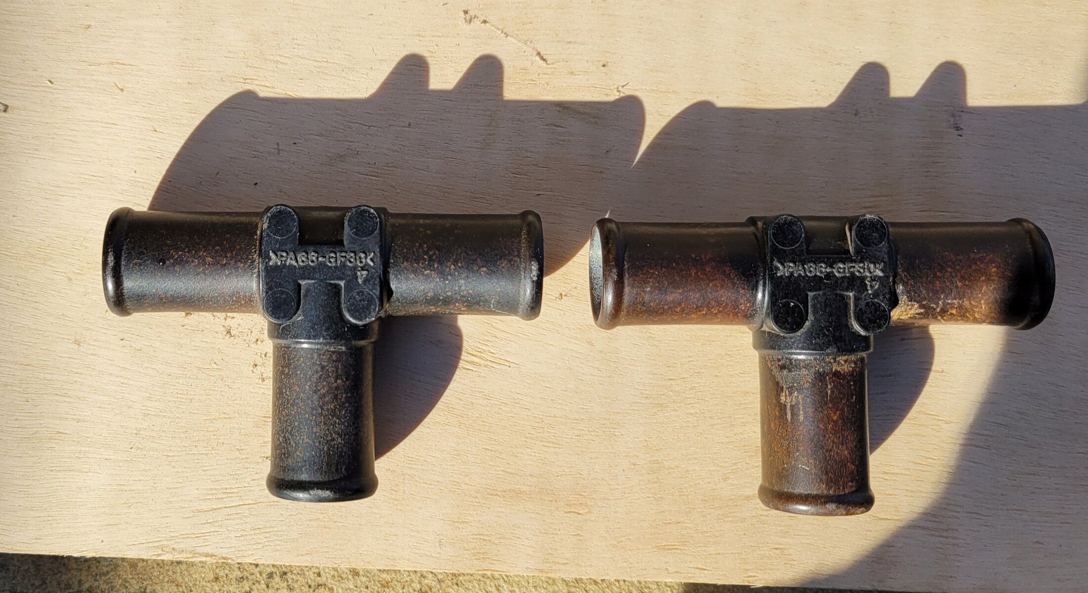

Hi Folks. A reminder to change the two heater hose T-pieces on the 200 Series with the 2UZ-FE engines.
Changing the T-pieces on the 100 Series Cruisers with the 2UZ-FE engines is well document, not so much for the 200 Series.
If the T-pieces are nearing 10 years old change them asap. It may just help you avoid very expensive engine rebuilds and a lot of tears.
I change my 2009 200 series T-pieces a few days back at 211,000km and just in time.
The plastic was already going brown and brittle and most notably a crack had already formed in one of the T's.
It's a quick easy job, maybe 30 min or so.

I’m not saying not to check these, and even to do them as PM. But mine are factory-perfect at 200k miles. I’d really like to figure out why some clearly degrade, and others don’t.
When I initially removed them they also looked shinny black and near perfect. Only once they dried out on the workbench for a day or two did I notice the brown discoloration and decay. The hairline crack I also only saw when I took them outside in the sunlight and closely inspected them.
One of them was noticeably in worse shape than the other, maybe it was on the hotter heater inlet line ?
Great point about them drying out. I’ll exchange mine before a trip in a few weeks and let the originals dry to see if they do the same.
