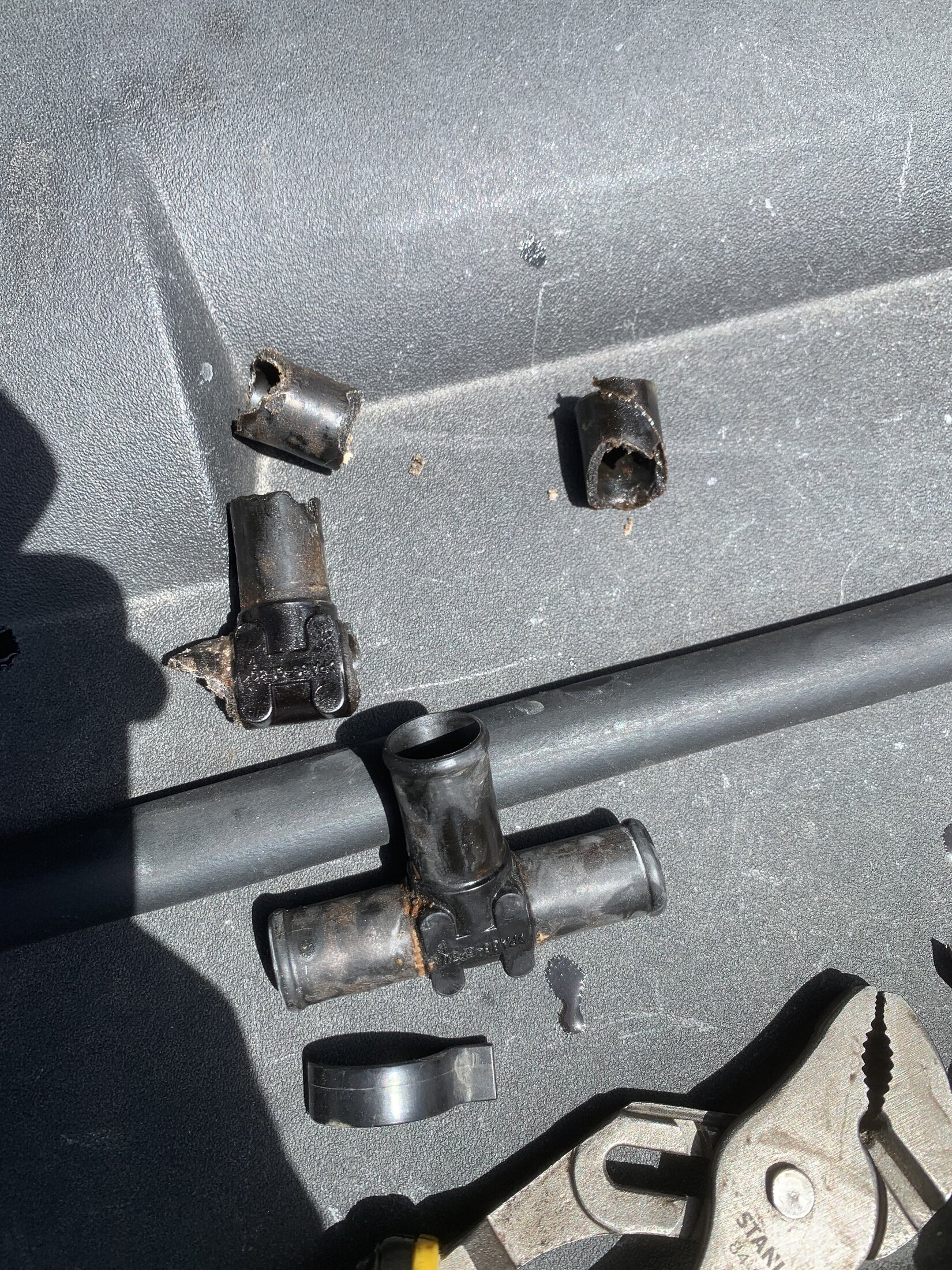

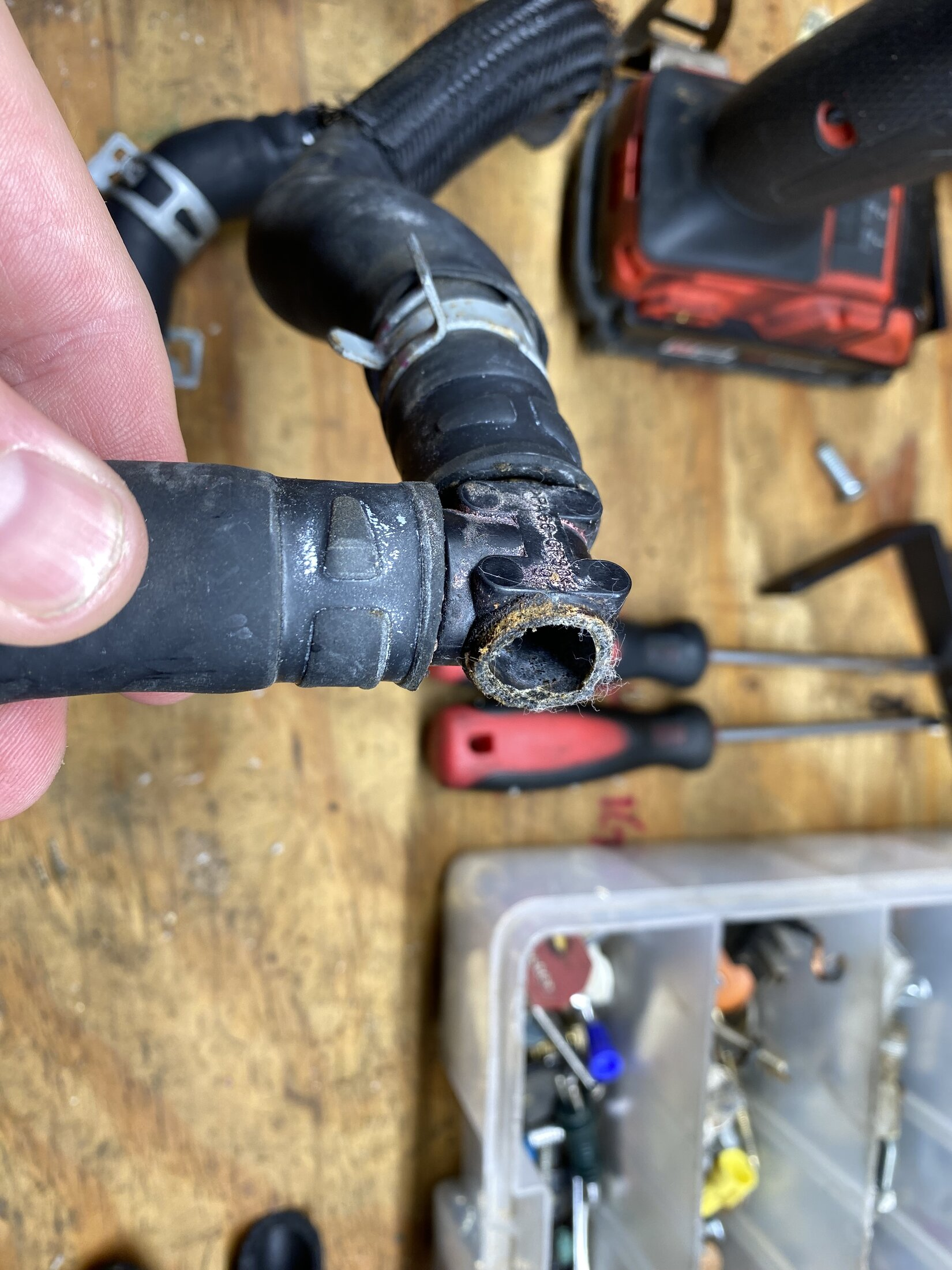

Had my lower/hot tee fail recently. Found the leak today. It’s been a bit, the coolant level is down a bit and the skids are cleaner than normal.
Had the dorman part already for long ago. It’s 16mm. The stock tee is 17mm. Probably why the dorman tees tend to leak.
Ordering the new hose set and will put those in when I receive them.
Lower tee disintegrated on removal, leaving parts in the hose. Upper tee looks fine still.

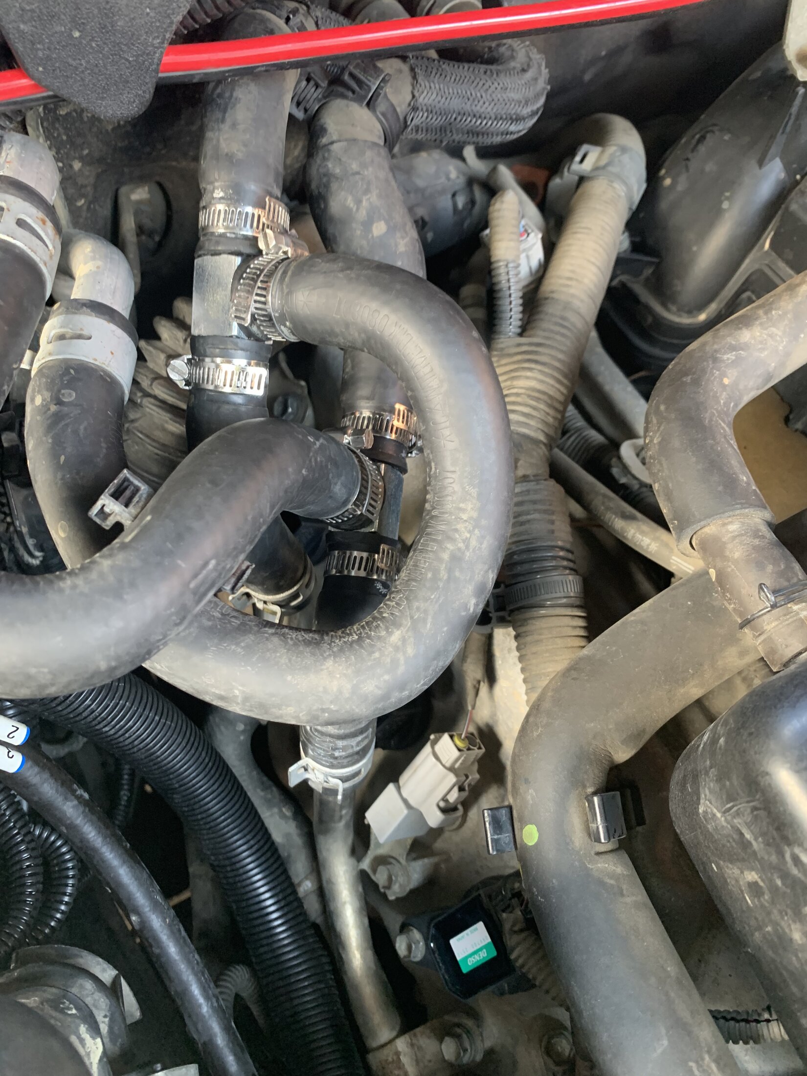

Put screw clamps on at lunch, don’t think it’s leaking anymore with the metal tees. Still need a couple quarts of SLLC and time to make sure.

i installed the mixed year parts and new clamps I ordered. A couple of the paint marks didn’t match up, functionally they look just fine.
No leaks during the around the neighborhood pleasure cruise.
Will watch it for a bit.
Dorman metal tees back in the emergency kit, now along with six screw clamps.
