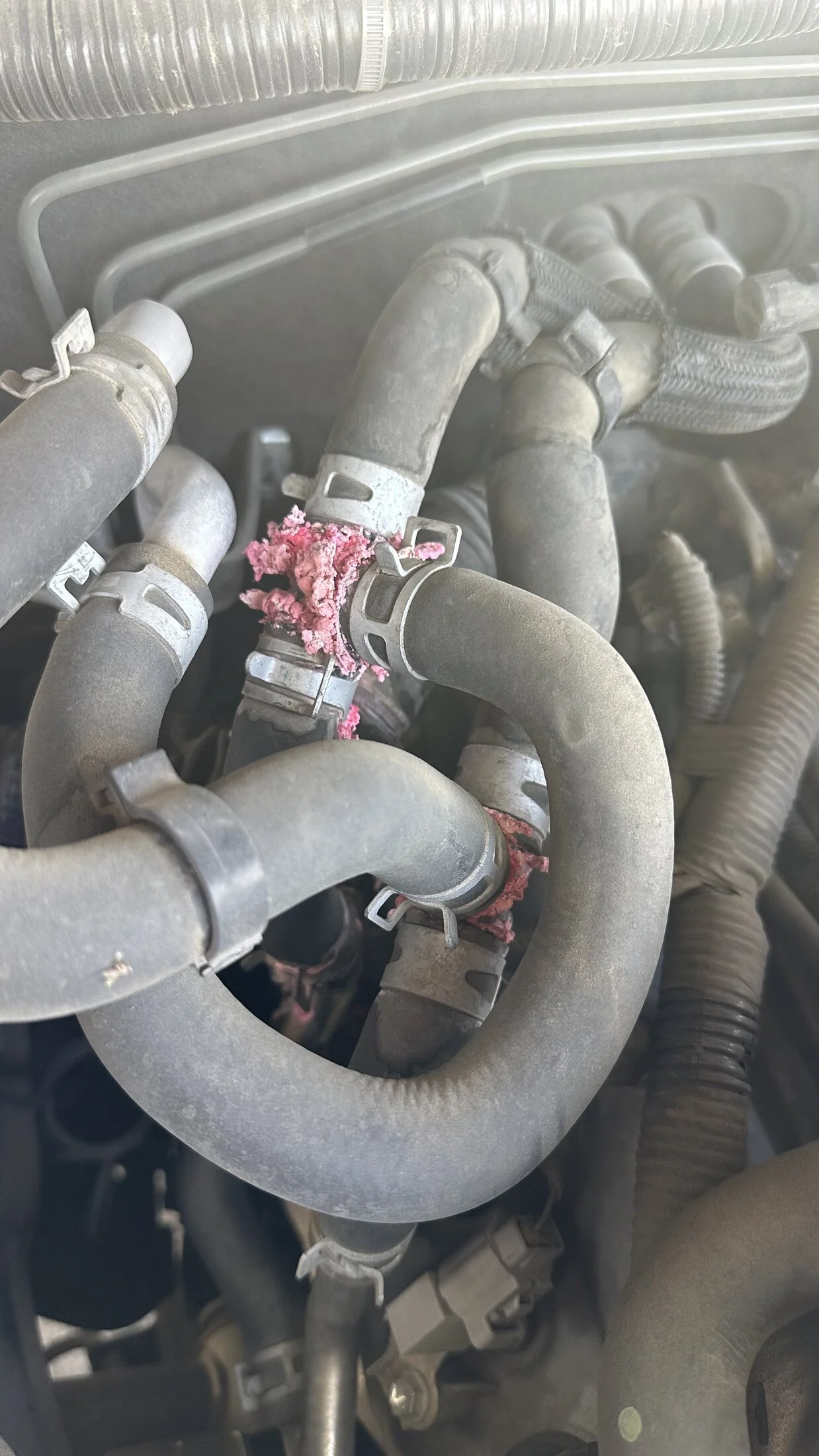

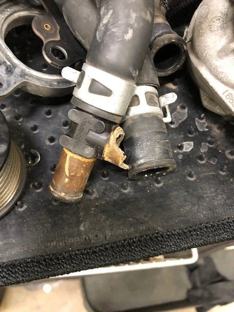

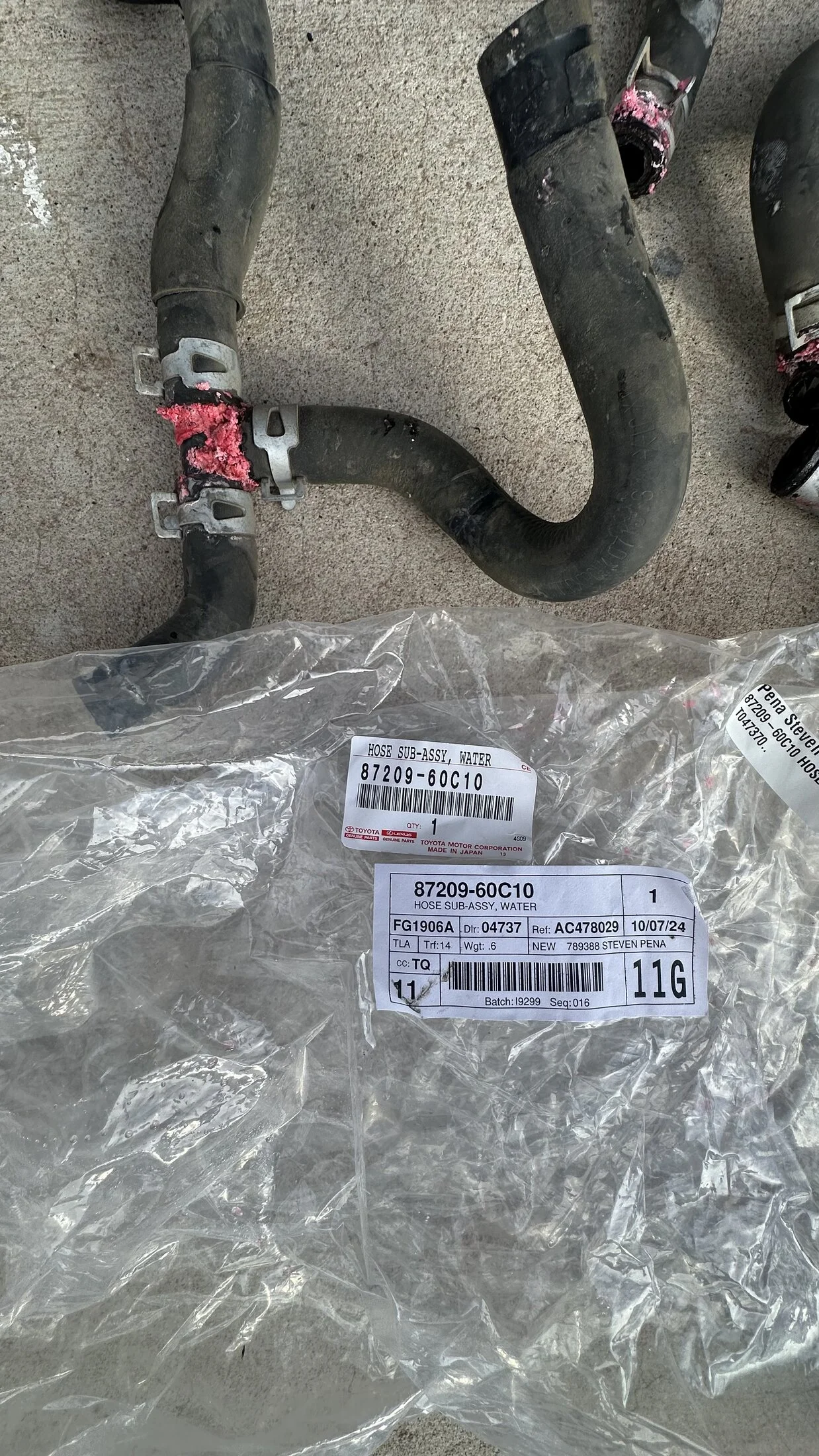

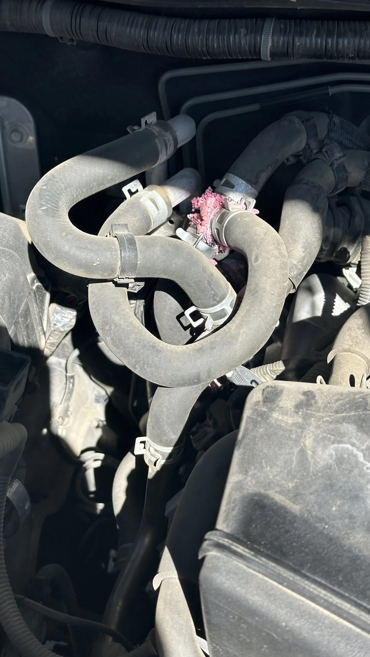

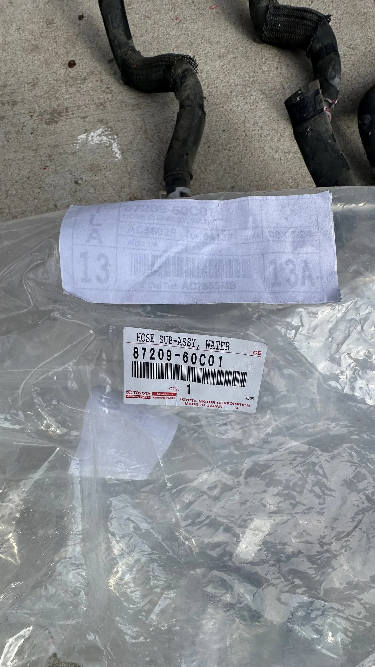

Recently noticed the heater hoses leaking on my 200. Not sure if anyone has posted about this issue. Since these trucks are getting up there in age, this might be a more frequent problem. Here’s a couple pictures I snapped and part numbers.
Part # 87209-60C10
Part # 87209- 60C01
Did you also replace the T connectors? There are a number of posts on here about doing that.

I purchased the whole assembly.
They come with new t’s already assembled.
do these go back to do age, or heat, or a typical 200 series problem?
It appears to be a problem with LC200's before the model year 2013 vehicles. Part number and material of construction were changed for the model year 2013 vehicles and beyond.
The complete hose/T sets evidently ALL include the upgraded/newer T's, but some/most? of the replacement T's purchased separately still have the old T's with the material which is more prone to failure.
TL;DR: If you have a MY 2013 or newer LC200 this is not an issue.
HTH
HTH
Appreciate it

I just bought the two sets for my 2008 as it is also doing what this one did, but I guess I need some new curved water hose clamp pliers to get at the two on the firewall as they are underneath and my regular water pump pliers are not curved the right way to get in there. What did you use?
