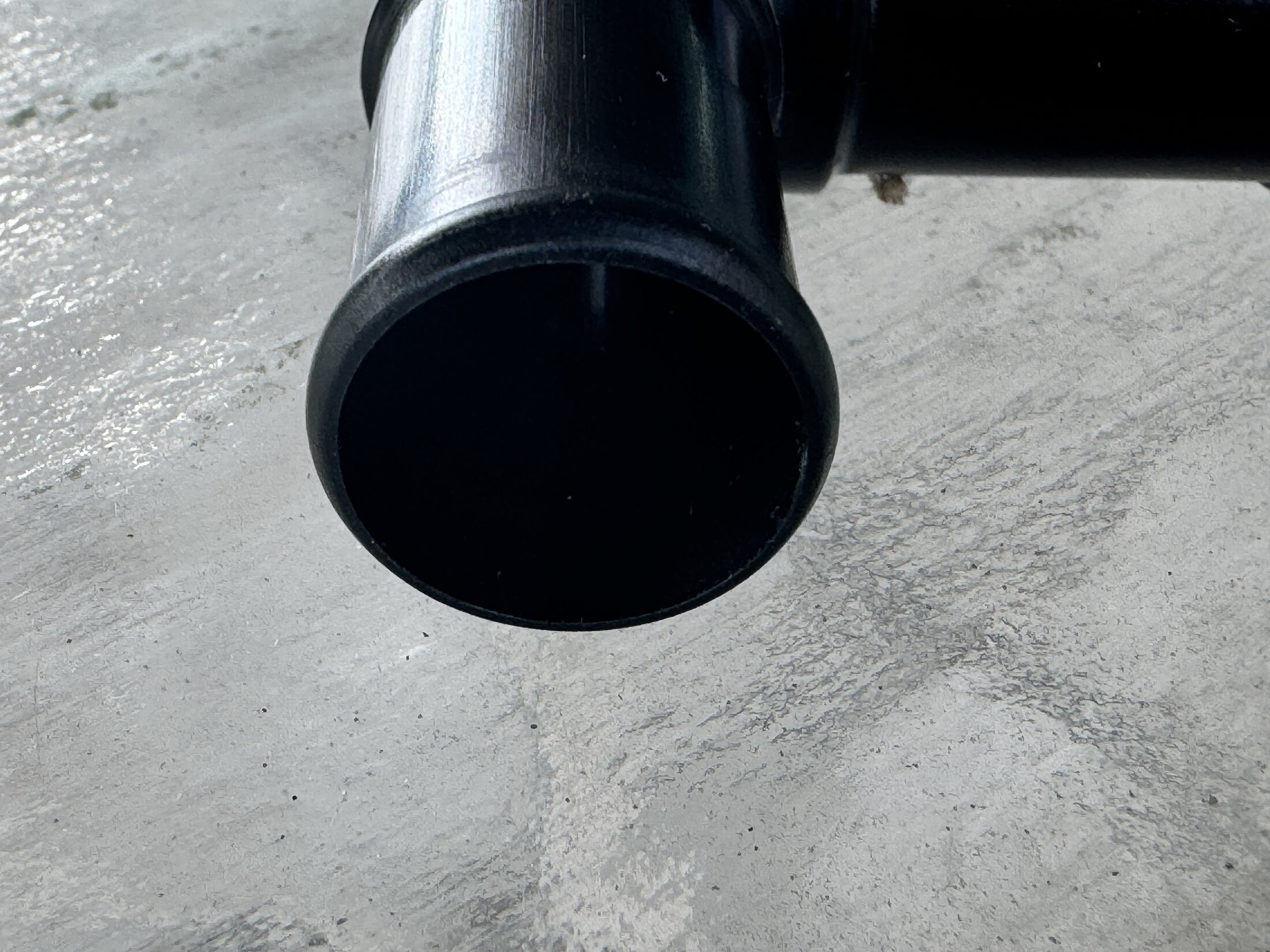

I rinsed the coolant off then let them sit for a few days to dry. These are 200k mile T’s from a 2013 landcruiser, and they are basically factory-perfect.
Again, I’d like to know why some are flawless and others fail.

Looks like the 2013's came with the updated T's stamped with the markings referenced by gaijin. The 2008/9 T's have different markings. May have something to do with longevity.

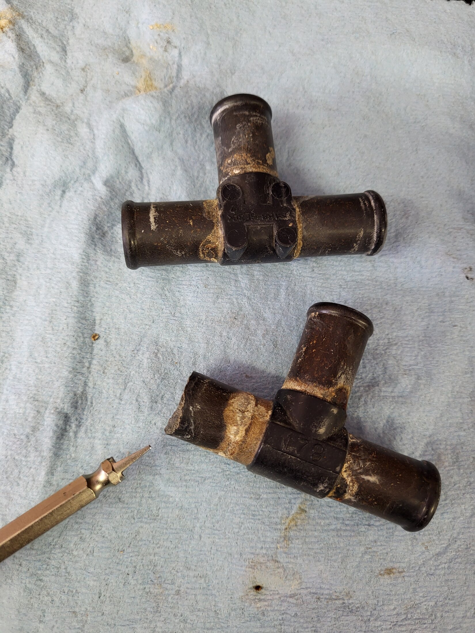

At only 160k miles on my 2010 LC, I was expecting the tees to be in fine shape still. However, one started to fall apart upon removal, with one of the flanged ends breaking off inside the hose. This was the lower tee, closer to the engine, flange facing the firewall.
Looks like I was justified in replacing them.

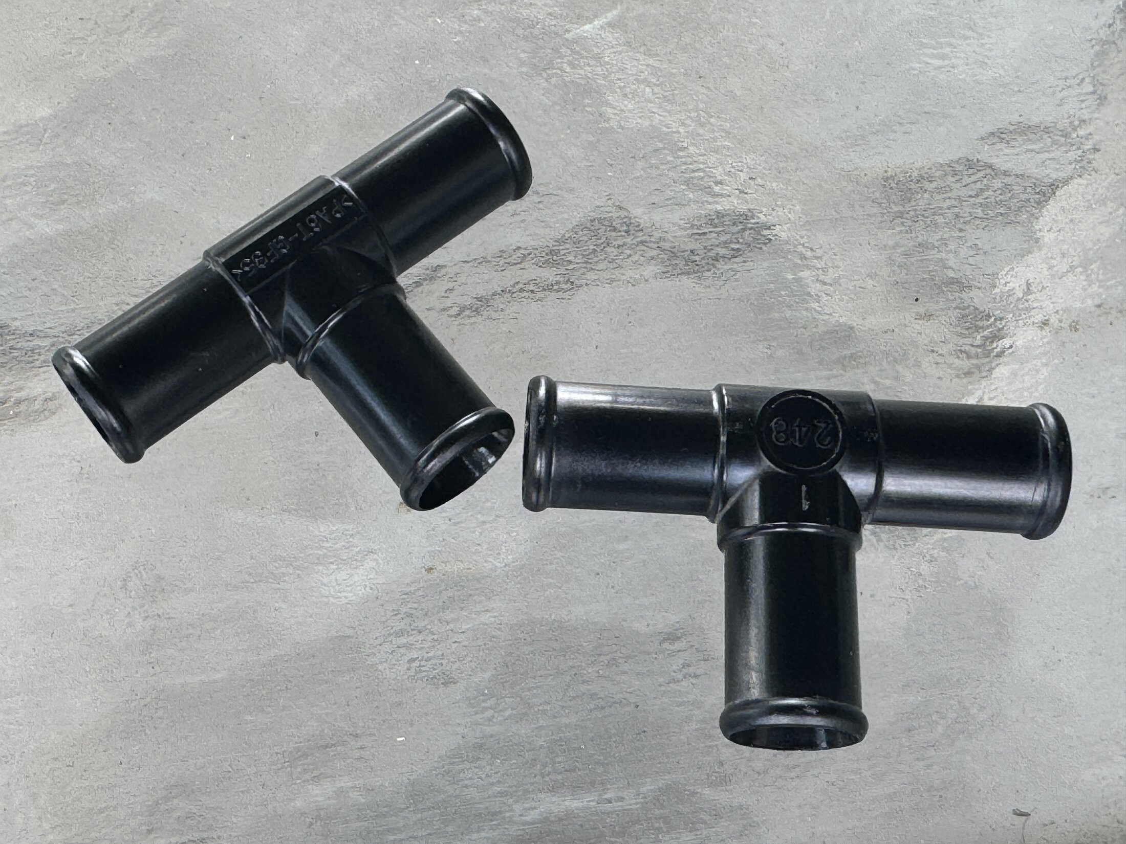

2013 URJ200L
04/12 Production Date
50,000 miles JUL 2024
Both "T"s are the revised PA6T-GF35 - factory installed
Still on the factory fill Toyota Pink SLLC
In situ pic:
Are there any recorded incidents of these revised T's failing? I couldn't find any...
