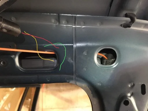

So I got back to this today, working on the two rear drain hoses. I was nervous about pulling them out because I wasn't sure I'd be able to route the new tubing back the same way - quite the tortuous path - and wasn't even sure which tubing to use. Still, I could feel the flattening of the hose as it dropped into the C pillar so pulled out the passenger side:
I had some 5/8" heater hose so figured I'd try it as @Surfdc did. It was really tough to route from top-bottom or bottom-top until I decided to go first with some trimmer line to help. Still, it was a pain to figure out which opening to go up from.
At this point I was getting excited because I could now pull the heater hose out up at the top...but that's where I got stuck. It was simply too thick and the 's' path to get from the rectangle-shaped window up to the drain nipple was too sharp. The plastic nipple itself was also brittle and I could break off the tip with a fingernail (but also about 40F outside).
I tried using an insert of the old hose (which also has an ID of 5/8" but much thinner walled) but while it could attach to the drain, the turn collapses it which is what I'm trying to solve in the first place.
So, any ideas? As you can see in the picture below, the yellow is the existing path I'm trying to follow. In the medical device world, there are some very thin-walled tubes that are super puncture resistant and would work great here...I even considered doing a large spiral loop with some tubing to decrease the sharpness of the turn but don't know how much room there is behind the headliner for that.
Or am I stuck having to widen that opening (green line) so I can follow the red-line path? And if so, would tin snips cut it? Besides filing/smoothing the cut, should I coat it in anything? I'd like to avoid cutting if I have to but also need to put all this back together so appreciate any suggestions.

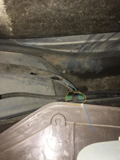

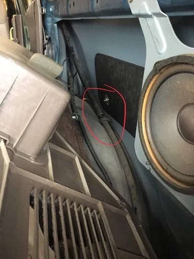

Couple more pictures to help anyone doing this in the future:
Watch out for that clip when removing:
Rubber grommet down there that the hose exits through:
Your almost there!
Yes, I would definitely cut where you have the green line. That is what I did. Then I lined the cut area with some door trim I had lying around. This cut is vital because it allows the thicker hose to pass through AND it relieves the stupid uphill “S” curve.
Also, heater hose seems to have a natural curve to it, so if you can rotate (or spin) the length, it may end up pointing up at the nipple. Hope that makes sense.
