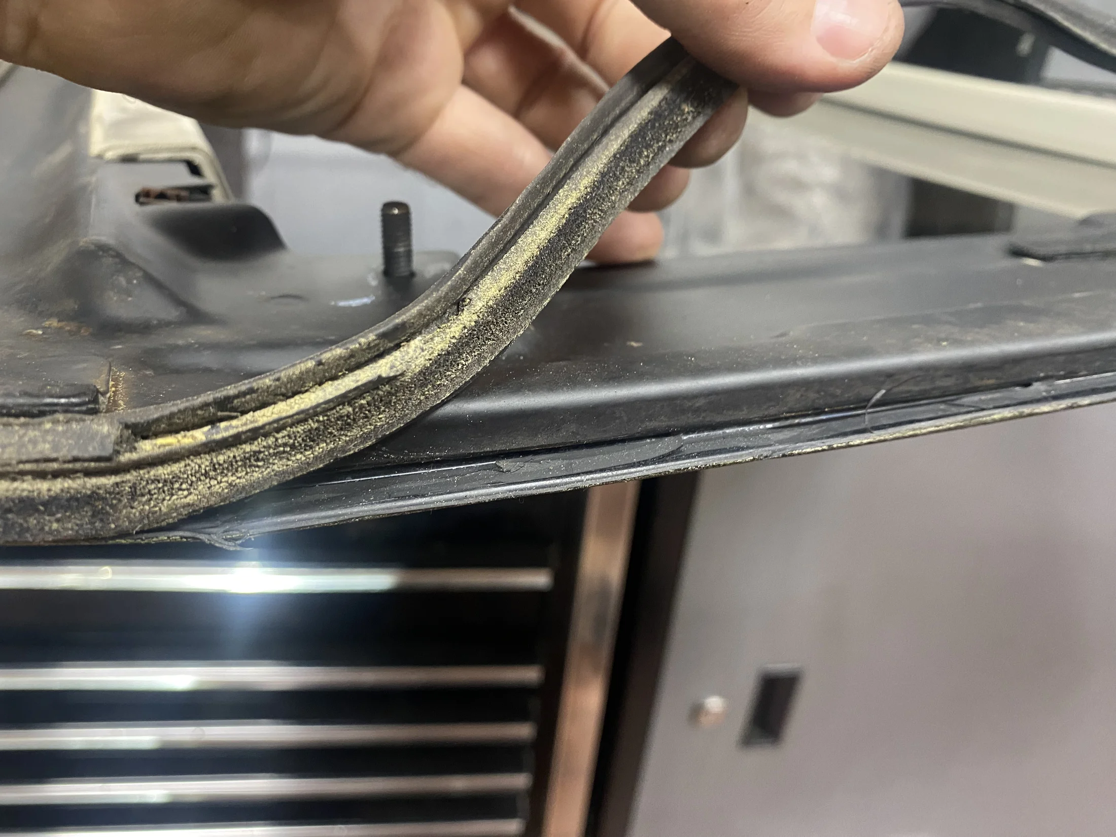

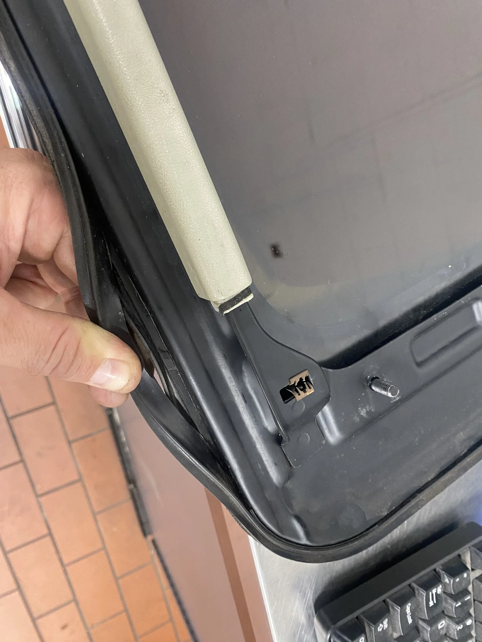

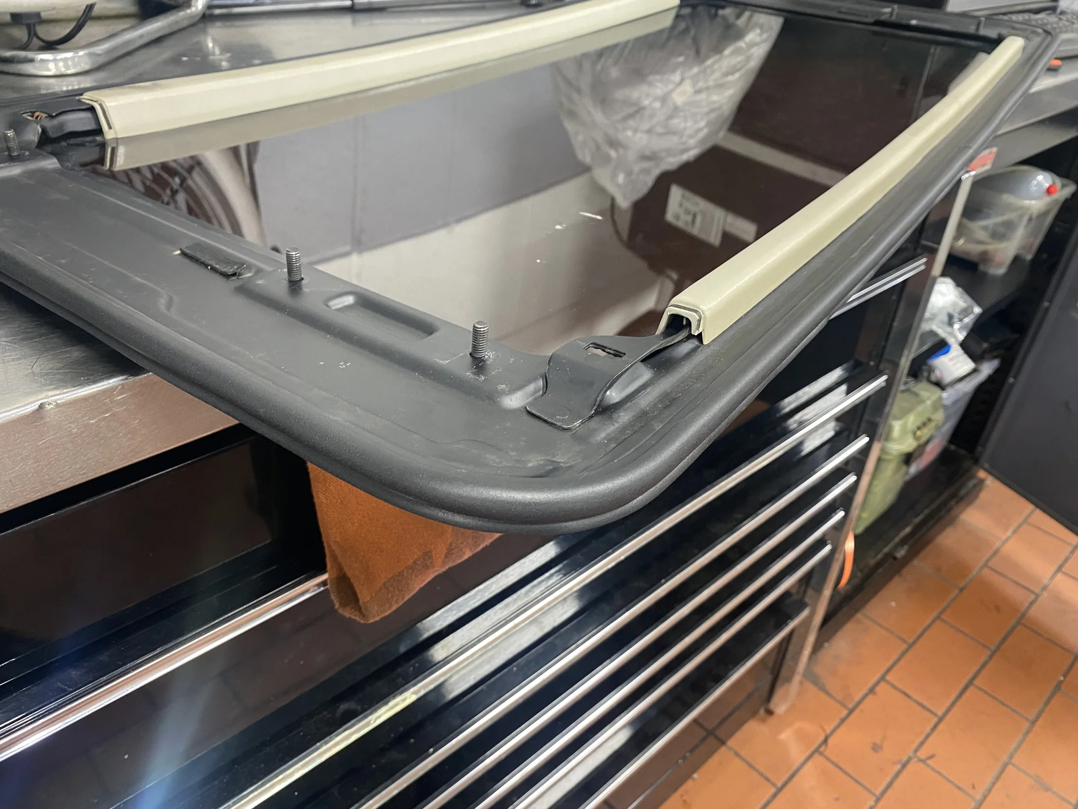

I came up with a repair for my leaking sunroof that I thought would be useful for the community. My sunroof seal had seen better days. It leaked during heavy rainfall and had a pretty bad wind noise on the highway. I looked into a replacement seal but it comes bonded the sunroof glass so you have to buy the whole thing. For a bit of back-story, I’m a tech at a BMW dealership so luckily I’ve got lots of experience with sunroof leaks and access to repair parts. I decided to try using a BMW sunroof perimeter seal to fix my leak. I remove the sunroof glass and cut the old seal out with a razor. I cut underneath the top of the seal to retain the finished, oem look. The new seal is a peel and stick design and fit perfectly around the edge of the sunroof glass. I used BMW part number 54-10-7-485-602 but any perimeter seal for a panoramic sunroof would work. They are available online for under $100. The seal itself is a bit tight so the sunroof motor needs help to open and close, but it should relax over time. This isn’t an issue for me because I never open it anyways.

I assume you just wiped the edge of the frame with alcohol or brake cleaner before sticking the seal on? How much needs to get trimmed off - and do you fill the gap with silicone? Will the seal stick to the roof over time and get pulled away from the window - or how can that be prevented?

No silicon was used. I cleaned the edge of the frame with alcohol before sticking the new seal on. You need to cut just underneath the top of the original seal as it is the visible, finished part of the seal. It’s pretty obvious wear to cut once you have the glass removed. Cutting the seal out was pretty easy to do as well. I don’t know about aftermarket seals. My concern would be the quality of the 2x sided tape.

I cut off the end as close as possible and used a bit on weather strip adhesive to seal it but it’s not really needed. I positioned the seam in the middle at the rear which is directly over the rain gutter so any small amount of water that gets through will drain out the tubes. It’s done the same way on BMW’s.
