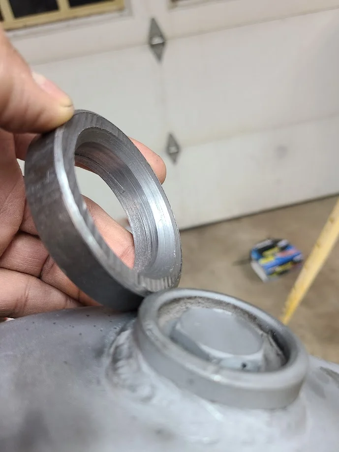

I just discovered that my rear axle drain plug got unscrewed, presumably on Tin Cup Pass last weekend. I'm grateful that it only lost 7 oz. of fluid. The protective ring has taken several hits, and it clearly needs to be replaced, but how? Torch off, weld in pipe?
I don't know the diameter offhand and I'm way too lazy right now to go outside with a pair of calipers, but... if you could find a piece of pipe or tube that's ID is close to the OD of the original ring, why not double up? New ring around old ring.

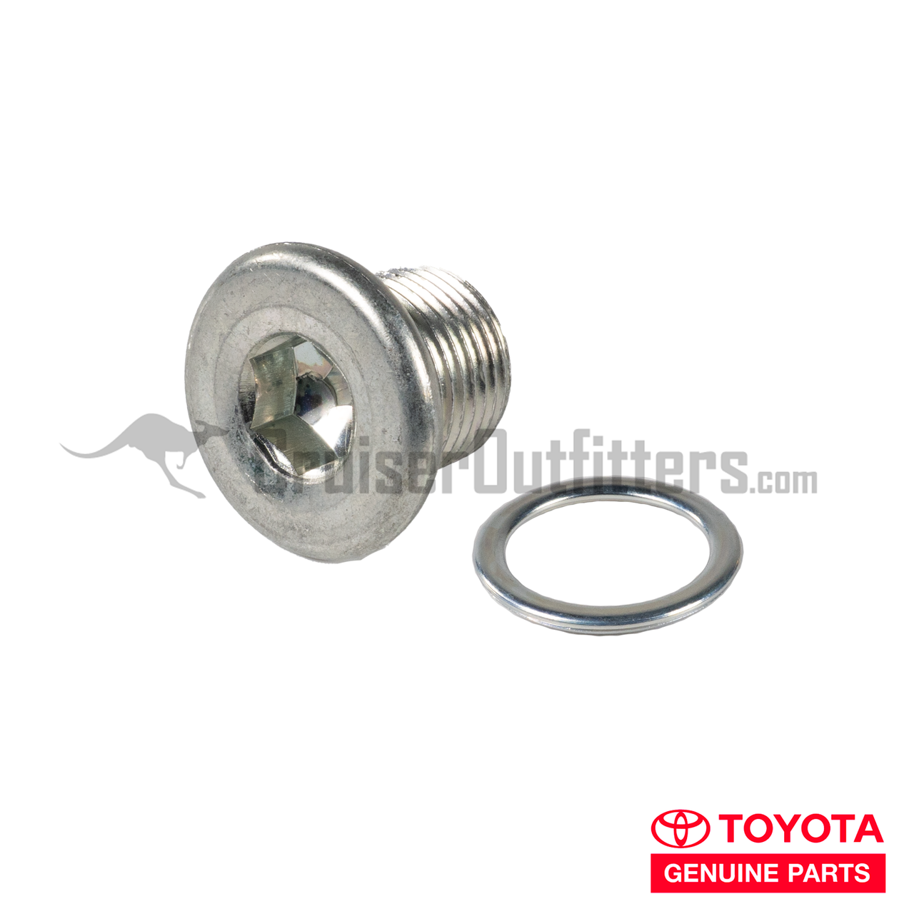

When you do this repair you might want to think about ordering some factory Toyota Allen head drain plugs from Kurt at CRUISERTEQ.COM that sit a little lower in that ring then the old style hex plugs do, plus they come with a Magnet. At only $6.25 a piece that's a hell of a deal.

Anyone know what the Toyota p/n is? I'll be placing a parts order soon, and I could just add it to that.
I have my doubts that’s a serviceable part/item from Toyota but you could give this one a go from @cruiserpatch
I meant the plug. I already have a ring cut and ready to go.
I believe the plug is 90341-18021, but doesn't include the washer. Hopefully someone will correct me if I'm wrong, but I think it's the same thread pattern for most if not all the drain plugs - diffs, t-case, etc...
I have a whole bag of washers. I learned that lesson pretty quick.

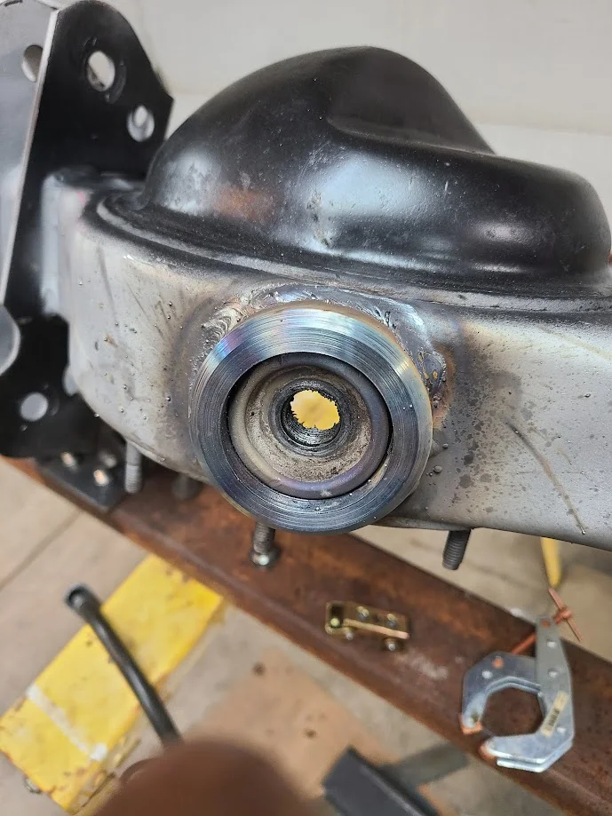

Both of my diff drain plugs had been ground down to almost nothing. Even the face of the allen head was almost paper thin.
I had my local hot rod shop grind off what was left of the old rings and weld in a thin piece of chromoly pipe for both.
All cleaned up with new plugs and crush washers.
Front diff with an added ramp.
Rear diff

I use the 10mm allen head plugs as some have mentioned here. They’re easier to remove since you don’t need space to get a socket around them.

i did this on my front housing. I made this on a lathe but a thick wall pipe with the right ID can be slipped over what you have now then weld it up. Assuming yours hasn't mushroomed itself! Just grind smoothish the mushroomed part, get the pipe piece and use a BFH to install before welding!
This has been used before. It can be used on the front with a bit of a big hammer too.
