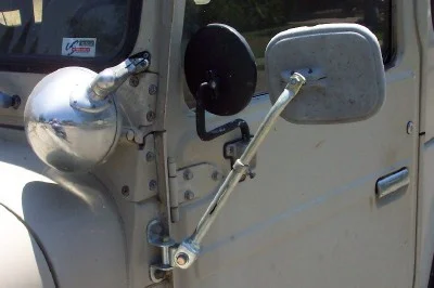

Found a solution for that all so common fj40 blind spot...
I ordered a matching pair of slightly smaller 5" round black mirrors, flat and convex (from the site previously posted).
The first thing that caught my eye, was that these mirrors utilize bolts for mounting (stock mirrors have build-in studs).
I picked up a pair of 2" long combination 5/16th studs from the local hardware store (fine and standard threads on each stud). Rather then taping the Toyota arms for 5/16ths, I cut metric threads over the fine threads ( I believe they where 8mmx1.25).
no more blind spot :D
I don't remember what I paid for these original Toyota mirrors, but the quality of these black mirrors are very good for $8 (each).
manny

This mirror is useless.. completely blocked by my roll bar. :mad:
As this is soon to be my DD, I'd like to get some kind of convex mirror for both sides. Round or rectangles are fine.
Can this mirror mounting tubing be bent? It's expensive, so I'm just asking before I try it, and ruin it.
I'd rather not mount on my door. I like this windshield mount. I don't anticipate dropping my windshield forward ever. I may try swinging this passenger-side mirror forward and inward to view it thru the front glass. And replace with a convex, but that arrangement would block hood opening. :mad:
Any better options out there? I thought Mr. Bursu from Indonesia had a solution. Any pics? Much thanks...
