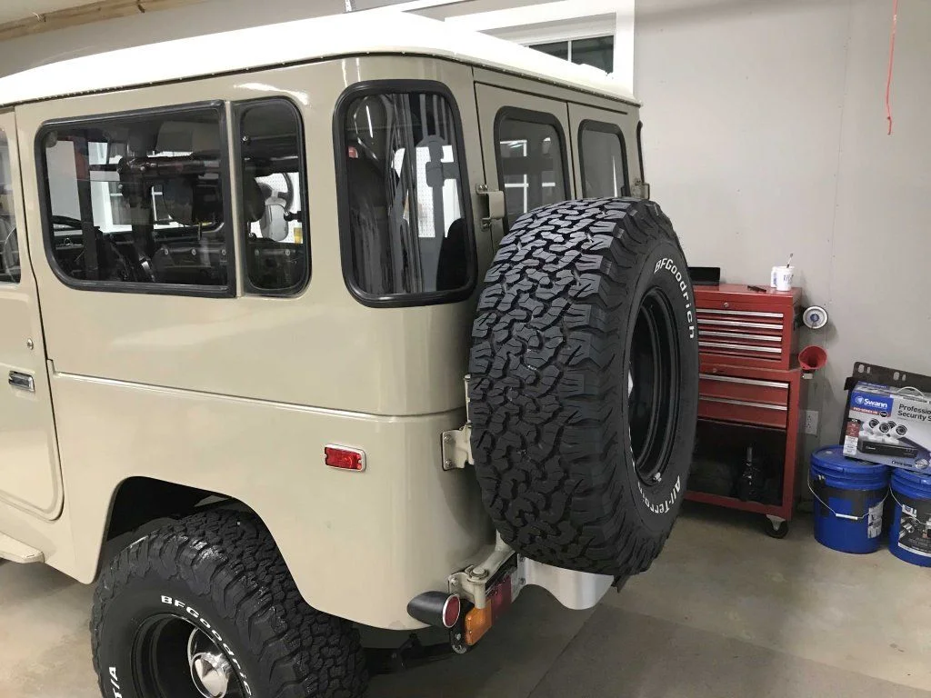

I had a similar issue, and the packing/gasket would grab the upper sides and pull/pinch. This would expose the bottom edge of the rubber in the rear corners. Last time I installed my sides & top, I tried baby powder on these gaskets. To my surprise, the upper sides slid right down without pulling or pinching the rubber.
You can see the powder on the rear wheel.
