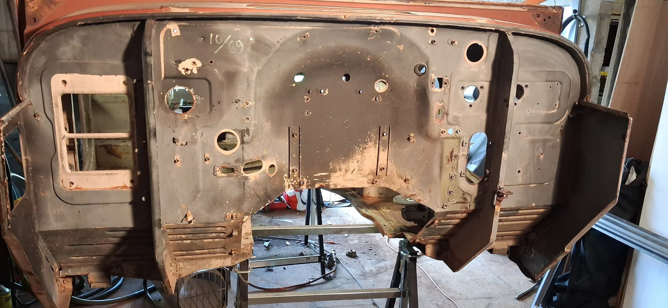

i am working on transforming a 69 body into a 64, so i need to identify the correct holes to modify / create
i will remove the air blower panel , passenger side) and weld the correct cuted part , i already weld the direction hole, so tell me wich holes are not good and good (i have clamshell heater by the way coming from my original 64 tub wich don't exist anymore because a french well know builder)
thank you for your help

You’re going to need to create the holes for the early pedal linkage to come through the firewall. I’m not sure if the non-heater FWD vacuum shifter uses the same two holes on the outside of the passenger firewall brace that the heater model uses on the inside.
