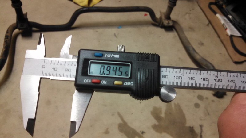

Gary, if you decide a US spec '91 sway bar will work for you, let me know. Mine is collecting dust in the garage.
Cool, is there any way you can mic it or get measurement?

I'm at work so I can't measure mine, but after a search it looks like a fzj80 sway bar is like 1.1" vs. your fj80 at.945" In metric it is close to 24mm & 27mm.
To move forward with the thought a weaker sway bar up front could be that happy medium solution to just leave it on all the time. Maybe, Hmmm? The idea of crawling under a hot rig after a long trail ride just is not a ideal situation for me, I tend to leave it on rather then disconnecting it. When i leave my sway bar on I feel a more rigid ride & less flex which creates more body roll & a less balanced feel. Bla bla bla...

I measured just with a tape & without a doubt it's over 1" it's closer to like 1 1/8th.

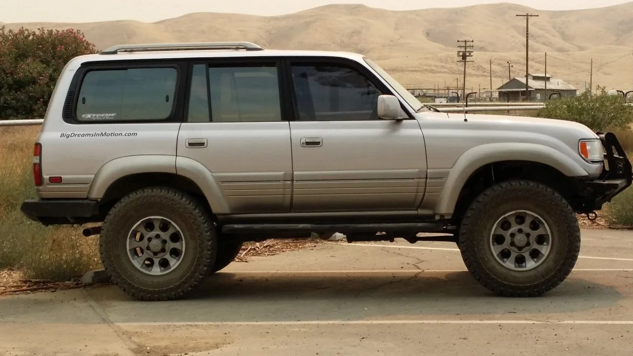

I am finding that the 4" lift seems to be the sweet spot for larger tires. To keep a 40/60 stroke ratio on the shock up front without restricking uptravel is tricky. (I understand you are a 50/50 guy). When I had my OME L shocks on my 2.5" lift the L shock had 4.5" shock shaft left. As long as one can get to 5" of uptravel at 3" or 4" of lift is very good. If one can achieve 5" of uptravel with a 3" lift why not???
Let me back up because I know you haven't read my thread. I am currently changing over to the Slinky Suspension which is turning out to be a a bit more than a 3" lift plus a 1" body lift, so I'm right there where you say I need to be. I'm just doing it a tad different. I also have cut 2" out of my front fenders so I could remove the restrictive 1.5" bump stop pucks I had. So I'm at 3.25" suspension with 5" of uptravel (like you keep writing) at the shock & 7" of down with .5" bump stop pucks up front & 1.5" rear (You I'm guessing have 2.5" bump stops up front & rear to stop the 37s). I am fortunate to have the 3 to 1 Marlin Tgears which comes out to be lower than 5:29s. I'm also running the 2.5" MAF drop brackets for caster. In the rear I'm now sitting 1" low with the 862 plus 30mm (1.5" lift) which was level with the 851's plus 25mm spacer equivalent to a 850 2.5" coil.
So I'm buying what you are selling here & I'm still listening.
Currently sitting low in rear.
Center of hub to bottom of flare front is 24.25" rear is 23" so my lift total with body lift is 4.25" front & 3" in rear. Hopefully a winch & battery will even things out. I'm really happy with my rear coils, they just are not tall enough right now.
