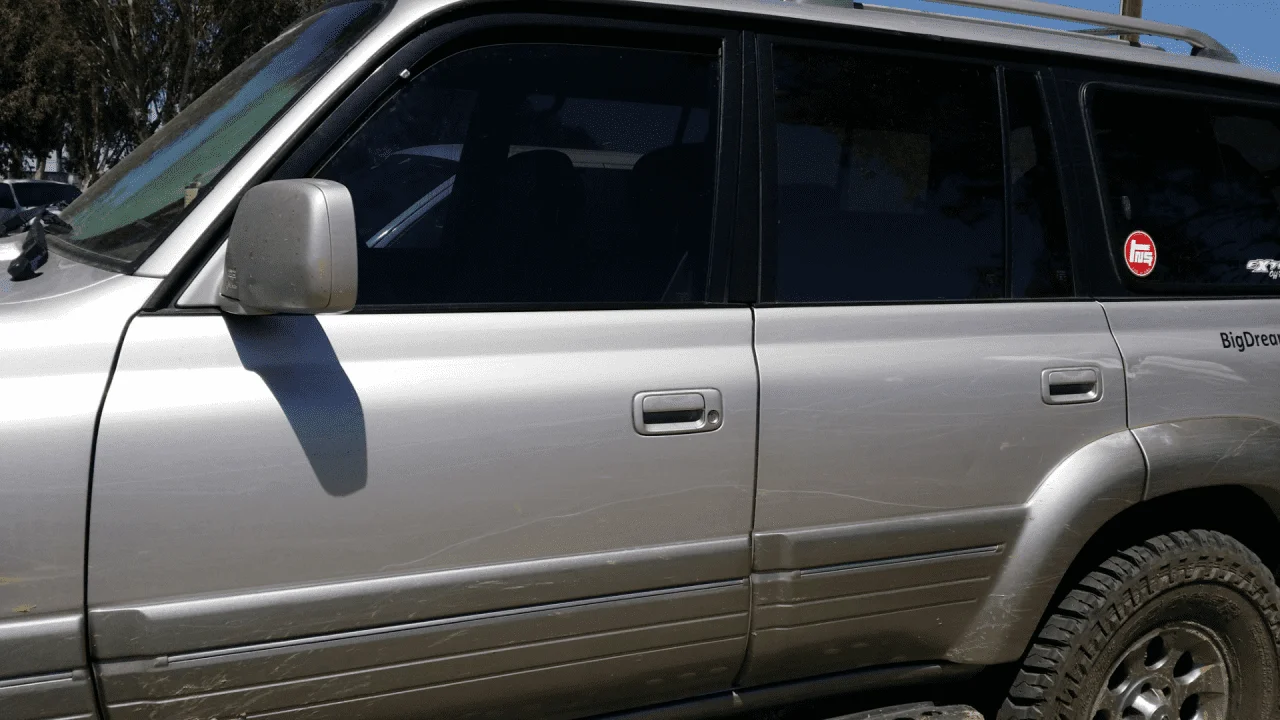

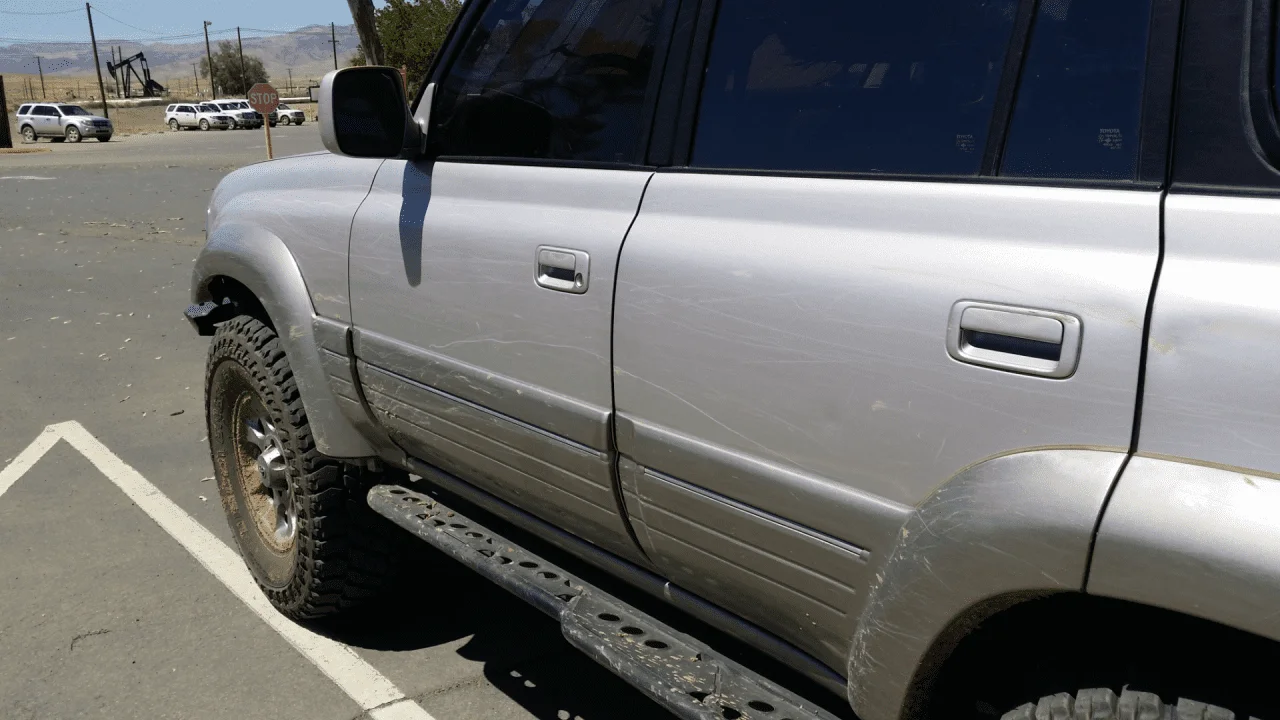

Im not one to stress over paint, but I do want to retain my cladding as long as possible to avoid all those holes.

Im not one to stress over paint, but I do want to retain my cladding as long as possible to avoid all those holes. I'm thinking at that point I might go to a wrap, you know the sticker kind of wrap... just thinking about it.

After reading so many posts about dealing with the LX "holes" I think that I would weld a piece of sheet metal over the entire area.

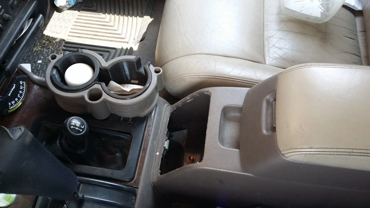

Sitting here at work trying to figure my options on what to do with my silly LX450 center console. I know... just replace it. Well, I need to explore all the free options 1st. What has the Lx450 owners done before me? I know fzj80 owners really don't like theirs but at this time a 80 console would be better than this. I can make something out of wood to slide in there...
I know it is not free, but I love my tuffy box. Use it as a pattern (shave off some of the length so the back seats will fold closed) and make one out of wood.

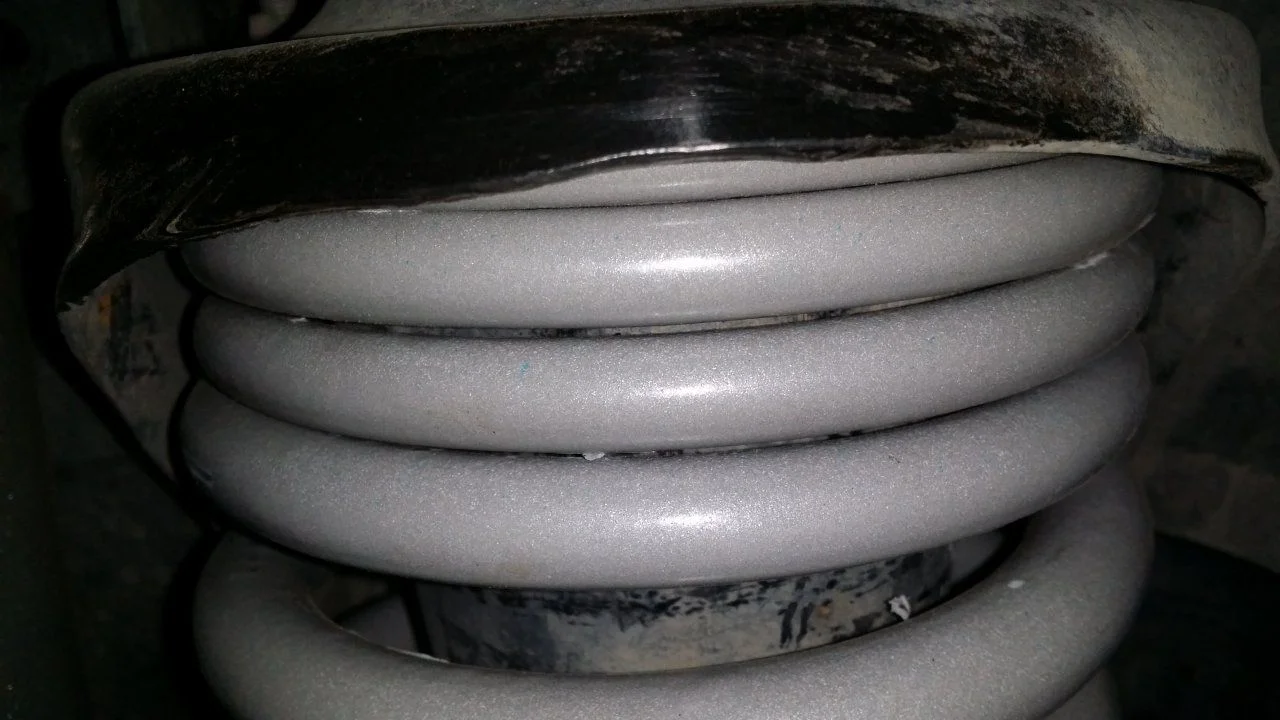

The Redline Slinky coils came in. I got them installed that same day. The family went to the big city for groceries so it was perfect timing for some rig time. I ordered just the front set up of 75mm coils & Stage 1 shocks. The Icon shocks are not here yet but I do have some longer Doetsch Techs that are 28.75"ish long but the valving is to soft.
They do have a LH & RH side, the free height is 615mm & 600mm. The taller is the LH coil.
Below are my 851+25mm which is equal to 850s.
Since they are so long it took a bit more doing to shoe horn them in. These are long ones...
1469845413834-1602028344-jpg.1298529
Now that they are in, it looks like they are setting higher then hoped for, but the coils are not touching yet. So there is hope they will settle down. In these pics there is an air gap where the should be touching or stacked.
Right now they are at 24.5" & I'm hoping for 24" center hub to bottom of flare. Don't forget I have a 1" body lift, so minus 1" from my measurement. 24" would be a solid 3" of suspension lift.
It has allways been said in my circle of friends, if one can clear the bottom of the body with the top of the tire... that's darn good flex. I'm very happy with my new Slinky coils, they push the shocks fully extended. I have gained 4" more downtravel at the tire from my OME L shocks.
I'm now driving up curbs on purpose & blowing though 6" tall parking lot stops like they were 1" reflector bumps. These coils are the bomb & can't wait for the Icon shocks.

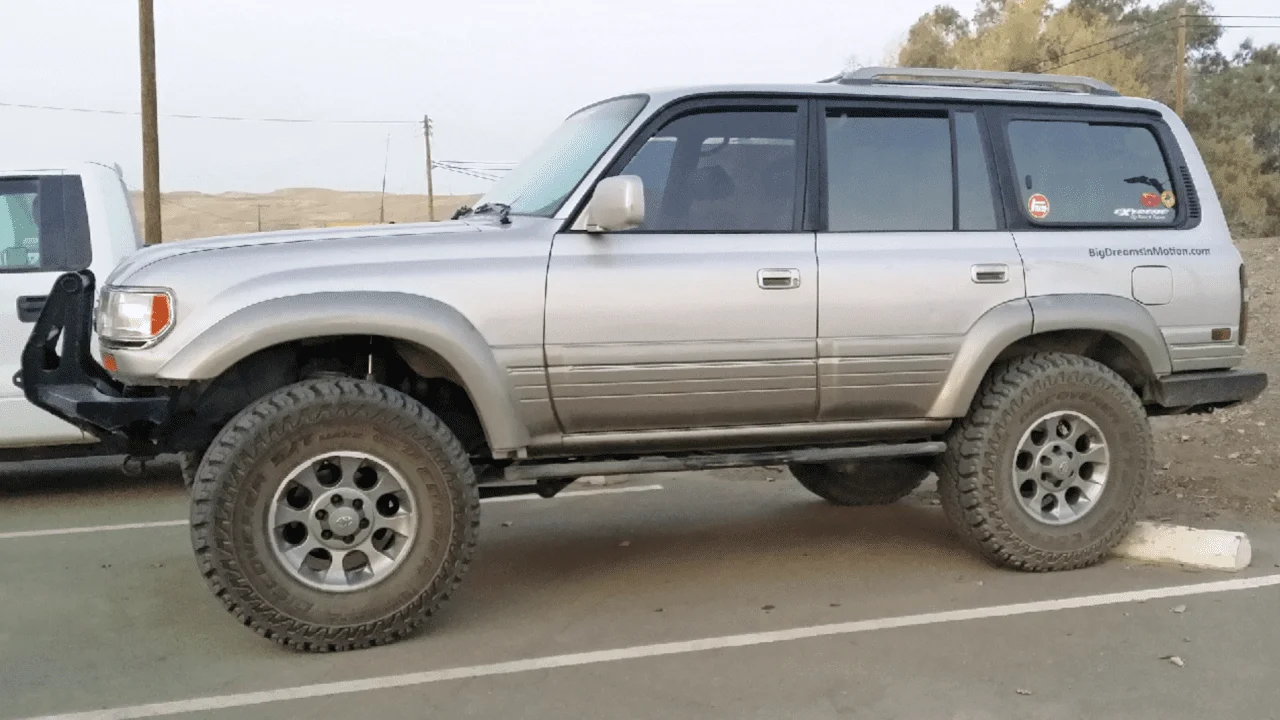

Here is a quick pic this morning on semi level ground.
That's a loaded question... im currently over corrected OME yellows & 2.5" MAF brackets.
Guessing at 5° but have a set of factory bushings waiting to be installed. Not sure where these Slinkies are going to settlend down to yet. They have come down about half a inch since install. They are at 3.25" lift right now.
Just for the record minus my 1" body lift:
Center of hub to bottom of flare.
75mm Slinky AC7498
Front driver 23.5" Pass 23.25"
OME 862+40mm
Rear driver 21.5" Pass 21.5"
