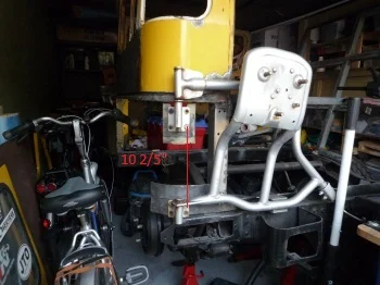

I have one more question, I see that you have the mounting holes for the original spare carrier, can you messure thr distance between the upper and lower bracket?
Center lower bolt hole of upper bracket to center upper bolt hole of lower bracket.
Mine doesn't fit like it should and I am trying to find out what the problem is.

I added a picture, think I have to shorten the bracket.

Michael,
My tire carrier is the box frame style not the tube frame like yours. I am not aware of any difference but there may be a difference.
