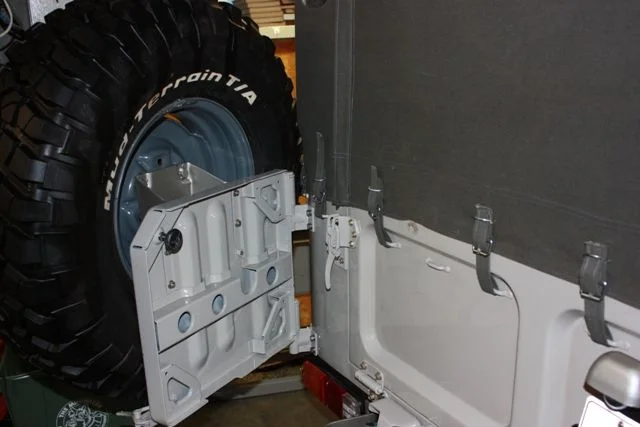

tire carrier and inside pics

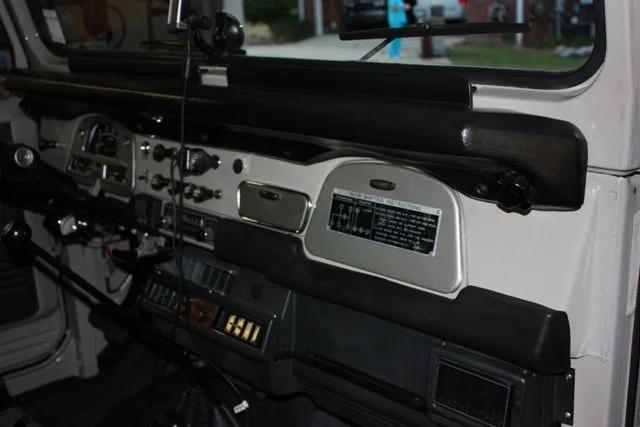

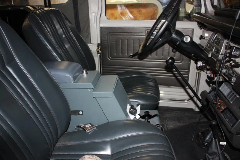

I had been ask to show some inside pictures, so here you go.

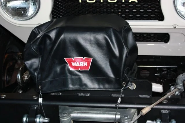

I also got my winch mounted and the spare tire carrier.
