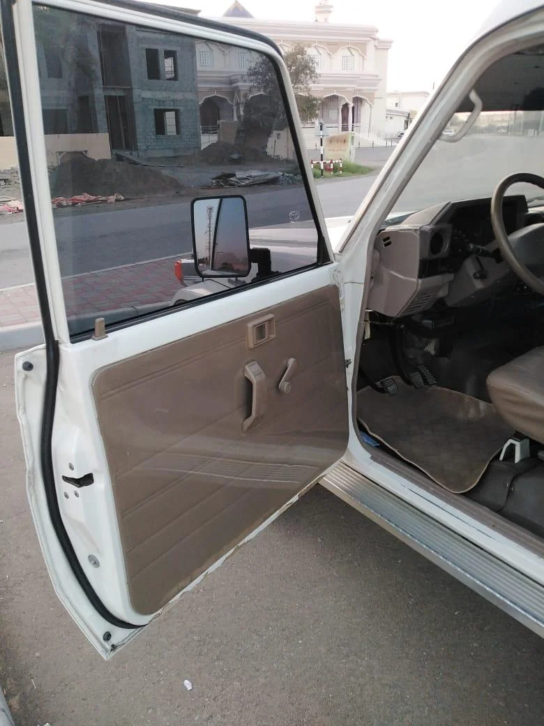

Iooks like it has been repainted

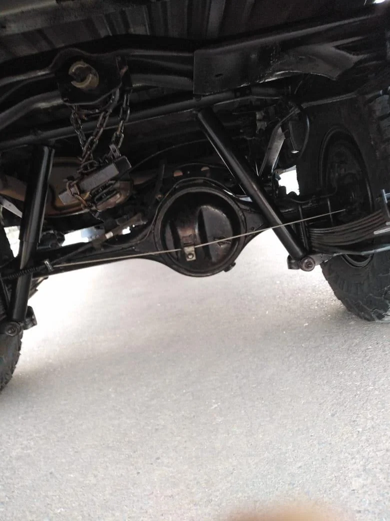

The underneath has been sprayed/painted/coated
Those are the 2 (or 1 really) big flag that jumps out at me. Without documentation you have no idea what kind of work was done. Could be completely filled with bondo and who knows what. Also not sure how much has been repainted.

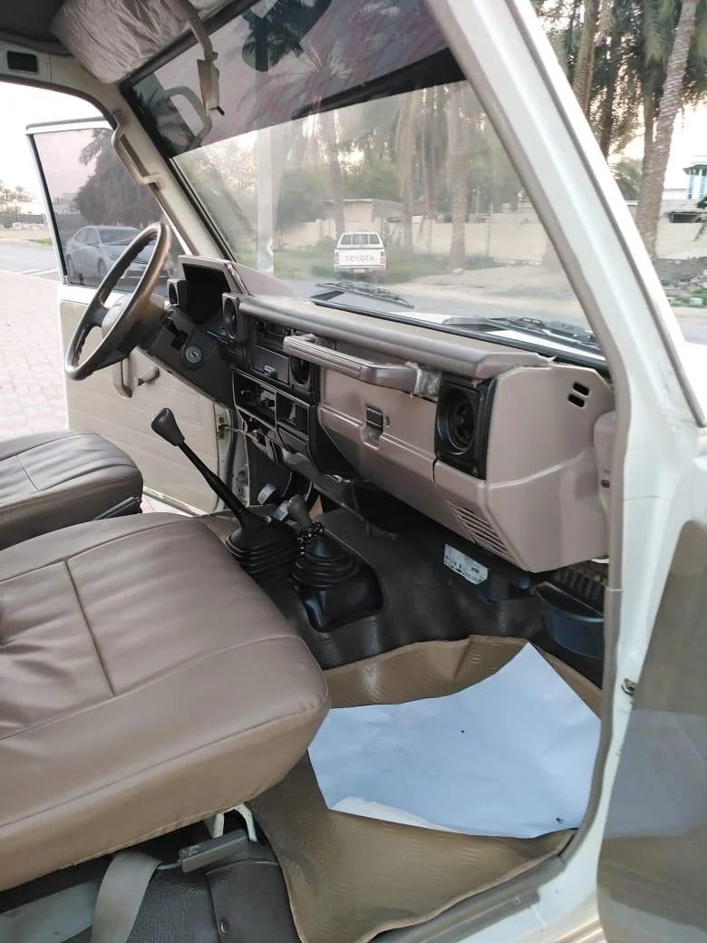

Anyway, this is pretty typical of what you're gonna see. It's been repainted, but so many of them get repainted, and not just for resell. The interior door sills on the front doors haven't been repainted, so it was likely just an exterior spray-over. Very likely hiding some body damage/dents all over. Highly unlikely there is much/any rust.
The rear floor has been drilled numerous times, likely to have the diamond plate floors installed/removed a few times.
One telltale for me on how it's been care for... on the back of the rear diff the drain plug has a nice little bar welded on to it for easier removal. Likely a work crew transport truck that was ridden rough out into the gas fields. Got sold and picked up by someone who used it for their family or smaller business and they repainted it, tinted it, etc.

i'm looking at the little details,,,, all the rubber bits, grommets, bumpers, hood support ect are all acounted for. my Omani troopy was missing many of the rubber bits like that, it has bars welded on the oil plugs ect ect. mine like most, lived a hard life, but the minimal rust to deal with is worth it to me.

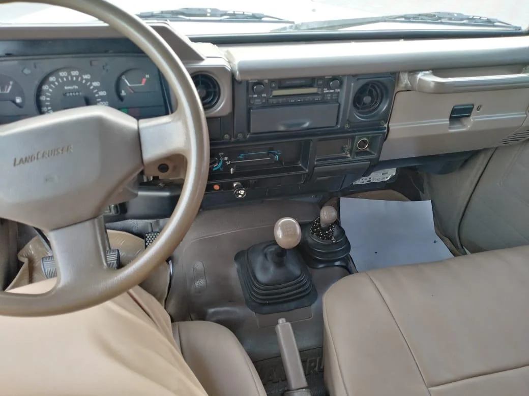

It looks resprayed. Outside and under.
Judging from the chrome bits, it looks like an LX spec. Rare with Troopies.
It has A/C with a cooler. No heater. Good for a warm climate, maybe not that good in a temperate climate.
Lots of holes and fesh fesh to remove/repair.
Wiring does not look hacked.
I would book a trip to take a look. It is worth the expense.
Juan

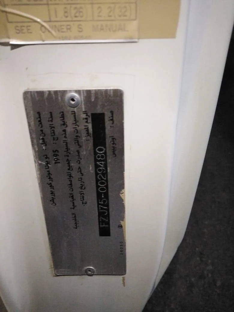

It would be good if there were pics of the body plaque from the firewall. The rear leaves looked like they are the originals and fairly worn out. Its a base spec model judging by the dash. The seats have been recovered. Obviously there is no spare tyre. The rear seats appear not to have the lap belts, maybe they were not required in that country.
The body panels seem to fit ok. As long as there is nothing bad lurking under the paint, it doesn't look too bad.
Seems this Troopy does not have a heater, so no defrost also.
In a country with temperate climate this can be an issue.
