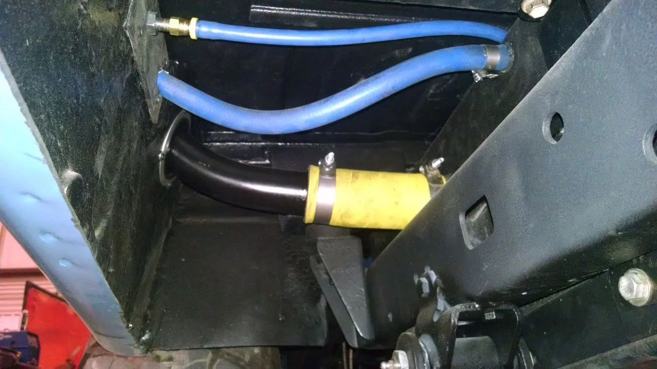

What kind of hard line did you source? I asked at the NAPA about this (using 2" exhaust tubing), but they were hesitant to recommend anything for fear that the ethanol content would be corrosive to the hard line...
I ended up going with a 2" ID reinforced suction line that is a Parker Store product: S7219E2
FYI: I had issues with that same hose sealing, I couldn't get the clamps tight enough and I used two of the same clamp you have pictured on each side.
Awesome! Perhaps I will be the test victim for the super elbow from filler neck supply!
Like I say, why do it once when you can do it twice?
Can you describe the failure to seal? Was fuel dripping out? I have not had problems yet, but I ended up not being able to use those clamps. Once I had stretched out the hose, the clamps were too small. I ended up at the local Auto Zone at 6:55 PM on a Sunday night getting your regular old hose clamps. Good times after paying $6/each for the clamps pictured above...
I could not get a good seal I believe because of the spiral going around the outside was preventing the clamp from applying even pressure.
I ditched it for the smooth hose linked in my build thread and haven’t had any issues with the new stuff.

I seem to be having trouble filling my tank, not sure if it it the ridges in the hardwall tubing making for turbulent flow, or the bend I made. One of the stations near me has a hard time filling other vehicles all the way up when it is windy. Not sure if it how their under ground tanks are vented?
This is compounded by my sender putting out the wrong level to the gas gauge.
I went ahead and ordered their 90 aluminum fuel elbow and their Super 45. Hopefully I can get those both in this weekend:

These items showed up on time and as ordered.
Saturday morning I got to work. I let the fuel tank level get low, so I was ready to pull the fuel line and hopefully would not create a puddle of gasoline on my driveway.
I pulled the fuel fill hose, no fuel leaks out, and I remove the old flex hose.
The new, aluminum 90 degree elbow will require some cutting to hit the inlet correctly, so I measure 8 times and cut. I cut the length correctly, only to realize that the 90 degree angle will point at the underside of the Pig, not at the gas tank. So I decide to try the 45 degree super hose. Long story short, I cut it in the right places, to the right length, and I think it works well for my '74.

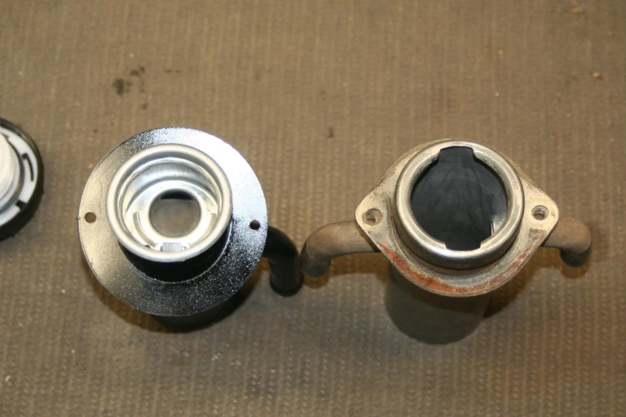

I'm going to put this here as well as my build thread. Twice now fuel has spilled out the gas cap (while off road) and after I had filled the tank. I have four vents running to the charcoal canister, so shouldn't have a pressure issue. I believe the cap just isn't sealing well. A guy in the 60 forums has started a thread on grafting a new filler neck and cap on to the old neck. Sixties necks are long not like the 55, so I bought a new neck and a screw in cap and will just replace the old. I'll need to cut and weld the mounting flange to correct the angle, but seems to be an easy job. I'm not going to start this until my new rear axle comes in and I can pull everything apart.
The new neck is the black one, angle is all wrong.
The new neck has a flap installed that helps stop splash back.
Should be a fun project and maybe stop my wife from screaming we're going to die! :)
EDIT... Forgot to add the link. ANGLED 2" Cab And Chassis / Flatbed Fuel Filler Neck 5/8 Vent. (Gas)
