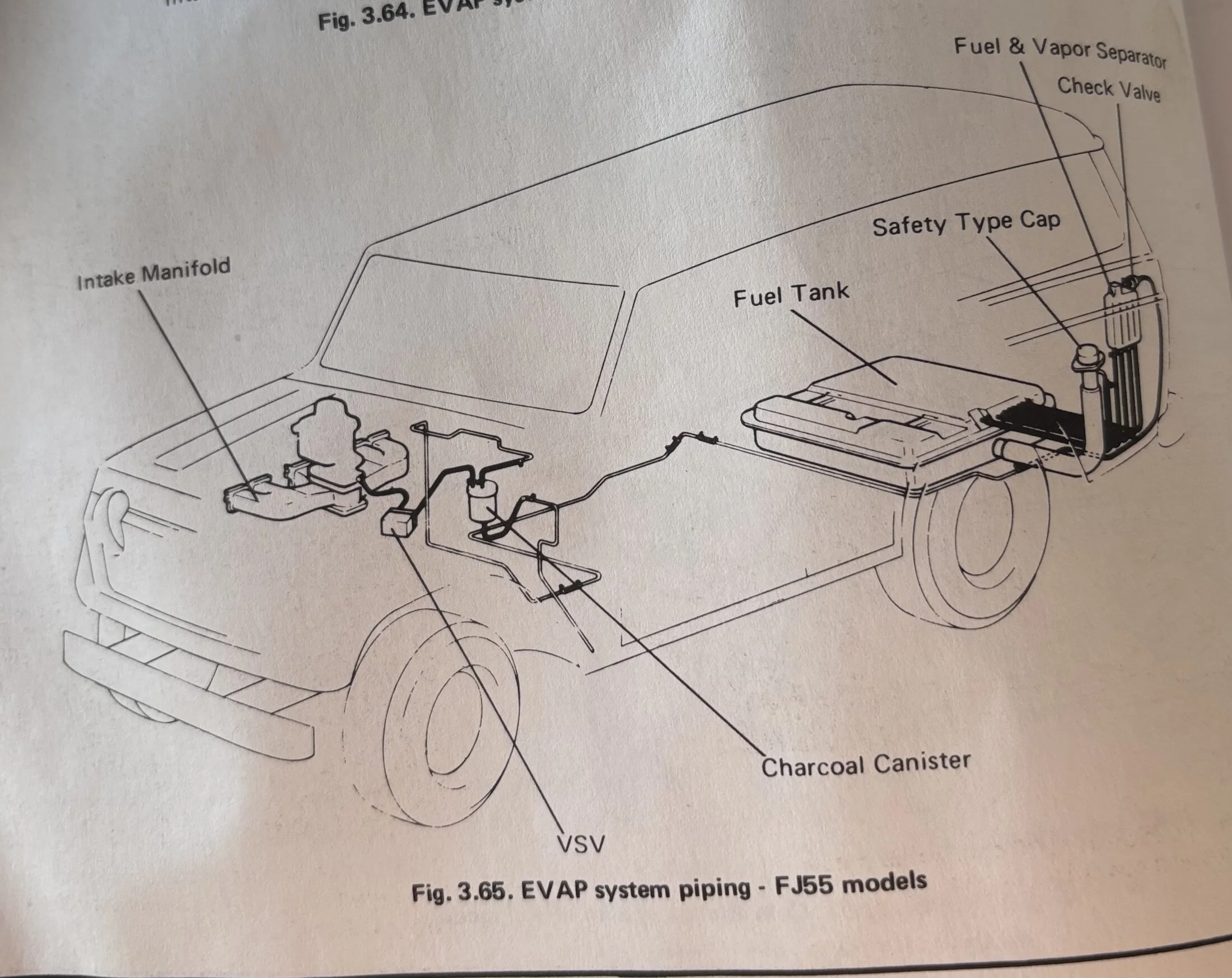

Correct me if I’m wrong but I started thinking there’s probably 4 vent lines because, since the tank is so flat, there’s a possibility one of the 4 corners are inevitably going to be flooded with fuel; that the fuel vapor separator is designed to capture any of this sputtering of fuel and return it back to the tank. So I think the operation of these vent lines are good.

Where did you introduce air when you checked the line all the way to the charcoal canister?
The line that attaches to the outtake of the check valve.
Try it from the inlet to the check valve or from one of the four inlets at the bottom of the fume separator. If you do it from there though, you have to plug/clamp the other 3 inlets.

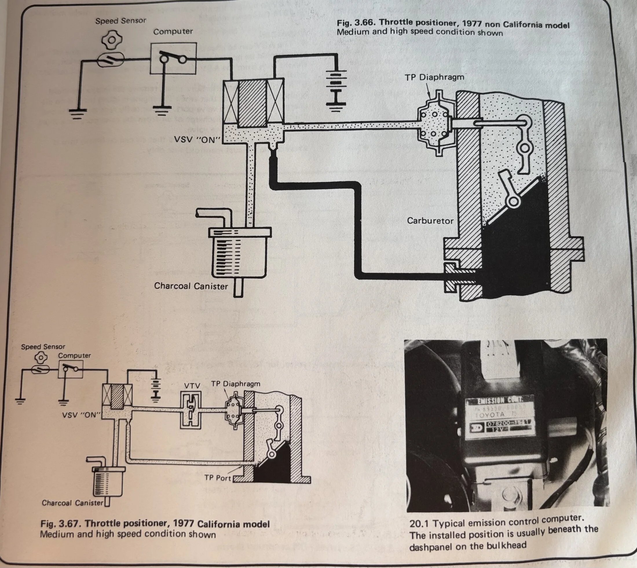

If you feel that you’ve eliminated any potential blockage in the venting system up to the charcoal canister, then the next step is to go through everything on the other side of the canister.
There is a Vacuum Switching Valve (VSV) which is operated by an emissions control computer. Two lines appear to go from the canister to the carburetor, one of which goes to what is called the Throttle Position (TP) Diaphragm.
Is this information in the FSM or in another document?

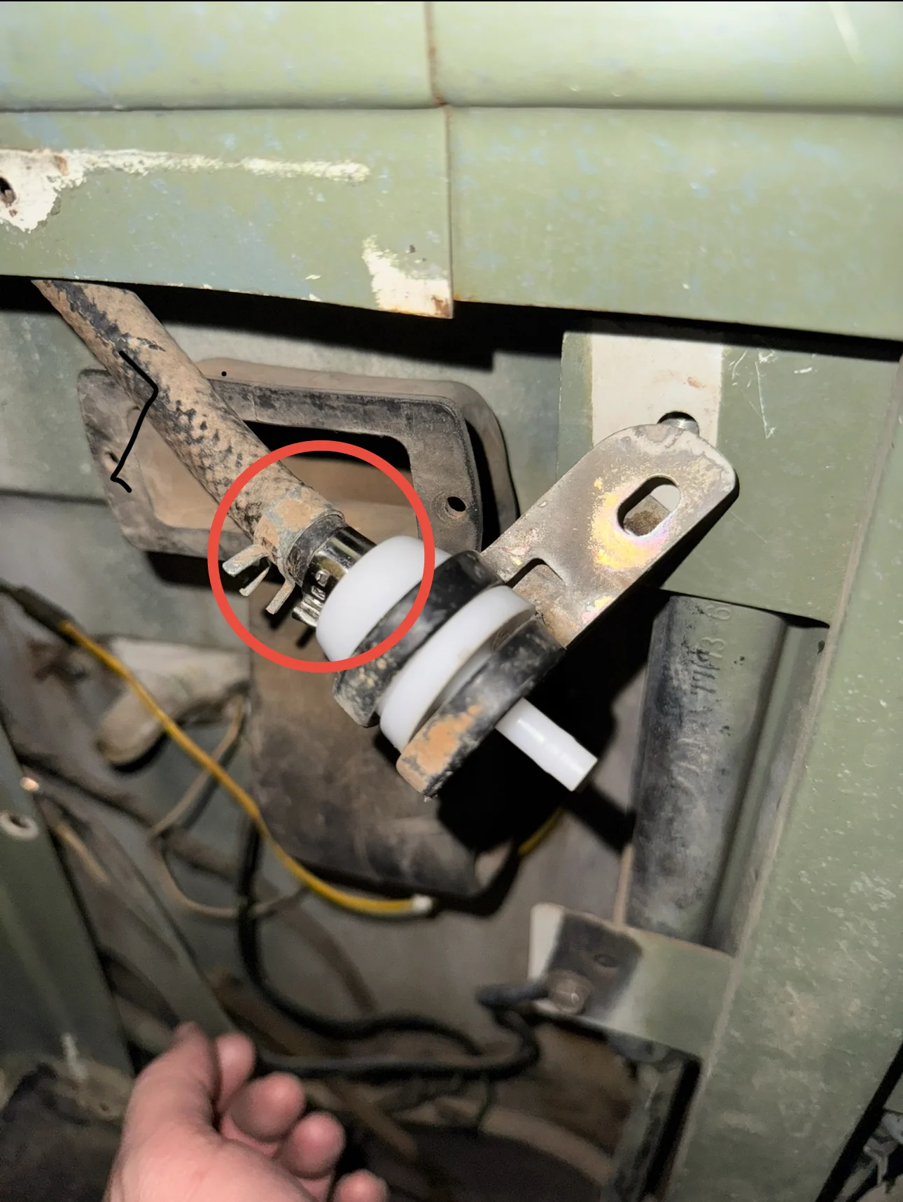

So i took off the check valve from the fuel vapor separator and pressure was coming out. Starting to think that maybe this check valve is either faulty, or possibly not really meant for this ‘74 1.5F engine.
I have read that there should be a little bit of backpressure thats why the check valve opens past a certain psi… is this enough pressure that would cause this wooshing im so concerned about?
Thinking maybe just removing the check valve out of the equation, what do you think?
This is the check valve I put in…
Maybe Im wrong to assume itll work for the 74… wish there were psi specs somewhere
