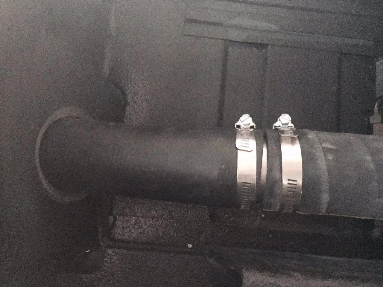

Yes the 90 works. It's a matter of positioning to match the hole through the body but it works fine.

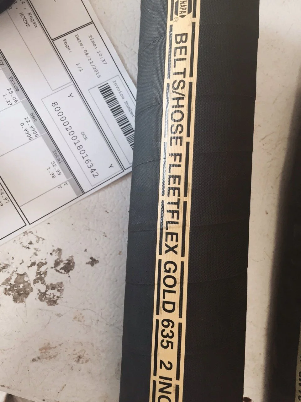

I visited the Napa store and picked up some 2 inch soft wall hose and it slides over the 54mm tank outlet. I coupled it with a Gates 24717 90 degree elbow (which is also flexible enough to slip over the fuel inlet). I had to cut about 1.5 inches off the vertical end to allow it to ride high enough on the inlet to center where the elbow goes through the body.
I got it all together and started to add the 5/8 inch vapor vent hoses and had to take it all apart to drop the tank in order to put hose clamps on the vent nipple at the tank. There is no room and I strarted to get really frustrated so I stepped back to drop the tank and start again.
:bang::bang:
Here's a picture once completed.
The factory vapor vent hoses seem to be some stretchy hose also. A 5/8 hose from NAPA was the same diameter as the hole in the body so no way to fit the hose through the stock grommet. No way to drill the hole bigger for a larger grommet so I'm going to cross my fingers that it won't become an issue in my lifetime. I just ran the hose thought the bold hole with no grommet.

I paid hell, fitting those vent lines. I bought new hose and different grommets, but I think it's good. Don't feel bad about the tank dropage, I've done it three times and need to drop it once more, to finish up.
Everything looks good under there!

The smaller lines are the vent lines that connect to the top of the tank. I fought with both of those lines for a while and found it best to drop the tank to attach them. The problem is the nipple the hose connects to is recessed a bit into the tank and to tighten a hose clamp there is no room. Dropping the tank give you room to get a wrench on them.

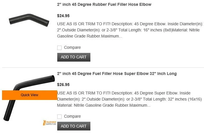

They are working on a 90 degree super elbow. Should be later in the year. I tried the 45, but couldn't get it to work, 90 fit better.
Someone would have to experiment because I couldn't get their 2inch hose to expand to go over the nipple of the inlet or tank. Their wall was reinforced with wire. Hopefully the new one isn't.
You need soft wall tube, not reinforced. It is not a suction hose, so no need for reinforced.
Assuming you got the 2" hose? How does the 90 fit over our 54mm pieces in the Pig?
The spring reinforced hose is much more rigid to prevent collapse in suction application. For fill hose we can use the soft wall.
Darn, good to know. :-( Did the 45 collapse at the elbow when you tried it?
They said sometime this month - the 90 degree super is in production...
