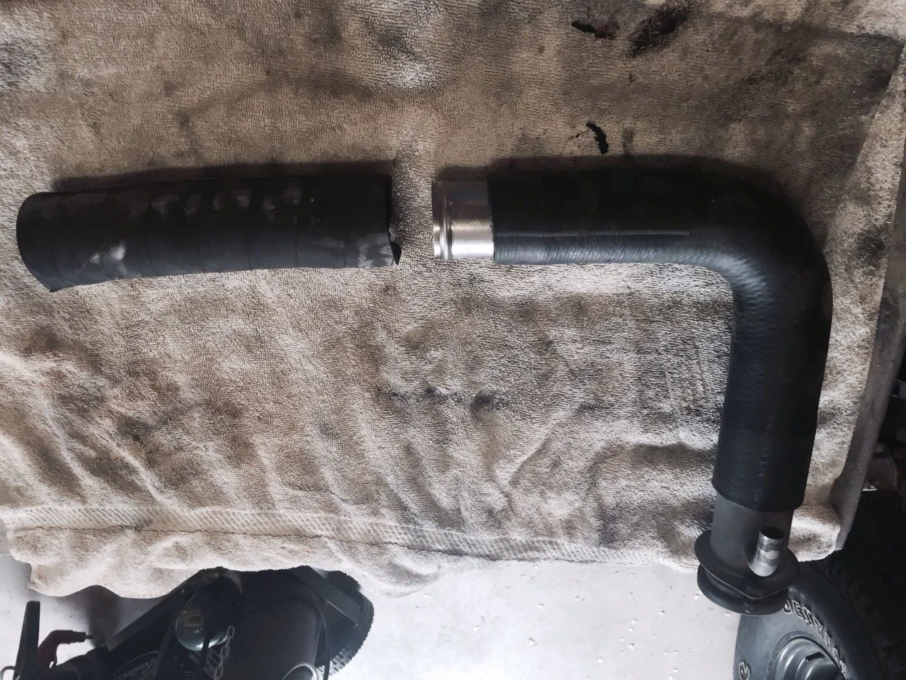

The picture I posted is the 45 degree piece from Filler Neck Supply and the connector and straight piece from Napa.

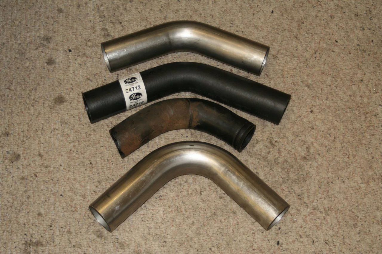

But like everything else I’ve done to my pig I’ve managed to overcomplicate this portion too and I’ll bend a tube to make the bend to pass through the body and only use the hose to couple.
I like that idea the best. Tell us about the tube you're using and how you're bending it. Buying a set of 2" dies just for this, would be hard to swallow.
Yeah, now that you say that, you could get stainless steel mandrel bent tubes in 2". Good idea. While playing around with this last year, I thought a 45 degree worked better, something to check again.
I have a 2" die for JD2 Model 4 Bender, Ill let you know what angle I come up with when I get there.
Fun picture. Top is a 45, second is a 45, third is part of the org. off the parts wagon and last is a 90. Hard part will be getting it lined up with the grommet in the body. Not a lot of room.

On my '74, the passage also accommodates the fuel filler neck overflow hose, plus the 4 vapor recovery lines from the tank. This piece may occlude one or some of their passage, eh?
Never mind, I went back to my image from earlier - you are right on!

So here's the update after getting a coupler and Gates 24717 90 degree. The 90 will slide over the inlet pipe but the straight hose they sent me doesn't. It has wire reinforcement and is thicker material which won't allow it to expand no matter how hard I try to force it on. I even tried a heat gun in hopes it would make it more pliable.
I guess I could always buy another 90 or 45 and hack a section out if it since it looks like the straight section only needs to be about 5 inches.
