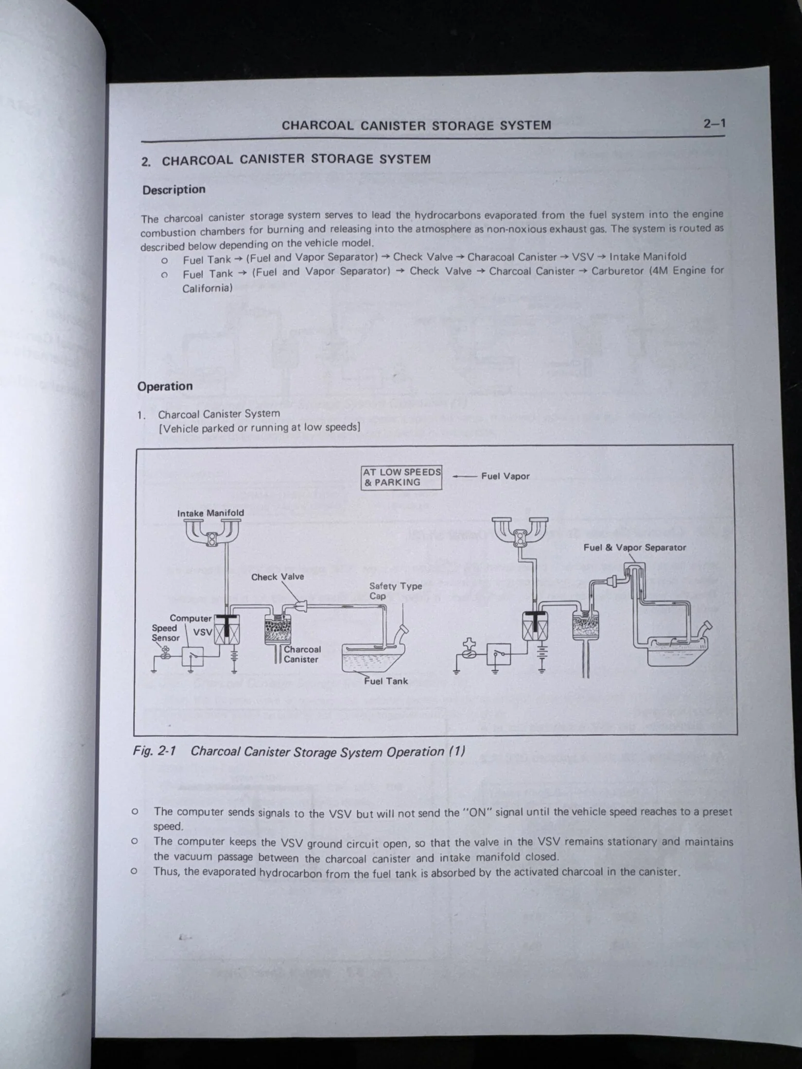

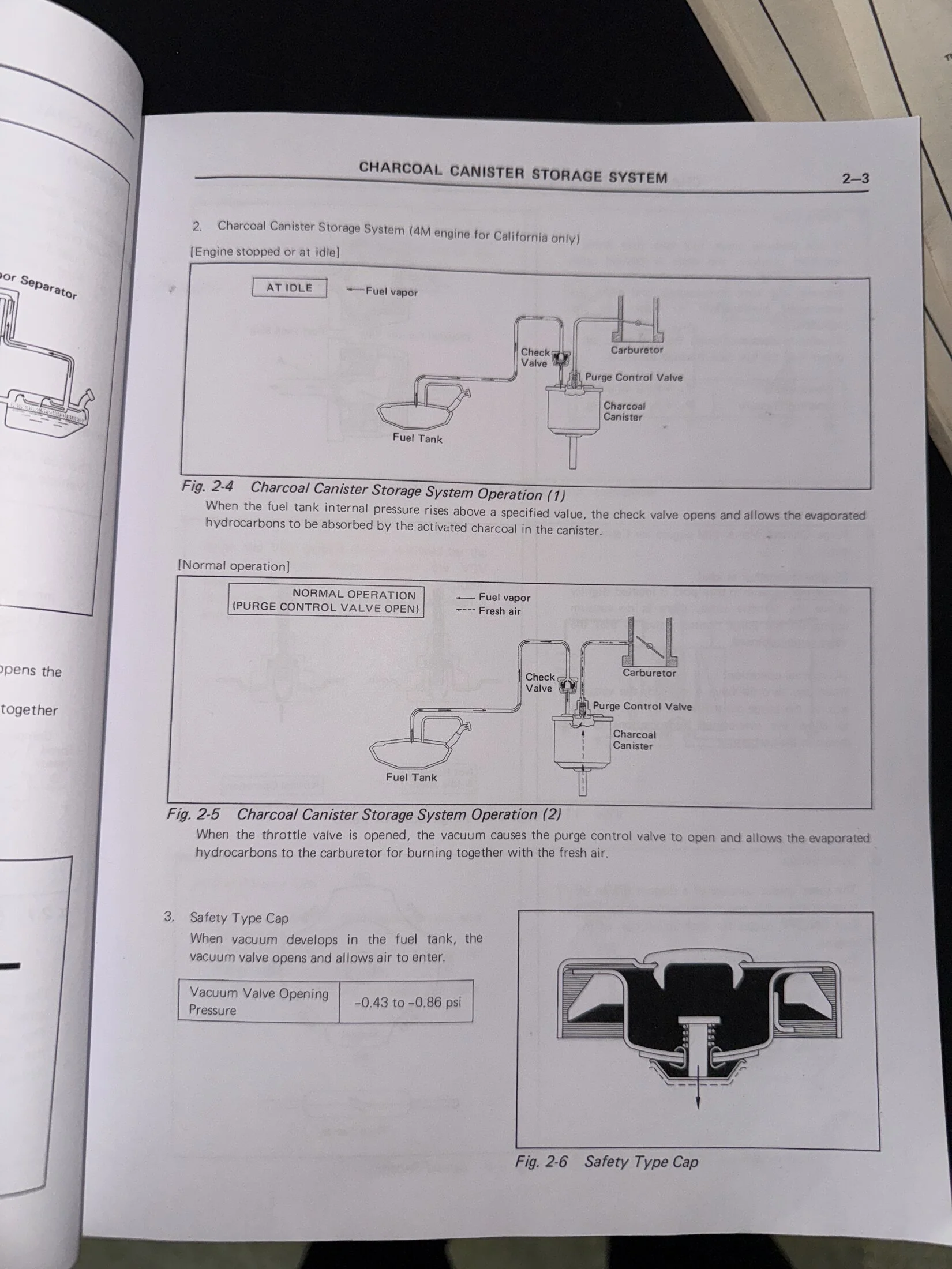

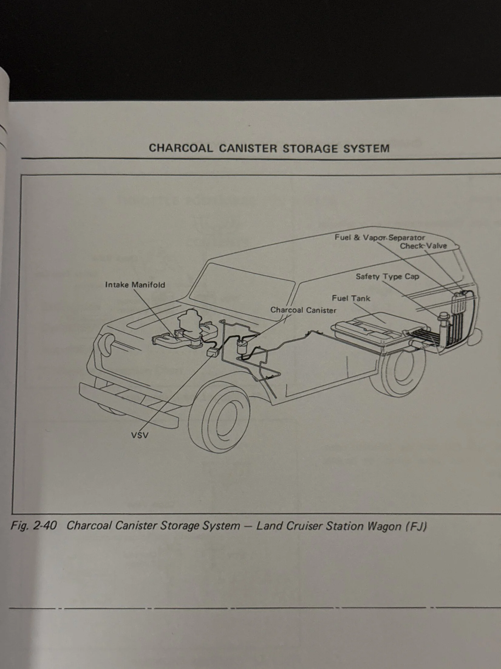

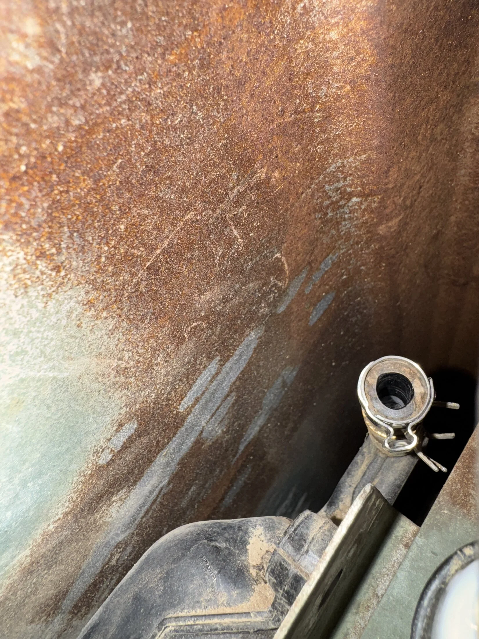

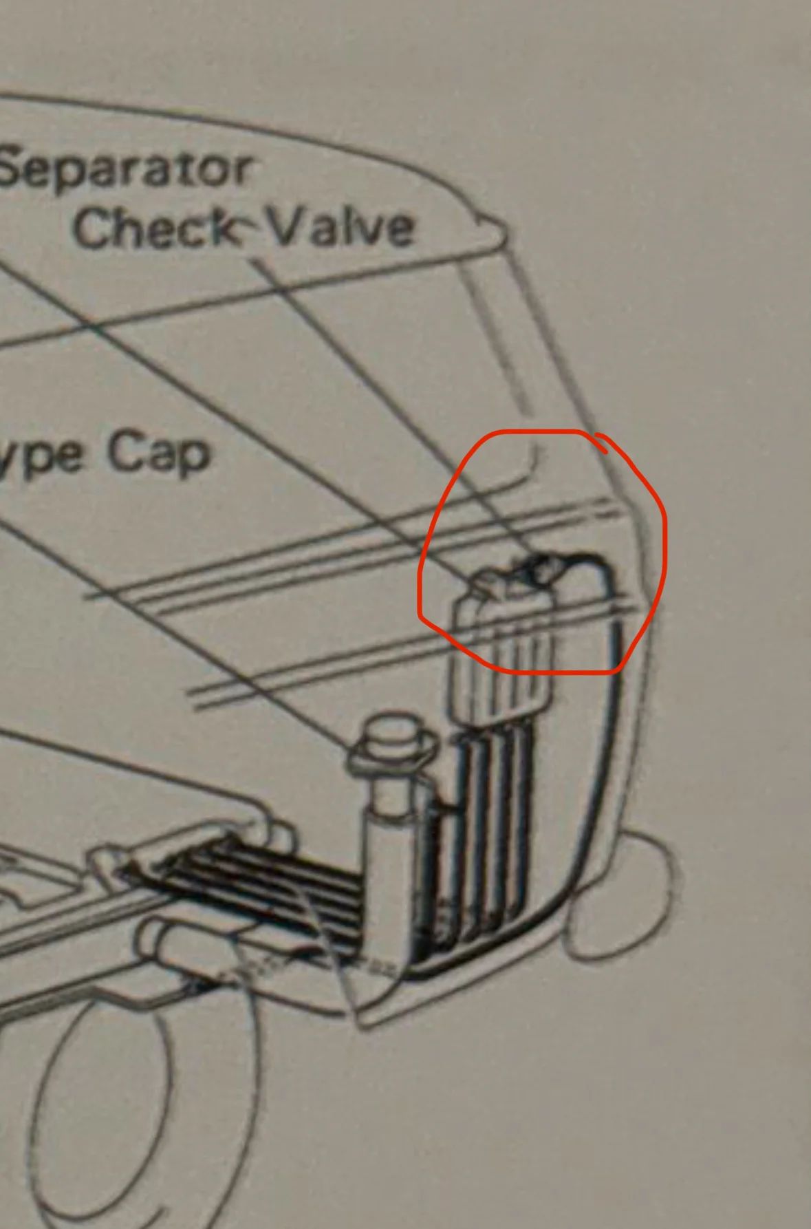

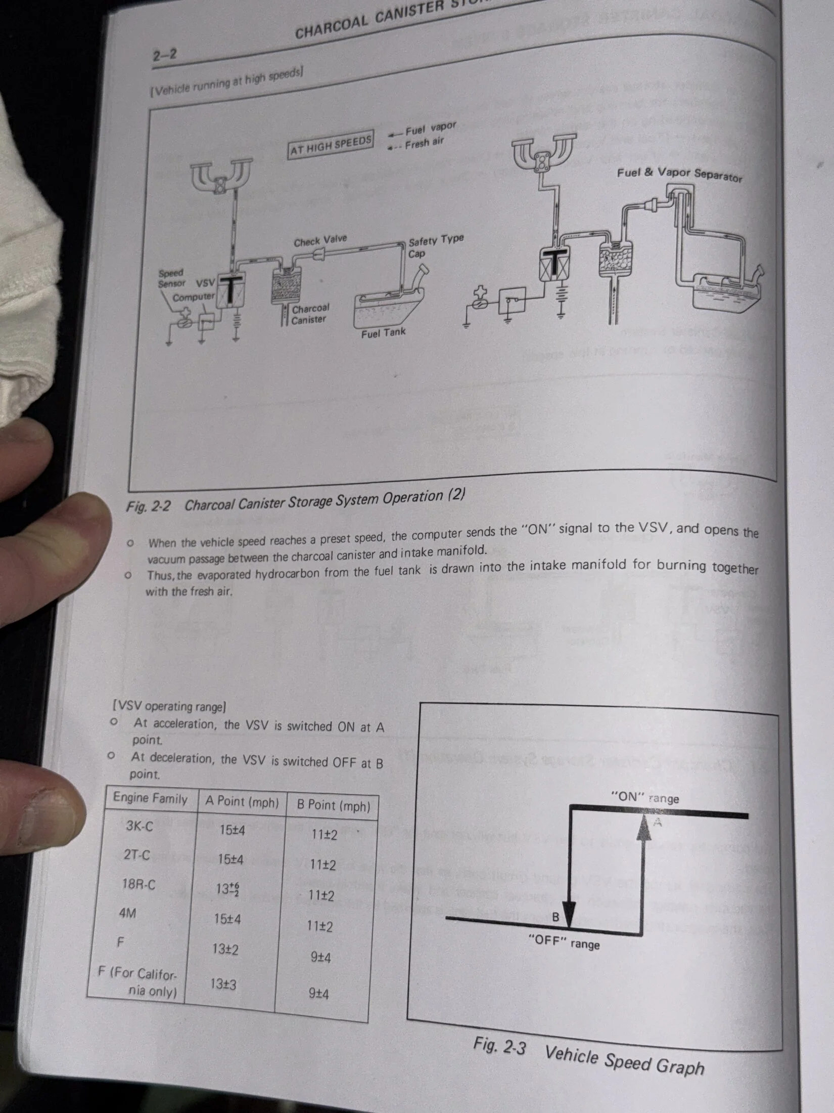

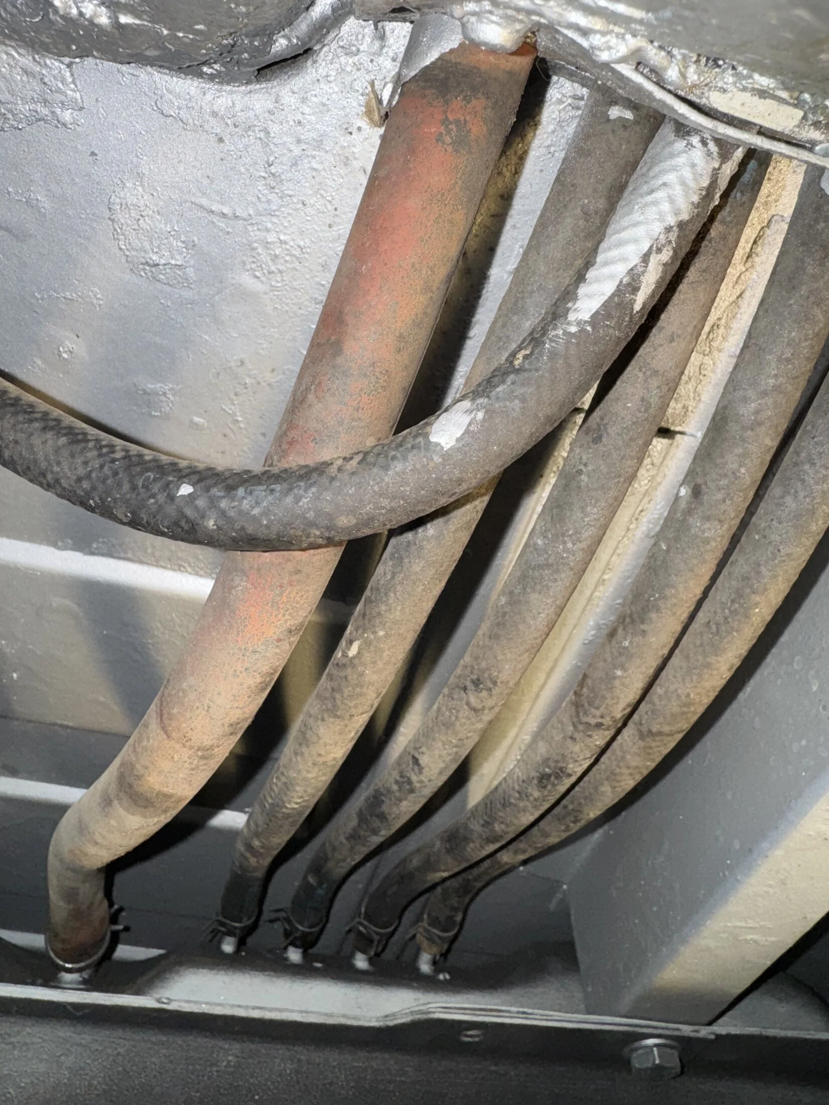

Thought maybe these photos might be beneficial in some way to add to the thread.. going to read through them here and follow some of the inspection procedures..
How many vent lines are coming off the tank?

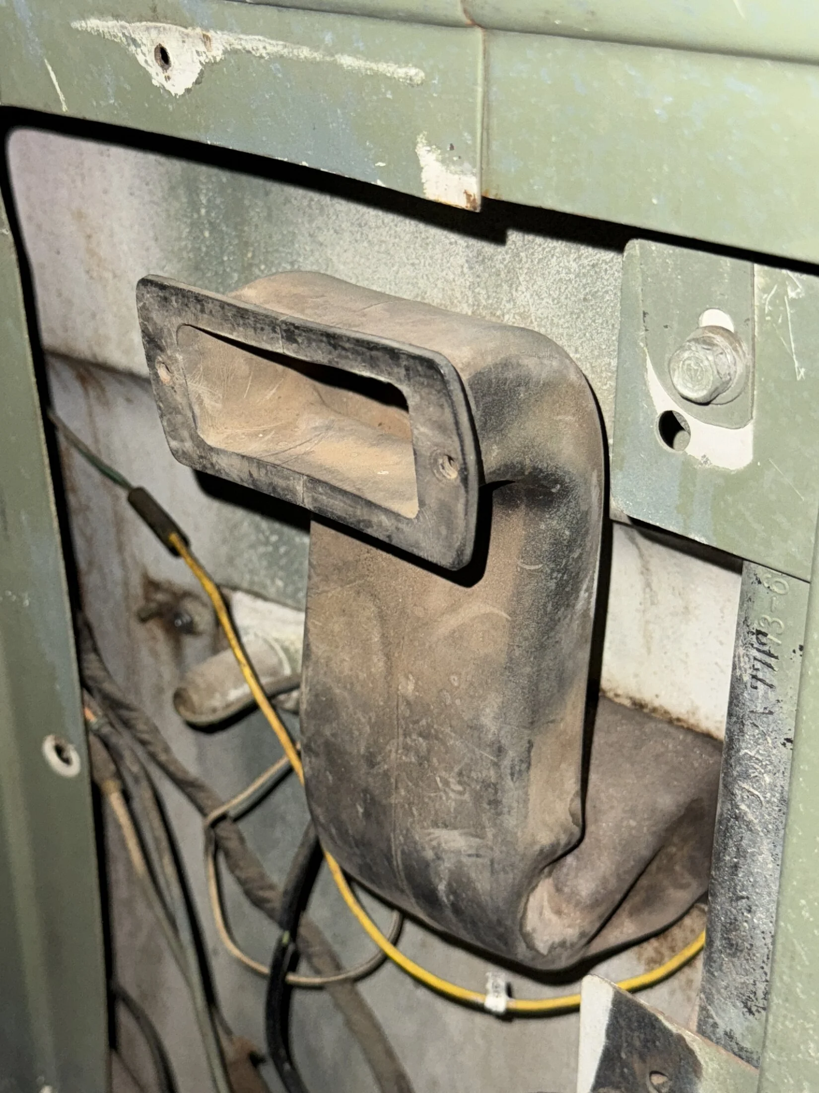

Have you looked behind the driver side cargo area panel to see what the vent plumbing looks like back there?
Just posted a few photos from the 74 emission manual, pretty much what you see in the diagrams. Ill take of the panels and snap some pics here shortly

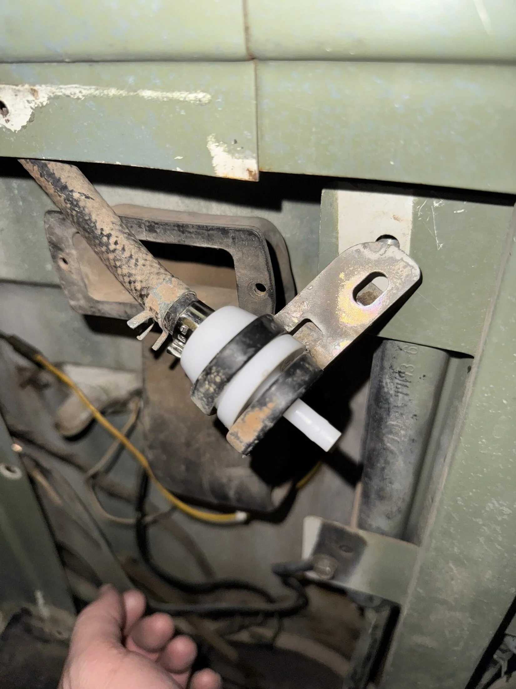

Remove this line at the top of the separator. Cut a piece of hose and attach it to the top and run the other end to the plastic reflector/vent so that the fumes can vent to atmosphere to the outside.
Start up the engine, drive it around, see what it does. This should completely eliminate the possibility of pressure buildup. This is just temporary for testing.
When you say the reflector vent you just mean this bit?
disconnected check valve from the fuel vapor separator
Now youre saying run a line from this tube to the vent?
Yep.
Now start it, go for a short drive see what happens.
Hey @RUSH55 so went for a drive last night, still seems to have had some pressure and gurgling when i opened the fuel cap.
Albeit I don’t know if I was smelling the toxic fumes as much and it ran with no hiccups (still not sure if the pressure in the tank and misfires are related).

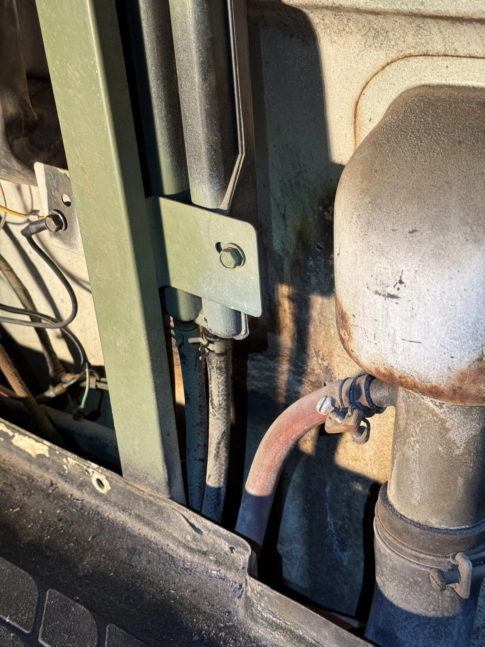

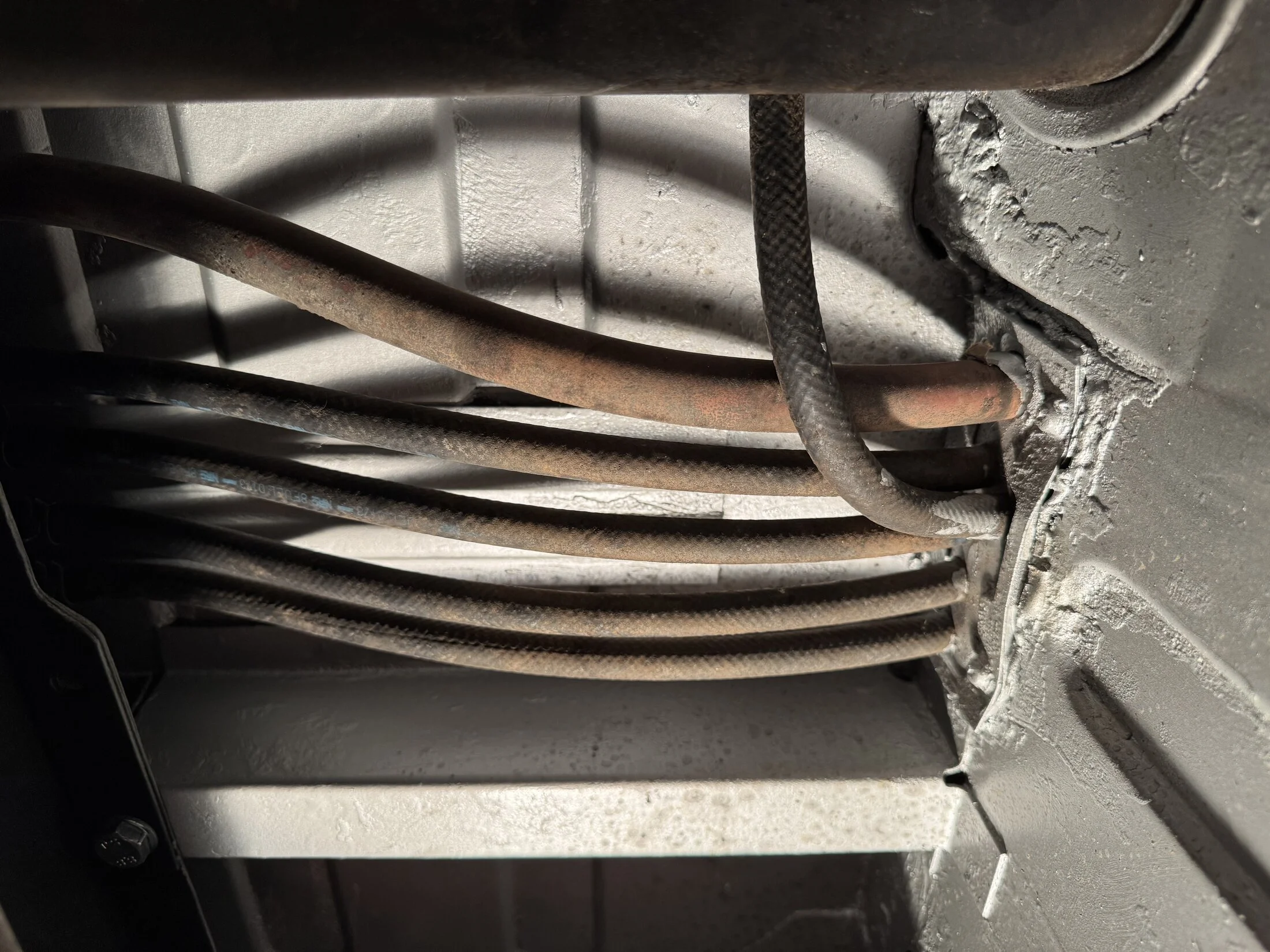

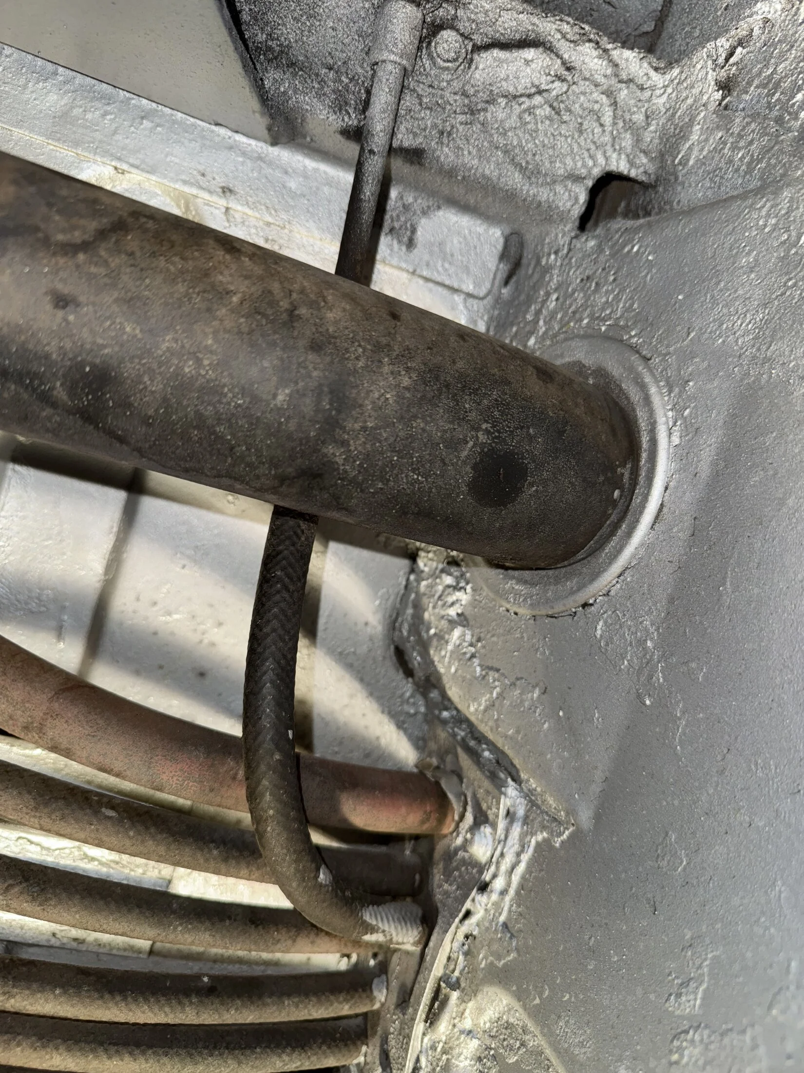

Either way im going to blow some low pressure into the 4 vent ports i see. Adding some more pics of the actual vent hoses from vapor separator to the tank itself.
